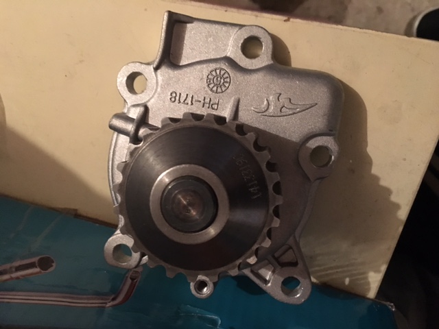

Thanks for highlighting this thread today I've just checked the pump I got from RA September 2016 it's a Airtex AW9220 it shows the rounded corner. My cam belt change is due soon so I'll have to point this out to the garage when they fit it.

this one looks like mine... So interference fit without modification mentioned earlier...
Please dry-fit completely before applying any sealant!

Update - garage fitted the belt kit and pump today, they removed a very small amount from the casing to give more clearance but did say the pump may have fitted without the slight adjustment. MOT pass too :bonk: :bananasex:

My new water pump doesn't fit :evil: Most annoyingly this is the second one I've had, as reported here: viewtopic.php?f=33&t=27129
The problem with this one is also down at the bottom edge where the pump case has to fit behind the bottom inboard timing belt cover (or is it oil pump housing?), there's a slight bit which is proud of the casing which prevents lining the holes up:
I'll contact RockAuto and see if they'll accept a return, otherwise I suppose I'll have to get crafty with a file.

Postby HJ2 » Mon 14.01.2019, 10:00
What is the cost of return?
I would get the angle grinder ready :-)

modification is 1 minute work.
list of tools: workbench, file, common sense. 8)

I filed off the corner of the pump case and on the block too, fits no problem now. Thanks for the nudge ;)

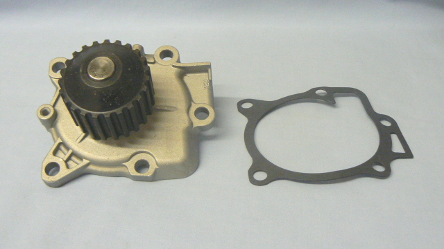

Ive just read through this thread and, in summary what is the best water pump to buy? One that will fit without grinding or fettling.
Im doing the cam belt change so have gotta get all the other bits aswell.
Had a look on Rock auto and theyve only got one cambelt kit for sale atm, the USMW one which is classed as 'economy'.
SJ have all the parts for £256 including idler, tensioner plus alternator and power steering pump belt.
Here is a pic of the water pump they supply, does anyone know if this will fit without modifying it

Postby madbilly » Tue 31.08.2021, 22:04
Hi BertBeck,
I can't tell you which ones won't require fettling but I can tell you the one I bought (see back for the ref) did not need much filing off the corner to get it to fit. Unless you buy one from a Lotus parts specialist there's always a chance it will need some fettling.
I hope that gives you some confidence to got ahead and order.
