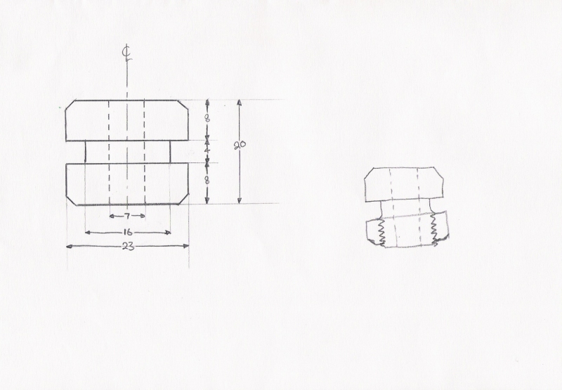

Postby Nige » Mon 28.04.2008, 21:52
Unfortunately it will have to be done properly as the grommit does more than just seal the hole in the bulkhead. It is also how the pedal end of the cable sleeve (outer) is secured as there is an additional sleeve with a stop on the cable end that locates in the hole in the grommit. The actual cable passes through the grommit and has the nylon clip that fastens onto the accelerator pedal attached to it, thus preventing easy removal of the grommit from the cable.
Drawing and dimensions to follow Geoff.

Postby Nige » Mon 28.04.2008, 22:46
Geoff, thanks the PG 9 looks as though it could do the job, if as I think they are a 2 part fastening that screw together. It needs to be fairly solid material though as otherwise it will put give into the accelerator cable, if these are a soft rubber it might not work so well. However, it has to be worth a try.
Dimensioned drawing attached, with sketch alongside of the sort of solution I have in mind, insert male threaded portion through bulkhead hole from engine bay, fasten female part from inside car, probably use silicone sealant to make watertight and to stop the thread working loose.

Postby Nige » Tue 29.04.2008, 07:09
Good thought Doug, I suspect they were fitted as the car was being built when access was not a problem, and a bit of percussion persuasion could be brought to bear.
