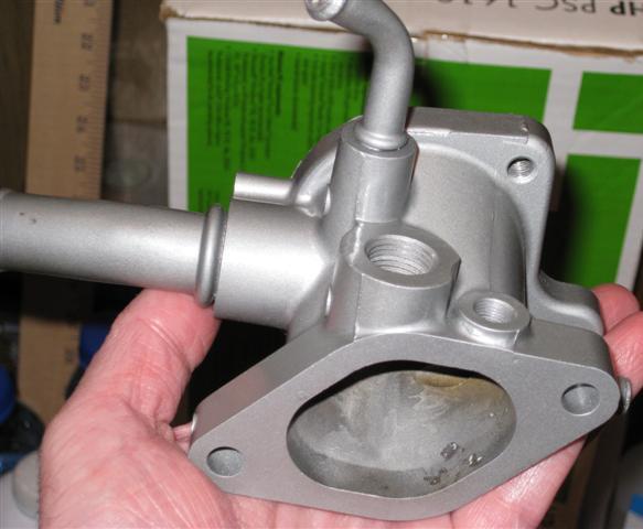

Postby nitroman » Thu 26.02.2009, 07:34
The backside of the thermostat housing has this diamond-shaped mounting face for which I need to order the gasket from Rock Auto.
To amortize the shipping cost does anyone have good ideas about what other items I should consider getting from them at the same time?

Postby nitroman » Tue 31.03.2009, 05:48
donsladek wrote:
nitroman wrote:The backside of the thermostat housing has this diamond-shaped mounting face for which I need to order the gasket from Rock Auto.
Hi, Matt, do you have the part number/manufacturer for this gasket? In changing the thermostat, I snapped the head on one of the bolts, so i've removed the housing for "surgery", and will need a replacement gasket.
Thanks!
http://www.rockauto.com/
FEL-PRO 35452 Coolant Thermostat Gasket $ 1.22
...is how it appears on my invoice. Online it appears as DOHC Turbo engine; Thermostat Housing; Loc. Inner, and now lists at $1.35. 35452 is for the back of the housing where it mates to the big-hunk-of-engine-block. The actual "thermostat gasket" is FEL-PRO Part # 35364 DOHC Turbo engine; Thermostat Housing; Loc. Outer
