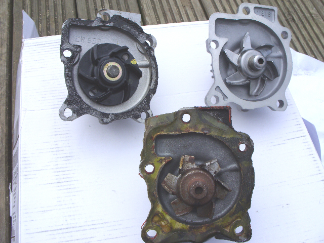

Well, the story gets stranger. The genuine M100 pump arrived today, looks identical to the aftermarket one from the states except plastic impellor blades instead of metal ones.
However, it still doesn't fit. :banghead: It goes into the space, but the metal or plastic impellor blades hit the sides. Additionally, just to make it really strange the bolts don't line up. In fact the original pump bolt holes are about 4mm different.
To make matters worse exactly the same code is stamped on the alloy casing with the M100 and the original pump.
Looking at the at first glance (Lotus or aftermarket compared to the original unit) they look identical (bar the impellor), its only when you use a micrometer that you can start to see the differences between the edges (the new one has a slightly wider body and thinner housing edges) and the bolt holes are slightly different.
I thought Lotus only had one engine for the M100 ??? As the original matches the aftermarket one for size etc. I am assuming that it is the original pump that is the problem. The garage are puzzled. I am puzzled. Any ideas? Help please!
At this point I am sending the original back to Christopher Neil's and hopefully they can recondition the old one.......but Why I ask, how could a genuine one not fit a genuine Lotus engine!

Postby Exbury » Mon 15.09.2008, 14:08
lotus pumps01.jpg (244.41 KiB) Viewed 8944 times

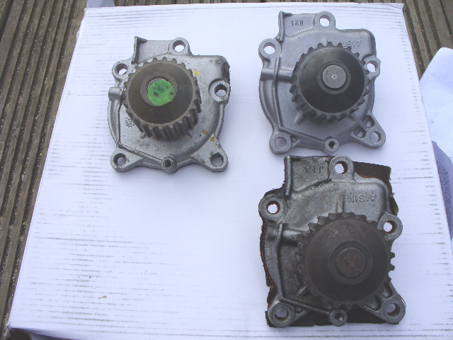

Look identical enough; aftermarket top left, genuine lotus top right and original as from car bottom right. now looking underneath, the same code is stamped on the inside, the outside has the same casting mark. there is a inked mark on the old pump of J15 and on the new pump of H21,
However assumingthe lotus one is correct, how could I have different bolt hole spacings!

Postby Exbury » Mon 15.09.2008, 21:05
It looks similar, i am guessing it is not a Lotus original? The inner stamping is different though and the vanes look to be a different metal, possibly cast?
I am guessing not many people had the 'unusual' water pump....or just haven't found out about it yet! Need to get it in the post to Lotus tomorrow!
I guess it might have been able to make the new one fit if you elongated the mounting holes and cut down the vanes of the pump. Does this mean that the actual engine block was slightly different if the new ones cannot fit? Wonder if they had a different block on the N/A which was carried over into a few SE's until they ran out??

You have got me puzzeled as well, I may have a very small leak from the water pump and was intending to do it in a month or so.
Now you have me wondering which one I have fitted as I have a N/A, I would have thought the engines them selves would have been the same apart from the turbo running lower compression pistons.
I can not see any them making two different engines and I have look at other Isuzu cars that had the engine fitted and can not see a differance in water pumps
Does the parts list show two pumps or one I'll have to dig mine out but I think on other parts when they were changed it shows both part number like up to a certain vin number and from a vin number

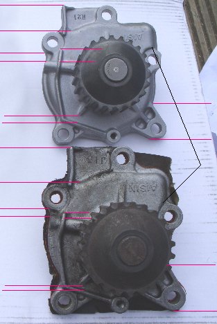

Postby RayD » Fri 19.09.2008, 19:40
With the two castings being different... but having the same casting number, I wonder what the chances are of the newest one being made wrong, by a different manufacturer from scratch.
Being a different casting you’d expect it to have a different number. :?

Postby bobbrown » Fri 19.09.2008, 19:51
in the pictures there is a differance that can be seen, if you take the top picture the middle right bolt face has the outside edge squared off , the one that was on the car has not, not sure if this has been machined off or is cast that way
Also there appears to be a cast in number seen in the lower pictures but I can make out what looks like S1B but can not make out what is under the gasket on the one removed from the car

Postby RayD » Fri 19.09.2008, 21:41
There’s a number of differences, they can’t have come from the same mould.
pump difference.jpg (32.27 KiB) Viewed 8774 times

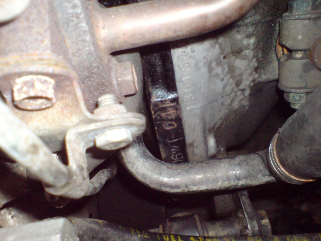

Postby Exbury » Mon 22.09.2008, 21:10
Think I managed to get the engine number with blue-tac, however it is different to that on the V5.
Engine Number looks like: NP7 06WT 041 (the first 3 digits I had to get with Blue-tac), the silver stamped number is on the gearbox casing.
Does this look correct?

Postby Specky » Tue 23.09.2008, 12:00
That looks like just thhe casing No... Not an engine No
I'll have a look at mine...
Re: Did lotus ever build a different Water Pump?
Postby Specky » Tue 23.09.2008, 12:13
The engine No is about there..
Mine is below the metal pipes..(Just)
The location is....
The front of the engine...
Find the split in the cooling hose where it goes to the electric pump...
follow a direct line 45 degrees down from the Y-junction aiming at the engine...
On the engine side of the gearbox there is a machined flat face... It's on there...
I think it's easier for me to locate as I have no turbo on the car I'm looking at...
My No does match the V5
I hope that helps
