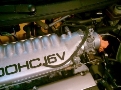

Postby Fourdoorcat » Thu 27.09.2012, 05:34
Well....more progress. With the overflow tank pushed to one side, you can see the vacuum reservoir. Even though the manual says differently, the tubing end I circled in the picture does not go to the vacuum reservoir. The one next to it most definitely does; following the same path John described. Let's face it: the vacuum from the manifold doesn't much care which line is which.
What the manual tells me is that the other line goes to the "second throttle vacuum reservoir". Using my handy dandy inspection camera, I was able (with some difficulty) to find this component on the backside of the engine, below the intake manifold and verified that the two vacuum lies that go into it are present on the component itself. This means that the connection to the manifold gets picked up someplace else.
I'm out of time tonight. Perhaps I can beg John to see where the other line goes and report back. This is the one that is about a foot long. Even with the knowledge I now have, I still don't know where the fitting is located. Next course of action (unless someone can tell me where it is) is to try and follow the hoses from the second throttle vacuum reservoir. One goes to the second throttle vacuum solenoid valve; that's not the one I want. All of this is easy to say but, as everyone knows, it's not easy to find your way around back there.

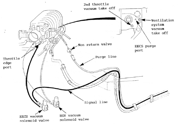

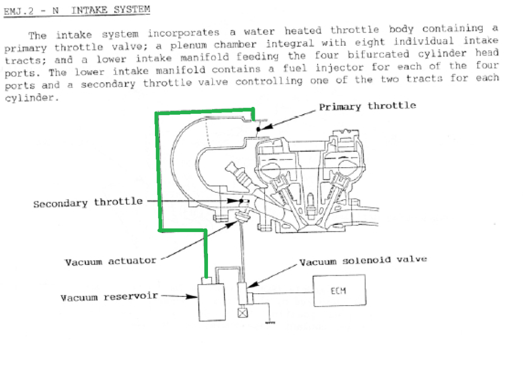

If you haven't downloaded the full compliment of manuals, it's worth doing so. Here are a couple of diagrams from the closed-loop manual:
Vacuum secondary components and routing
Given the length of the tubing, it seems like it must either feed the EGR or secondary system. Hopefully the diagrams will help.

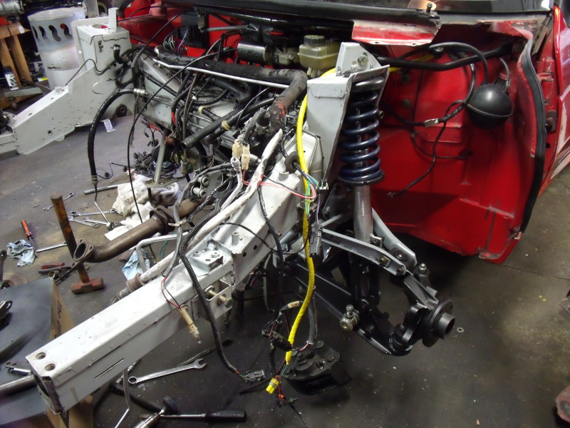

Postby dapinky » Thu 27.09.2012, 08:40
I appreciate that the Fed version may well have different bits than the Uk version, but here is a pic of my engine bay whilst i was swapping out the vacuum lines during an engine swap. I can't remember exactly what went where (it was a number of years ago), but the new lines are blue and there are still some of the original black ones in the picture.
It may be of no use at all, or it may show you the routing of some of the pipes you need to look for.....

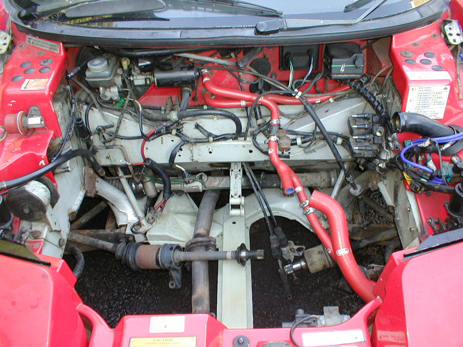

Postby Mike_H » Thu 27.09.2012, 10:03
I think that vacuum pipe goes to the vacuum reservoir positioned on the inside of the wing .
I hope these two pictures help.

Postby Fourdoorcat » Thu 27.09.2012, 15:12
I determined that this disconnected line has nothing to do with the vacuum reservoir for the climate control system. So that is ruled out.
This image applies; the highlighted tube is the path that appears to be open.
The vacuum reservoir for the secondary throttle is well hidden in the back of the engine. However, I was able to determine that the two vacuum hoses shown in the diagram are attached. Apparently, there is an inline connection someplace that accepts the hose which starts at the intake manifold and travels about 12". This is what the unconnected hose looks like:
My problem is I cannot determine where the hose connects.
