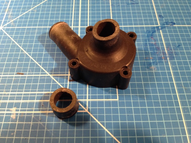

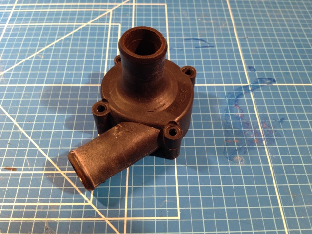

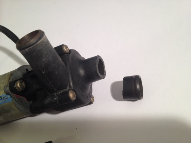

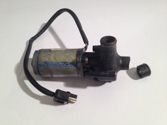

The plastic part of my electric water pump broke, where one of the hoses is attached. I think the pump is still ok and as you all know, a replacement is very expensive. So I am looking for just the plastic part. Maybe somebody has replaced his electric pump and still has the old one? Would appreciate some help very much! Thanks, Ron.

I've just swapped mine for a c class one. The motor and seal are knackered, but the casing is good. Where are you located?

Its worth connecting the wires directly to a battery and make sure its working, not easy to know for sure when its on the car as its very quiet running but in your hand you can feel it whirring.

You could glue the part back on with a good quality epoxy.
Let it cure in an oven so end strength will be higher then when you let it cure in ambient conditions. That will save you some pennies as well

Is this the sort of part that lends itself to 3D printing?
Posts: 2416
Re: Electric Water Pump
Postby HJ2 » Mon 11.05.2015, 10:22
It is very much so :D

The solution to the plug was to chop the lead off the old pump and attach some connectors on the end to make a fly lead - I'll take a picture. (The new pump has the plug built into the end of the pump rather than a lead and the loom won't reach)

So I cut the cable off the old pump, soldered it to the space connectors and put some shrink insulator around them. The picture of the pump on ebay shows which terminal is positive and which is negative. My new pump didn't have those markings. I took a flyer and wired it the same as the picture. Applied 12 volts to it and observed which way the pump went and it seemed to go in the right direction. Fitted it, ran the engine until the fans came on the turned off the engine. Happy days - the reassuring hum of the pump could be heard so job done :D
