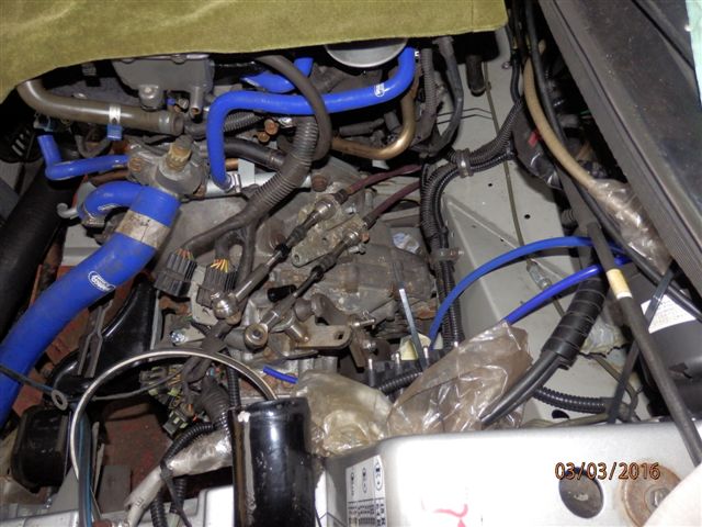

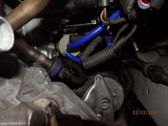

Postby cliff » Thu 03.03.2016, 11:45
Hi Brian,
this picture clearly shows the reservoir and throttle mechanism.
I just had a look and you can see it from the left hand side of the car. I have all of the intake ducting, water pipes and expansion tank off at the moment but it does look as if you should be able to get your hand in there and push it back on. Might be useful to have a younger son/daughter to assist.
Going to be fiddly so good luck.

Postby hodge » Thu 03.03.2016, 14:01
Nice pics there, Ciff, of a usually very hard to see area. :smt023
The second photo has somehow ended up on it's side during the process of posting tho.
If you or someone could turn it 90 degrees left, it would correct it and help with the necessary visualisation required as the the OP fumbles around with their right hand, eyes closed trying to remember that image and what goes where.

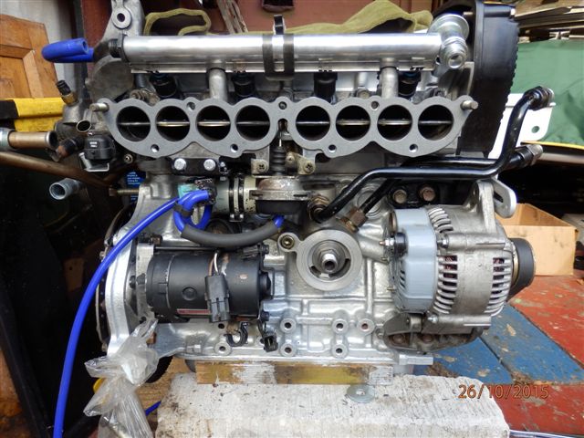

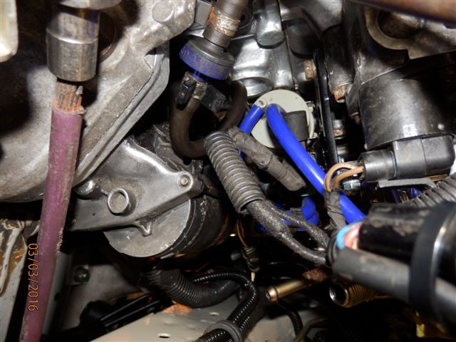

Postby cliff » Thu 03.03.2016, 16:08
Maybe this one is a bit clearer, can orientate from the rear bulkhead.
For info, my engine bay is like this at the moment.

Postby hodge » Thu 03.03.2016, 17:29
cliff wrote:Maybe this one is a bit clearer, can orientate from the rear bulkhead.
:smt023
