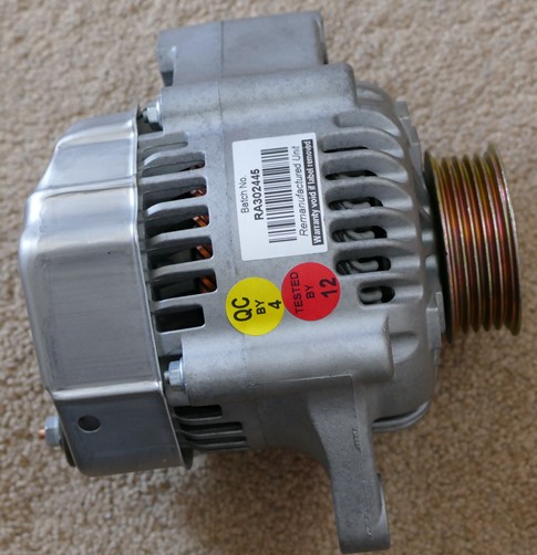

Postby KenS » Fri 05.07.2019, 14:53
I purchased an alternator from SJ at the end of May, I have not fitted it yet, and now realise it also has the wrong pulley - for a 5 rib belt (whereas the car has a 4 rib belt). Spoke to SJ today, he say its OK, just fit the 4 rib belt, let it run in 4 of the 5 grooves. He has assured me that it is OK and the electrical connections will be correct. But he is happy for me to return it for a refund if I wish. Picture of the new alternator attached.
Has anyone fitted the exact same alternator and confirm it is OK in terms of pulley fit, pulley diameter and electrical functioning?

Postby lotusflasherman » Fri 05.07.2019, 16:57
KenS wrote:I purchased an alternator from SJ at the end of May, I have not fitted it yet, and now realise it also has the wrong pulley - for a 5 rib belt (whereas the car has a 4 rib belt). Spoke to SJ today, he say its OK, just fit the 4 rib belt, let it run in 4 of the 5 grooves. He has assured me that it is OK and the electrical connections will be correct. But he is happy for me to return it for a refund if I wish. Picture of the new alternator attached.
Nope, but if you have your old alternator check that 4 of the 5 grooves measures exactly the same across as the 4 grooves of the old alternator, check the angle of the 'V' and the depth of the 'V' ... if they look the same the belt will not be deformed so I'd agree with him, but if any are different, sent it back for sure. If you do use it, I suggest use the 4 grooves closest to the alternator just to give the bearings a slightly easier life - unless the belt looks to be out of line like that..

Re: SJ Alternator Fitting
Postby KenS » Fri 05.07.2019, 22:33
Hi Andy, there is only about another inch of outward adjustment on the original alternators mount, so the bigger pulley is going to take it very close to the end stop - maybe needing a longer belt, also, the larger pulley will slow the alternator down which all seems a bit odd.
