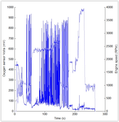

I'm not an expert with EScan but I looked at your data.
I noticed you have code 44 - lean - but your air to fuel ratio of 8.1 shouts 'RICH'. I don't understand this...
You have 400 000 faults? :shock:
There's 0 spark advance - it ought to be around 16 - so I reckon timing/CAS needs attention
I overlaid my O2 sensor EScan on yours and noticed that your sensor takes a while to warm up and seems to 'drop out' at times so I wonder if it's getting a full 'voltage'; does your ignition light flicker whilst it's running? The sensor gets 'voltage' when this is 'off' whilst the engine is running...
Since you're new to EScan you might not know what the numbers ought to be so I'm sending you a short scan I took recently to check my own air:fuel ratio (my sensor de-pinned recently and I wanted to make sure that it was still pinned). EScan lets you overlay your results on mine, which is running okay, so you can see how different yours are.

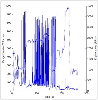

Hi Xavier T. Here's your current EScan O2 sensor pic.
Glad to know you found the RHFHC problem, but looking at your EScan pic it seems your O2 sensor has 'struggled' then failed again - even quicker than the last time :(
I wonder if your sensor multiplug fell apart again - or possibly could your O2 sensor have 'died' as a seperate issue?
Spark advance seems sorted though. Let's see if others can add any comments...

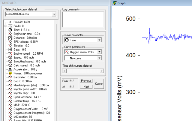

Postby Xavier T » Sun 20.10.2024, 17:55
Hi everybody
Thanks a lot for all your good advices.
To answer to Chrism and to Tuga2112, the alternator warning light come on when i flick the key then go off after engine starts.
I have doner a new scan considering what RonR said ; i have unplugged the O2 sensor then run the car.
Youu can see the new scan ( when you talk about the "Oxygen Sensor Volts" graph i can't find it under the popup menu "curve parameters" I have CO potentiometer/Oxygen sensor and Oxygen sensor integrator.

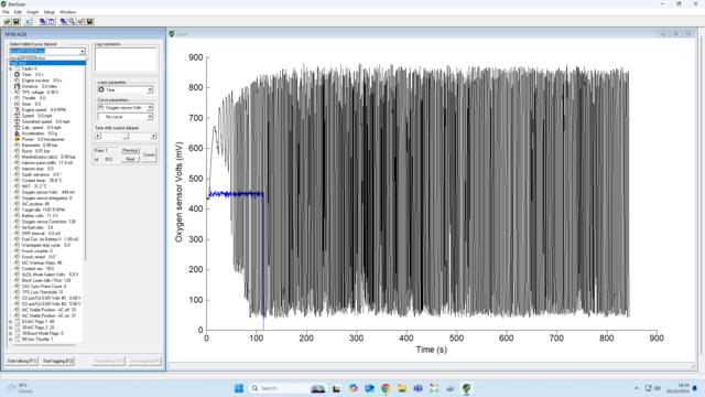

Postby chrism » Sun 20.10.2024, 19:22
Hi Xavier T. Yes you should get a red light when you turn to position1 - and if the red light goes out after position2, when the engine has started and is idling, then everything seems normal to me. When the red light goes out this means there will be enough voltage from your regulator to supply the O2 sensor- and you can see the 450mV at your ecu that Ron pointed out earlier. :)
I've got your scan reading of your oxygen sensor:- Yours is blue and I've overlaid mine in black with the sensor connected for you to compare:-
Ron wanted to see if your ecu provides a voltage with the oxygen sensor disconnected and you can see that your blue voltage stays steady at ~450mV as Ron predicted. My black sensor varies, correctly I think, with the O2 sensor connected...
I haven't a disconnected scan of my own to compare yours to but I suspect it would be exactly the same as yours.
You have the ecu voltage that Ron pointed out so my first thoughts are - if not another faulty O2 sensor itself that you said you'd substituted - then one of the 3 leads isn't 'healthy'. This is what Ron said earlier?... I think the black is an earth and this might be the one I'd check first (vaguely...)
Interested to see what others say...
ps here's a close up of your disconnected O2 sensor voltage details in case you didn't see this option:-

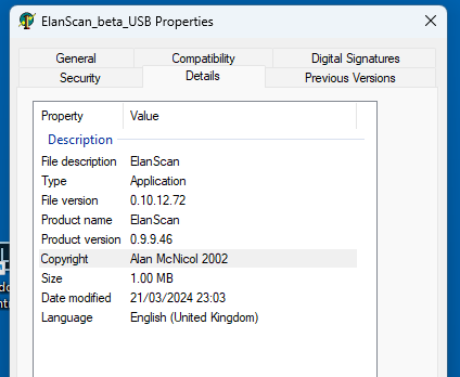

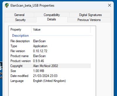

I don' t know which ElanScan version you have but mine has "CO potentiometer/Oxygen sensor" instead of "Oxygen sensor Volt" (on the photo on the left under "MAT"
Capture d’écran 2024-10-20 21.06.26.zip
(60.3 KiB) Downloaded 100 times
Xavier T
Posts: 42
Joined: Thu 08.12.2005, 15:37
Location: france, nancy
Re: error 44 misfiring
Postby chrism » Sun 20.10.2024, 21:57
This is my version. And yes I can see the problem from your screenshot.
I'm wondering if/how I can send a link to you?
I've sent you my version of the EScan_beta zip file by email (I think :?)
