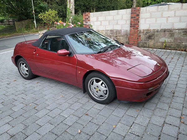

Hi all.
Any advice gratefully received.
Some time ago my Elan suddenly decided not to rev or generate any power - it was similar to a modern car running on 'get you home' mode.
Had the injectors checked and found one not working. Changed them and the coil packs at same time.
Then the engine pulled very well after about 3500 revs but very badly below - very lumpy running, misfiring and no power below 3500 revs.
Was advised possibly hall sensor so had that changed at a garage. But no change in running.
The garage did say it was showing fault code 41 - and possibly throttle sensor issue. Which is usually associated with hall sensor.
They are now advising replacing the entire CAS with a new one. But its a pretty pricey part - so before I did that I thought I'd ask if anyone had any thoughts?
Or I could wait until a Lotus specialist near me (PNM Lotus) has an opening - but that might take some months....
Cheers.
