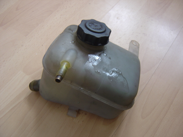

Hi,
I'm in the process of changing my coils and have removed the expansion tank to make things easier. I decided to clean the tank, but has anyone got any ideas on how to remove what appears to be 14yrs worth of sludge?
Leaving boiling or soapy water to soak in doesn't seem to have any impact.
Anyone done this before?

Postby Doug » Sat 26.11.2005, 04:01
uh, I know what you mean, but I have also tried various solutions and have decided the only way to get the look of a new tank is to purchase a new one . . .

Postby Doc Fizzix » Sat 26.11.2005, 05:35
I used a Preston radiator cleaner (takes out rust and corrosion)
Worked great! Cleaned out the overflow tank crud

Postby John_W » Sat 26.11.2005, 14:45
I just persevered with detergent, bottle brushes and any cleaning sponge/scourer which you can stuff in, shake about and get back out. It took about an hour but all the grot came off. (With the tank in the sink of course, not in the car.)

Postby ianh » Sun 27.11.2005, 22:09
I've just replaced mine as it was coated with sludge, and the difference is very noticeable.
It's only when the old one was out of the car and side by side with the new one that I realised how discoloured it was - not just the deposits, but the entire plastic was discoloured beyond recovery.
I got the official Lotus part from Paul Matty (£21+VAT), and then kicked myself on opening the packaging to find it's a GM part.........so you're already quids in by spotting this up front!
All in all, I think it was worth it rather than spending hours on the old one that would never look like new again.

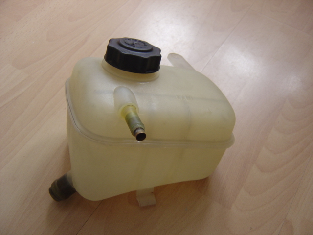

Postby Gazza » Mon 21.04.2008, 13:59
I have cleaned my expansion tank and I'm pleased with the results.
Just left it overnight in Milton sterilizer and then used a metal clothes hanger with a piece of material attached to the end to clean it out.

Postby Monty » Mon 21.04.2008, 16:35
Bloody hell Gazza, yours was quite bad :shock: but thats come up like new :smt023

Postby Rodman » Mon 21.04.2008, 21:05
The coating on the tank is basically rust. As already mentioned, cleans up easy with bleach, domestic cleaner. Make sure you have flushed the tank well before you put it back. Did mine some time ago. The dishwasher didn't work (don't tell the wife) next wash smelt funny blammed it on a blocked drain :) .
