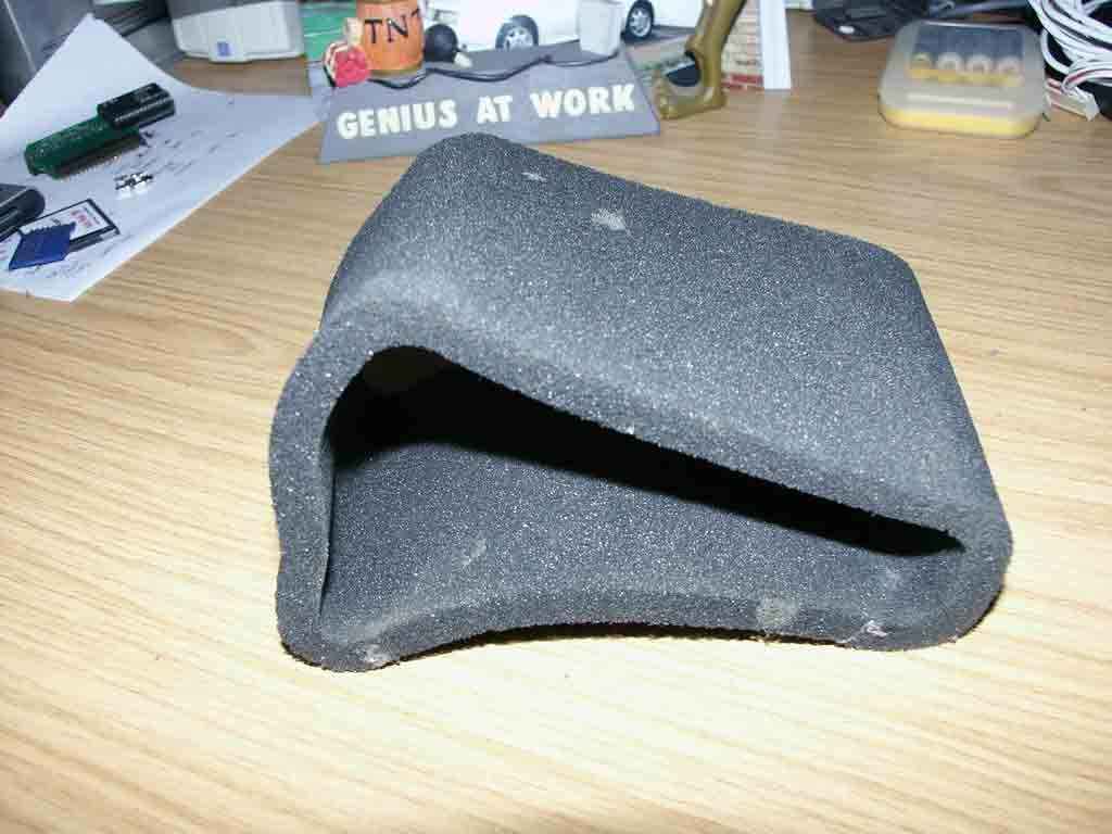

Postby lotuska » Mon 03.03.2008, 19:09
Nothing more than a way to connect the 2 bits together, well designed to live just under the drain hole for your windscreen so when it fails water enters the heater system and you'll never be able to demist your car.
New one looks like:
new foam bit
(55.7 KiB) Downloaded 93 times

Postby dans » Mon 03.03.2008, 21:07
I might not bother then!!!
Seems to work perfectly well without it!!! :?
