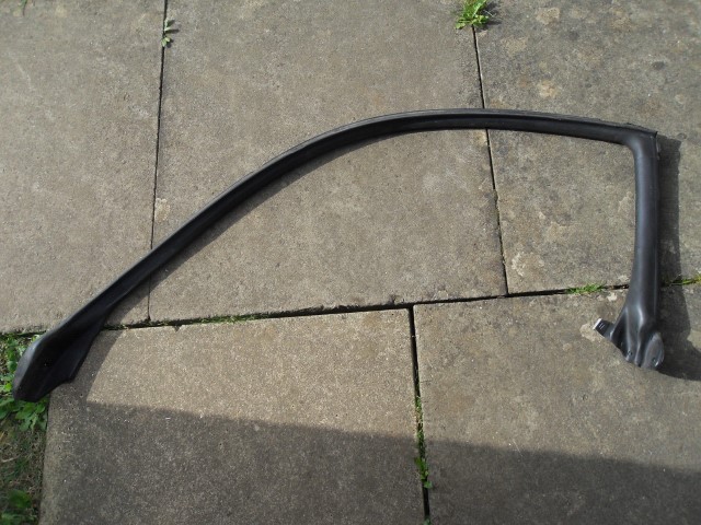

I can't remember the last time I went to a scrappy that had Japanese cars in it, come to think of it, the main one I used had a separate branch for Jap cars and I believe is no longer in business. Fleabay might be an answer though, at the right price...
Is this the seal you're talking about from thre MR2?

Yep that's the MR2 seal Ian, you only want the bracket it sits in though, the rubber when cut open varies too much in thickness and has other webbing inside which makes it a hassle to use, the Mondeo rubber is perfect for the End caps and the edge part of the Falling seal.
