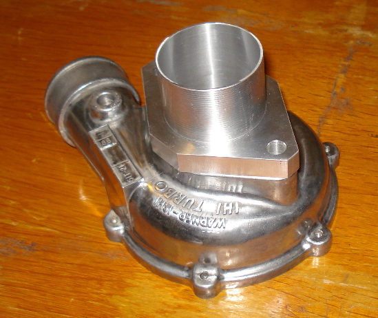

Can anyone tell me the numbers to look for on the Thunderbird IHI snail to indicate which is the larger compressor wheel? ( I understand some had the same as the Isuzu -250cfm later models were larger at 370 cfm ) I have a line on a Turbo but the only numbers the guy can give me are 51T-21. He 'says' it was from an 88 Thunderbird, but i 'say' i'm going to be on time too!

It may be mentioned somewhere in the old Doc Fizzix "hot to trot" rebuild thread. Here's a link to the post where he begins discussion of the Tbird turbo. In this photo from the thread, I read 51T-21:
but Doc also appeared to do some messing around swapping compressor and housing from the tbird turbo onto the elan's center cartridge and impeller. The thread is helpful and also has links to Robie the robot's isuzu turbo page.
