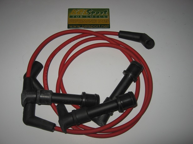

Rambo wrote:OEM plug leads were in red. At least, otn his side of the Atlantic
From memory the OEM's were NipponDenso, as per the alternator
Correct ... and still red, not grey.
