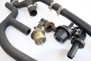

Here's the cause of my persistent drip - the hose joint I suspected (which was, indeed, quite 'crabby' when I pulled it apart) and the Volvo 760 plastic heater control replacement.
I think I could have saved ~£70 on the hose, but whilst improving the heater control (£22 from eBay) it seemed rude not to go the whole hog and improve upon that awful 32year-old poorly-designed hose set-up which does away with that silly joint.

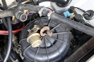

Postby chrism » Mon 09.01.2023, 12:28
(I think I might have cracked the image posting process so's I can now include the pics of the problem:)
The suspected heater control/hose connection seemed to be weeping coolant onto the hose which ran down to the clips and then dropped off onto clean newspaper under the engine - confusing me as to the whereabouts of source of the leak.
As I twisted the off hose to investigate all sorts of rust-related nightmares unfolded :( .
I replaced the original metal heater control with a plastic Volvo unit and the crazily-designed Lotus hose with a new (ouchly...expensive) one-piece part.
It fitted perfectly and I replaced the coolant with new. All-good now :) and one breakdown risk neutralised, I hope.
(Perhaps I could've got away without replacing the hose so expensively but do we do that? :-))
