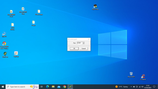

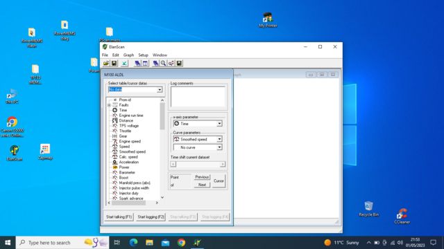

Postby chrism » Mon 01.05.2023, 23:34
TrevorB I use my win10 laptop in the car (it's not 'bling' enough to update to win11) and then use a USB dongle to transfer 'Scan data to the win 11 PC indoors. (nb I made sure 'Scan was a fresh install on the win11 PC after it updated)
The l/top starts up Elanscan in 'COMM1' and I have to choose 'COMM8' then press OK to get the second screen. (I think if you just press OK and don't choose a COMM you'll go straight to the second screen where you can get the same option from the Setup box to choose the 'correct' COMM number...)
But perhaps you're you're not even getting either of these screens to begin with, using the win11 upgrade?
If that's the case I'd uninstall Elanscan, switch off, restart then reinstall it knowing that win11 should download the right drivers (w/out knowing differently I'm assuming that your current drivers were originally downloaded in win10 before the win11 upgrade and might be causing problems?)
ps just a thought; is the lead plugged firmly into the car? (I've fallen foul of this a couple of times :?)

File - Save as
Save in – Desktop (or wherever you choose)
File name: Merlot ddmmyy run1 etc
Locate file in on desktop, zip it, post it on LEC
the file doesn't exist until you have saved it.
Return to Engine
