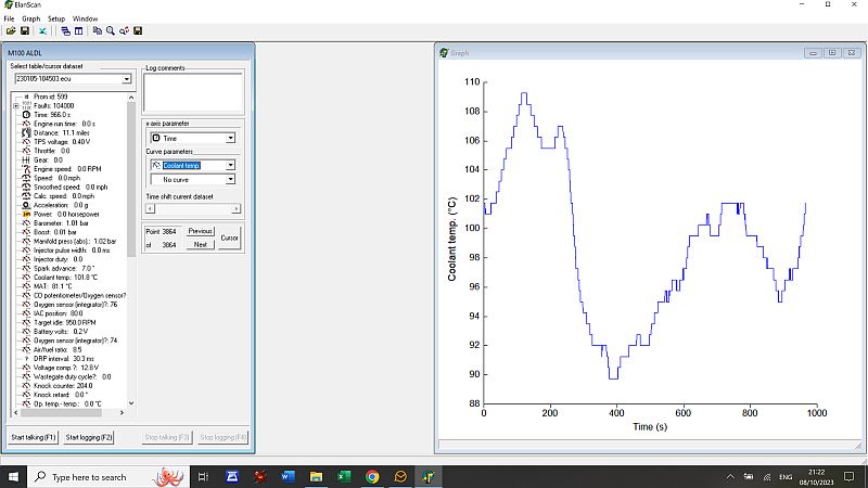

Hi perel. I've just replaced my CTS in the ongoing battle to solve an issue only occurring under track conditions. The elanscan graph that led me to do it was this one
Which as you can see simply plots Temp against time - this one covers a 5 lap track session. The advice I've had is that once warm/hot the engine temp should stableise and stay within a few degrees no matter how hard the car is working (assuming not stopped in traffic etc.). My graph clearly shows it actually cooling significantly from the initial high from some time into the second lap - most odd! However I've not yet had time to capture a post CTS replacement graph so don't know if its now behaving differently to this or much the same.

I'd be very interested to see the graph from MPX with his new CTS fitted. On track, a full throttle blast down the straight will generate a lot of heat in the head so CTS will then read high, braking and part throttle will allow it to reduce, then high again for blast down the next straight. The graph covers 1000 seconds so 16 mins 40 seconds and range approaching 110°C doesn't surprise me - that's why the system is pressurised, to elevate boiling point ... 15 psi elevates it to 125°C. You get more power at higher temperature, particularly with cold air, which is more dense. Variation for 110° to 90° is within my expected range. BTW I run on an Everest chip and a diesel Astra thermostat which opens about 5°higher than the OE 'stat.

lotusflasherman wrote:On track, a full throttle blast down the straight will generate a lot of heat in the head so CTS will then read high, braking and part throttle will allow it to reduce, then high again for blast down the next straight. The graph covers 1000 seconds so 16 mins 40 seconds and range approaching 110°C doesn't surprise me - that's why the system is pressurised, to elevate boiling point ... 15 psi elevates it to 125°C. You get more power at higher temperature, particularly with cold air, which is more dense. Variation for 110° to 90° is within my expected range.
And thanks again and very much chimes with Joao's expected variation as he told me on the Castle Combe thread. On the other hand...That graph isn't going up and down between corners and straights. Its slightly under a 100s lap for me if I'm trying - clearly not when I'm coasting if its gone bang - but anyway the temp warms up over the first lap or two then drops like a stone for a couple of laps then reverses again so these are more than whole lap swings. The symptoms start on about lap 4 and terminal on 5 and 6. Also very recent advice from Phil Webb at SWLC was that once the car is properly warm and thermostat open then temp should be stable and vary by very few degrees no matter how hard its used (obvs excluding traffic issues etc - and there weren't any!).
