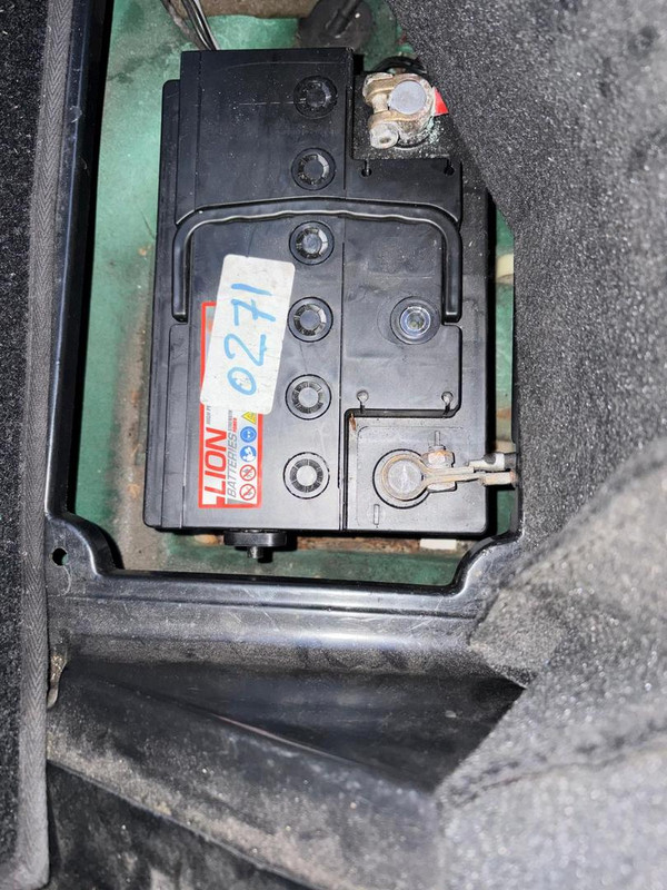

Postby NoahR » Fri 23.01.2026, 13:30
Lovely, thank you for the info ChrisM.
I remember having a look at the battery the other week. I got access to it rather easily, but I couldn't figure out how to loosen the nut connecting the negative battery terminal to the battery. None of my sockets or spanners had enough clearance to actually get on the nut itself. I'll have a longer play with it this time though.
NoahR

Re: File Review Request
Postby NoahR » Fri 23.01.2026, 18:19
Hi all,
Super quick update from just now;
Made sure the green cable was plugged in - it was. Hard to access haha!
The battery volts with the car off were 12.28, with the car on they steadily rose from about 12.56 through 12.71 and kept going up slowly, with the car on and headlights on, they were 11.84.
Any advice on removing the negative battery terminal nut? I can't get a socket in that location (I could buy and try a super low-profile socket, but not convinced it would work), and I can't get either end of a spanner on there as the nut is just too shallow to get a bite on. Tried vice grips as well. - Picture:
Finally, good news RE the smoke, it didn't smoke in the 5 mins or so I had it running, so perhaps further confirmation that that was just the power steering fluid burning off, and that instead this has just maybe uncovered a general issue, one occurring before the closed loop conversion??
Will crack on with the other bits tomorrow.
Postby chrism » Fri 23.01.2026, 18:38
So this is your original m100 battery that seems to mirror your dash voltmeter readings, then.
Sluggish, but something seems to be getting through from the regulator then? I think I'd try that different battery idea, now.
Can't remember seeing a green cable on mine? And that nut couldn't be more awkwardly aligned. Spraying with pen oil, leaving it to soak for 1/2hr and tapping it with a sharp screwdriver or punch...?

Postby NoahR » Fri 23.01.2026, 18:44
chrism wrote:So this is your original m100 battery that seems to mirror your dash voltmeter readings, then.
Yep.
Yep, for sure. Job for tomorrow.
The actual cable is encased in a black covering, but the connector into the alternator is green.
Ah thats a good shout! I've done that before on other bolts, but that didn't come to mind here

Postby NoahR » Sat 24.01.2026, 17:00
Successful update!
Started by changing the fuel filter today, which in the process required me to remove the battery (pen oil and a screwdriver worked to get the nut off - thanks for the other suggestions though).
That all went well, and when I turned the car on, lo and behold, the voltmeter was reading 14v! Could this have just been caused by a loose connection to the battery, which was fixed when I removed and reinstalled it? While obvious in hindsight, because of the issues actually getting the terminals off, it's not something I tried.

Postby chrism » Sat 24.01.2026, 17:36
That's really good news :D :D. I think I'd clean up and 'vaseline' the battery terminals too, while you're on a roll...
Hmm...could the non-charging merely be down to corrosion of the battery terminals causing high resistance etc etc?
