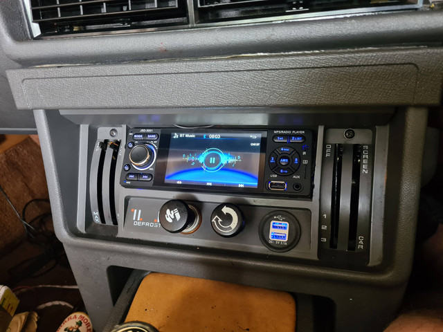

are you 100% set on getting a radio with a screen ? or are you open to other alternatives ?
I Have thought about the same for a while, and i have a flip up screen on my Celica which i know for a fact wont fit in the M100 adequately.
Its a shame you didnt go to Castle Combe. Tony showed me hes setup. which was effectively a phone holder on the radio. and looked rather nice
I have also designed something on the same idea but using a Dash blank instead.
the video is the first prototipe. but you can get an general idea of the goal.
and this other video is the instalation as it stands which i dont think i will be updating any further.
With a radio that automagically connects to the phone via bluetooth i find this to be more than adequate for my use.

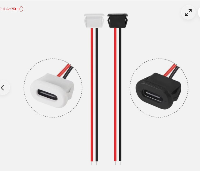

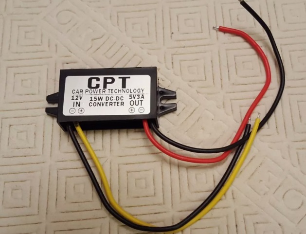

Tuga I have seen the radio you are talking about and agree with you that Bluetooth from phone is good, I’m also looking at doing USB ports, but wand something very neat, so looking at USB C port.
This is what I have at the moment:
The port
The Power reducer
Although this one is 15w I’m trying to find a 25W to work with more modern phones as they will need more power to run and stay charged.

All done for the slow charger, I will be fitting a fast charge USB C
to the door side of the dash at some point.
This one is permanent live so I can put my phone on charge when I am at a show or camping so I don't need to have the ignition on.
The fast charge will be through the ignition.
