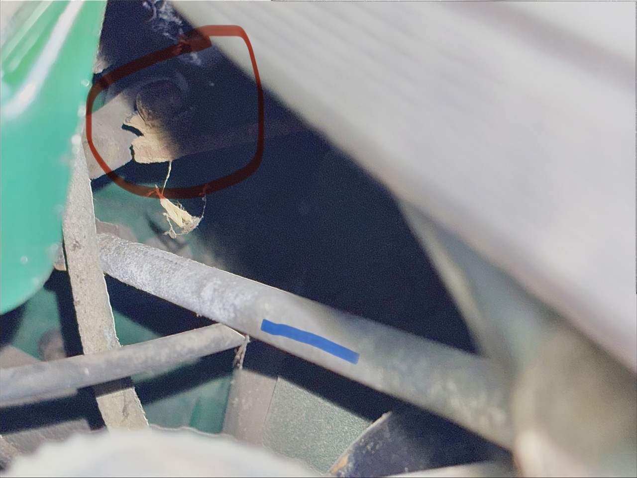

Postby NoahR » Thu 19.03.2026, 21:33
Hi all, very minor update:
You can see where it's come apart here
Image.

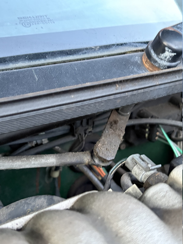

The grey strut with a blue mark should be attached to the ball joint circled in red. You can see it attached to the passenger side Image
Need to work out what parts I need. - SJ sports sells some bits, but hoping I don't need the full assembly as thats quite pricey. The RAC man strongly recommended replacing both the ball and socket side, as otherwise, one side would wear the other one away over a few months.
Access also looks like a massive pain. - Although, perhaps if the ball and socket go together easily, I won't need to get my hands in there. Otherwise, I might be able to get it from the wheel arch with the liner removed. The final option would be to remove some of the body panels, haha.
