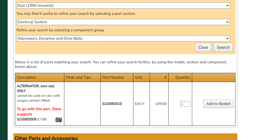

I've just looked at the SJS site and they seem to be advising that their alternators/regulators don't support O2 sensors.

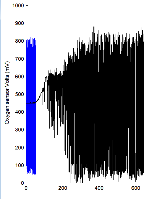

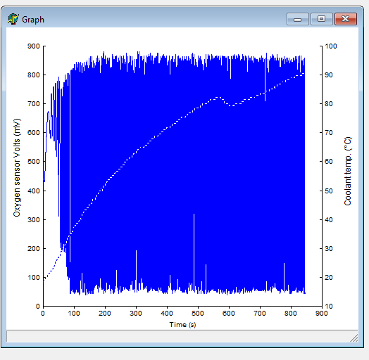

Apologies for skewing the original post, but there's a very strong connection here - the likes of which I wish I knew when I was '1499-ing' my '90 SE a couple of years ago (and folks are still queuing up to take advantage of RonR's excellent dual chip upgrades)
I re-installed my old (on-the-shelf) 13ohm Denso sensor and took a stationary-from-cold EScan to find that it maintained the a:f ratio at 14.7:1 from when it 'sparked up' properly around 90s after start-up :D, showing a regular scope pattern. So I'm leaving it in...
Incidently, when I first took it out I thought it was trashed and washed it in paint thinners, brushed it, sprayed it with carb cleaner and did all those things that doom laden, sharp-intake-of-breath people say that you shouldn't do...and it still works okay :)
I hope this helps aspiring SE->1499 upgraders to vastly improve their fuel cons and emissions figures. (Imo it'd be useful if the resistance of these items could be marked on the packaging!)

...trying not to cause confusion but hoping that 1499-upgraders from SE (aren't you doing a video of this?) don't show the same naivety as me in assuming that all lower-resistance O2 sensors are 'better' and that a 13ohm sensor is not 'broken' wrt a 2.5ohm sensor. 'Highers' might heat up a little slower, but work just as well in spite of a 90s warm-up (as I attempted to show)...
When upgrading to 1499 we have to 'grab what's going' sensor-wise (their resistance is not labelled) and bearing in mind RonRs spread of wattage, plus having had a blown 3A fuse in a fuel-related VSV circuit (due to prev owner 'improvements' before I 1499'd it), then perhaps we ought to be aware of not overtaxing the alternator since its output is needed (certainly for SE->1499 upgrade) to control our fuelling in the way you mentioned earlier in the thread.
ps I don't know if S2 O2 sensors work in the same way but it might be relevant, too. I hope someone will inform us 'don't knows'. If they have a different current supply then that'd be of interest to SE upgraders?
Sorry, not intending to confuse; just hoping to gain and spread some insight :(

RonR visited yesterday and with the aid of a newly installed Elan Scan to my windows11 laptop was able to diagnose some other issues related to my conversion to 'closed loop'. Ron completed some tests with O2 sensor plugged in and came to the conclusion that the wiring was not in place. He did think this unusual as Merlot is a late 1992 SE version which he thought should have had the wiring in place.
Any thoughts on that would be appreciated.
Does anyone have any pictures or diagrams, information on the wiring required. There were some indication that some wiring is present, I'm sure RonR will expand on this. Obviously it needs sorting at some stage.
Back to the alternator. Dave Pink, did you require a longer drive belt when you installed the Rock Auto alternator? I'm thinking this will be a better route than taking out existing, dismantling, replacing regulator and then putting back.
RonR did a thorough check of all the data collected after taking Merlot for a run with Kilimanjaro chip configured for 'open loop' and she passed with flying colours.
Thanks everyone for your invaluable help. :clap:
