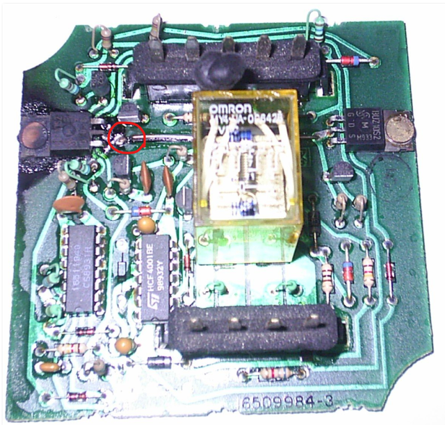

Because of their scarcity and propensity to burn out, RonR, KenS, tuga and others had an interesting conversation at Castle Combe about updating the lift module pcb with something like a microcontroller and some modern MOSFETs, possibly with current sensing rather than the fixed ON timing as is currently. I just wanted to get a few things down before we fly off to Newcastle then Alicante then Santander then Alicante then drive back to Bristol in June.
Basic operation is that the direction relay is controlled by the coil drive to the dipped beam relay (+12V -> UP, 0V -> DOWN) and the +ve or -ve edge of the feed to the dipped beam headlight triggers a timer which activates the MOSFETs.
Having tried unsuccessfully to repair the charred mess that Pinky gave me on Saturday and thought about it a bit more, I think I am going to do some preventative maintenance and change both the BUZ10 MOSFETs in my working lift module with low Rds ones. My rational is that I'd like to protect the module rather than something going wrong and dissipating 20W which could potentially toast the board and make it irrecoverable,

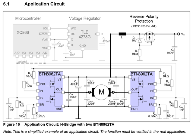

A good starting point might be an automotive half bridge driver with current sensing…

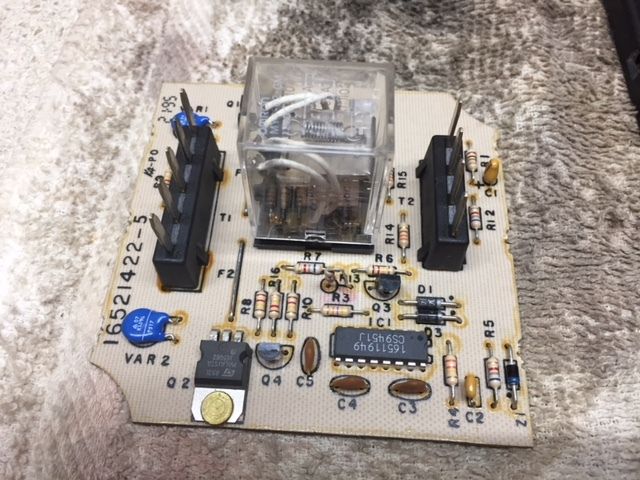

Thanks Nick but I've had one since 2006 according to the photos!

Judging by the gap in the 'fuse' (I thought it was a current sense resistor but it appears to be solder!!!) and state of the pcb in my picture, it only blows far too late.
