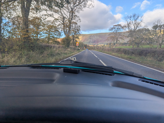

Postby stevie-a » Sat 25.10.2025, 15:02
Well today I fitted this
Works great

Postby stevie-a » Sun 26.10.2025, 10:00
I got it from E-Bay for £10.59.
Just watch most of them have green numbers, even though adverts show white, I purchased two and adds showed white but it was green, best thing to do is ask seller first.
in the contact seller I said this:
"You might think this is a silly question but I have purchased two of these from other sellers and when they came the display was green even though the advertised was white. Could you tell me is this defiantly white?"
most will say "sorry it is green"
But I got his is the one and as they said it was white
https://www.ebay.co.uk/itm/357166955229

Postby dapinky » Sun 26.10.2025, 10:58
I've got one of these in the garage, which I bought for my trip(s) down to Gambia....... the Km readout on the dash is pretty poor, and when the Moroccan Old Bill like to hand out speeding tickets to foreigners who just want to pay and drive on, it makes life far easier when it is just in your field of view when driving.
I did notice that it wasn't great in very bright sunlight (which is a disadvantage when you are driving down Africa!) - but no issues at all in the UK. Mine came with a piece of plastic film which you can stick to the windscreen to improve the viewing contrast, so maybe that would have helped, but it got lost somewhere during the packing of the car, so I never got to try it.
I found it was pretty accurate, and ran about 2km lower than Google on the phone when driving at 60Km/h - so better than the dashboard on the Freelander - and much better than an Elan!!!

Postby stevie-a » Sun 26.10.2025, 16:23
dapinky wrote:. Mine came with a piece of plastic film which you can stick to the windscreen to improve the viewing contrast, so maybe that would have helped, but it got lost somewhere during the packing of the car, so I never got to try it.
Yeah i have the piece of plastic film, but have not tried it yet,
dapinky wrote: I found it was pretty accurate, and ran about 2km lower than Google on the phone when driving at 60Km/h - so better than the dashboard on the Freelander - and much better than an Elan!!!
Again this runs about the same 2mph lower than Google, better that the M100 spedo that is out 9 mph out at 70mph
