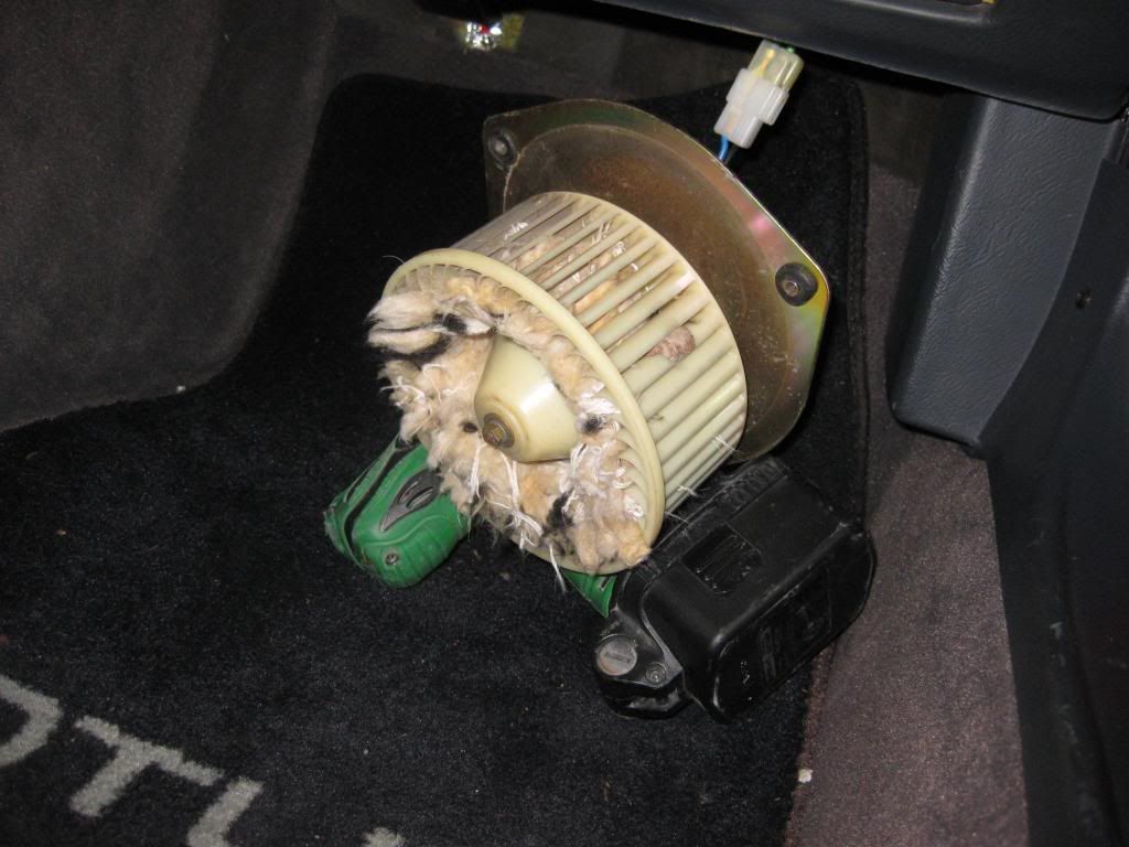

Postby steve matthews » Mon 22.04.2013, 00:17
Well well well, took the car out today but needed a little blower air.
No air but lots of dust and debri. :?
Mouse alright took the 3 bolts down and the squirrel cage looked like this :twisted:
steve matthews
Posts: 1076
Joined: Mon 06.11.2006, 22:16
Location: VIRGINIA
Re: Heater- Noisy and hot electrics smell.
Postby Rusty Wishbone » Mon 22.04.2013, 08:52
steve matthews wrote:and the squirrel cage looked like this :
It looks more like a hamster wheel to me!

Postby steve matthews » Mon 22.04.2013, 12:44
Looks like the wheel got the better of a hamster :lol:
Now works just peachy.
Need to pull wheel arch liner and check for an entry point.
Steve
