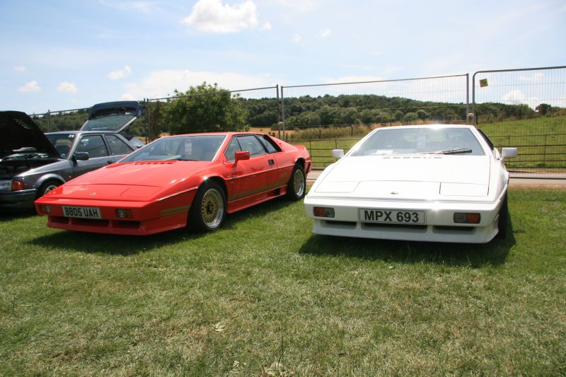

Postby Bern » Sun 21.07.2019, 21:18
I saw your Esprit at Sherbourne, the number plate gave it away!
A lot of cars, plenty of Esprits and Elises, but the only Elan I saw was a +2. Mine was in the car park, I didn't want to wait until 4pm before leaving.

Postby MPx » Sun 21.07.2019, 22:58
Yeah a good show after the sun came out Bern but nevertheless I was keen to leave before 4 so may adopt your strategy next time. Shame there were no M100s but 4 G-Esprits is a significant turn out for a regional show - not seen that for a while. The one I parked next to looked to be in lovely condition.
