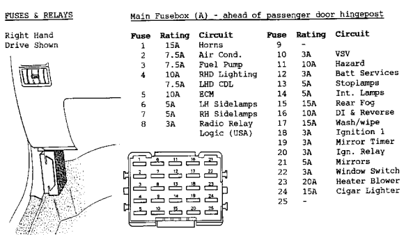

ECM fuse is the top right fuse (number 5) in the passenger footwhell fuse compartment.
if your on facebook. i can post a screenshot of the manual there.
putting images in here is a bit of a faff.

Thanks Joao - not on any socials - various car fora are as close as I get. But Chris has done the deed so thanks very much Chris. I don't think I've got any excuse now - fuse 5 will be pulled and replaced before my next run.

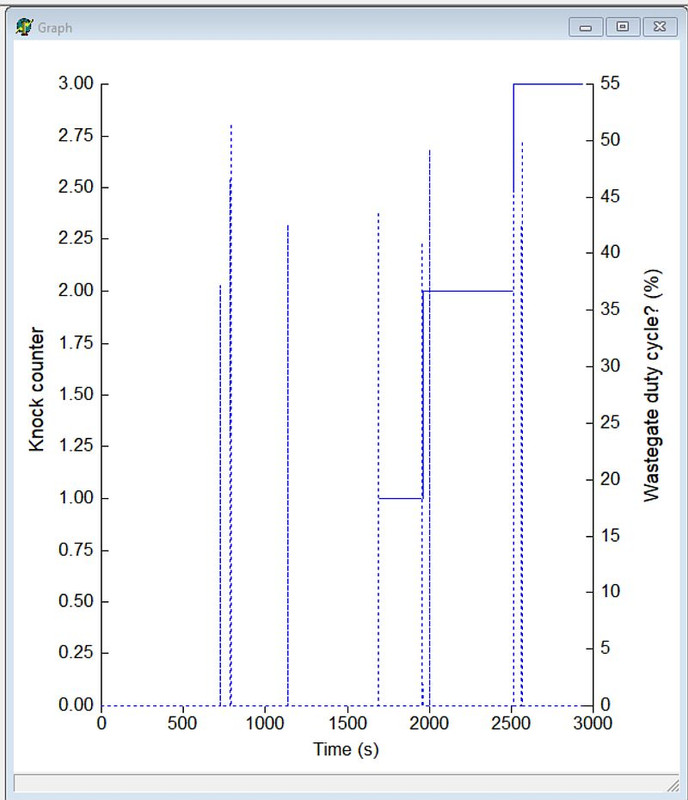

Had a run down to Exter today to the "Sanctioned" car event there. Elan behaved perfectly both ways as normal.
Before seeting off, I did pull/replace the 10amp fuse from pos 5 which I hope did the ECU reset. But I don't know where it was flagged as an error. I see the promID on both recent logs (before and after fuse pull) was 699.
Over the circa 50 min trip I see I got just 3 knocks - but again no retards recorded.
I did look at the knocks vs Wastegate duty cycle as per Ron's previous spot. Again it shows a close-ish correlation - but also more cycles without knocks than with.
Also had a look at Knocks vs MAP and RPM as Ron suggested but both graphs were a bot too busy to tell very much at all with just 3 knocks vs continuous data. Looking back at the previous trip with more knocks - it was also a bit busy, but to my eye the knocks were more obviously recorded when RPM increased very rapidly. Trouble is there were plenty of similar rises with no knocks so way off conclusive of anything.
Anyway, as I said - the car was perfect and very fast for the public road today so really I haven't got a problem have I ?? Well we'll see next May at Combe!
