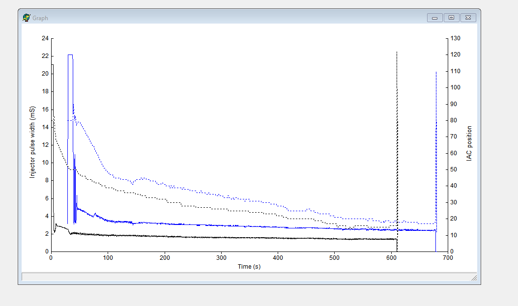

Still perusing...I noticed a difference in injector pulse width vs O2 sensor volts between a Chas scan (above) and a recent scan of my own - healthy, I think - m100 (below) and I'm wondering if the Chas lower pulse width might be significant?

Postby KenS » Wed 16.09.2026, 15:47
Yes, I think the Chas injector pulse widths do look a bit unusual.
My thoughts which are more for discussion since I may not have a true picture of how the ECU behaves and am learning as we go along!
The Chas plot initially has injector pulse widths around 3ms, reference plots are nearer 2 to 2.5. Then when the Chas O2 sensor voltage dies (or goes lean at 140sec) the pulse width has dropped slightly but still relatively high, still not far off 3ms. If it has gone lean, the ECU should have increased the pulse width even higher but it hasn't. The O2 Sensor Integrator implies the the ECU knows the mixture has progressively got leaner, but has not increased the injector pulse width. Maybe the ECU has a limit on the max pulse width allowed for the conditions at that time in the warm-up.
So if the ECU is commanding a relatively high pulse width but still not getting enough fuel in, I think it must mean that either the fuel pressure is too low or multiple fuel injectors are not opening as expected or there is too much air getting in (air leak or IAC). So still lots of possible contenders! We know normally the system has enough authority to achieve good working O2 sensor voltages with one completely dead fuel injector, so a fuel injector issue seems low on the list. Chas has run checks on the fuel pressure/delivery with nothing showing. Also, at idle I wouldn't think the fuel demand should be too high. That leaves too much air. How does the ECU monitor the volume of air? The MAT and MAP data plots do not look unusual. Chas has run smoke test with no evidence of a leak. Leaves the IAC ? But I cannot think of a plot check or test that could help this along. I guess a failed ECU is also a contender, but since the plots seem to have some clues in them I think that is low on the list. Again any comments or discussion.

Postby chrism » Wed 16.09.2026, 18:35
Also a comparison of injector pulse width vs IAC position:-
shows a difference. Chas' in blue and mine in black...
