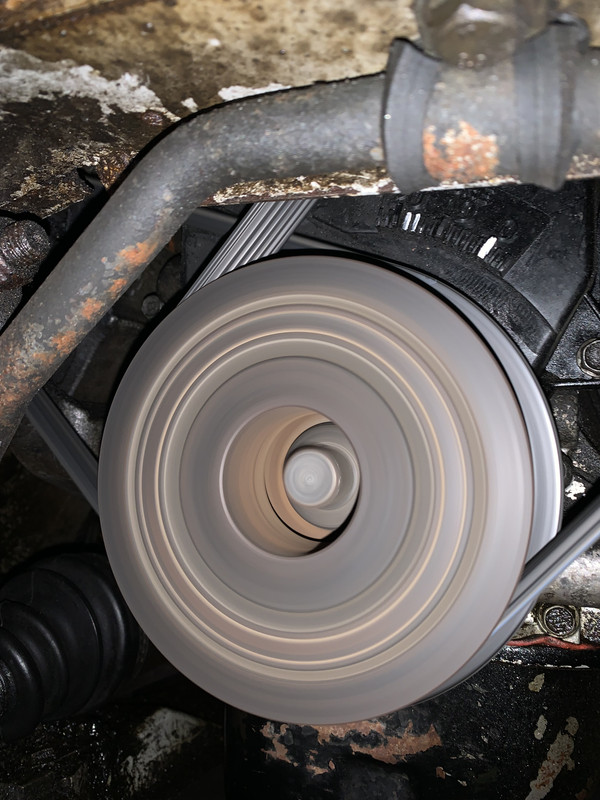

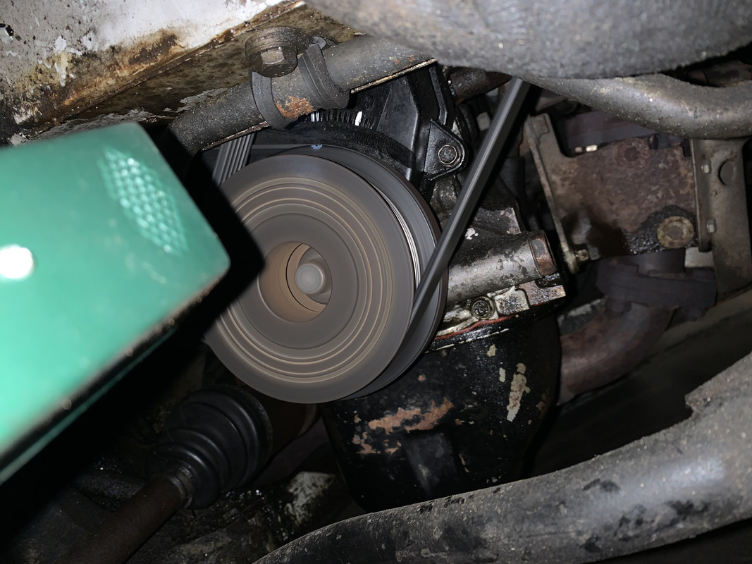

Many thanks for the ideas/suggestions so far. This morning I tackled the base timing as best I could - followed the WikiLEC sheet - so thanks for whoever put that up. Its not mentioned, but I decided to also take the wheel arch cover out as I couldn't really see the timing marks properly otherwise. Being billy no mates, I couldn't quite do it as Joao suggested but it wasn't too hard to do it on my own. But I've not done my own mechanicals for many years and no longer relish it, so well out of my comfort zone this morning. I reckon its the best part of 40 years since I last wielded my timing light!
Some interesting finds - not least of which was that it was not set at 16 degrees. Anyone got any ideas why there would be a very clear white mark (and only the one white mark) at 0 degrees? That someone felt they needed to mark TDC, but not 16 degrees - seems odd? Anyway, I tried to mark 16 degrees but found it hard to get at and rather ham fistedly marked both the 16 and 18 markers with some white. But at least I knew I wanted the right hand one! I also marked the nick as that was very difficult to see - as you can tell from the photo taken before I marked it.
So this is how it was set
You can only just about see a slight mark on the pully and its between 6 and 8 degrees.
And this is how it was set when I'd finished
I'd set my switcher to program 1 for the stock S2 program while I was working on it. I then went for a 15 min drive and all seemed well at moderate road speeds. Then switched back to pragram 6 (Everest) and did another 20 mins. Slowish due to traffic but gave it full beans up a long hill and it boosted to 0.9 and felt very strong. All good, but prooves nothing as it would have done the same before I'd started. But at least it showed I hadn't messed anything else up.
FWIW I'm not (yet) convinced by this. I know Iain (RIP) had to set his timing way off Lotus Spec to get his to run at its best and SWLC have done so much to the car in trying to eliminate misfires they may have reasons for it to be set at 6/8 degrees. But I'll certainly be asking Phil about the TDC marker and if they would have set it "wrong" on purpose for any specific reason. Obvs it could have moved off on its own anyway - it doesn't do many miles, but the vast majority it does do are well above 3000revs so it is worked and if they do "go off", I guess mine would just like any other.

The reason that the TDC is often marked is because a "professional" timing light has a dial on it which you select the number of degrees you require, and the machine flashes the strobe at the right time to hit the TDC mark.
The reason being, that on some cars it is easy to mark TDC, but not necessarily the number you want..... or even have a scale fitted.
As the scale is on aplastic moulding, it may or may not be exactly in the right place anyway..... but finding an accurate TDC is easy by whipping out spark plug #1 and using a dial gauge to see when the piston is at the top of its travel (or even just drop a pencil into the hole and watch it!).
With the piston at TDC, you can then put a mark onto any (easily seen) part of the pulley and a corresponding pointer on the block..... then just dial in 16degrees BTDC into the strobe light and watch the marks line up at the right time.

Ahhh. Thanks Dave. So the likelihood is I've just undone some professionally sorted timing by lining up on the plastic marks. Oh dear! Will be interesting to see what the next scan has to say.

Not necessarily, Mike... It may be just the particular angle that the marks are viewed from..... where you see it lining up with one, if you move your head round the wheel it may look different.
Any mechanic will set things up in the way that works for them at the time.... only time will tell if what you've done has improved things or not.... The easiest way to judge timing is to see how many (or how frequent) the 'knock' sensor has to make an adjustment on Elanscan.
In previous times I have just used a bit of deserted road and timed my acceleration between 50-80 in 4th gear and adjusted the timing until it was the 'best' without running awfully..... and that is where mine is still set to (I'm no expert!).

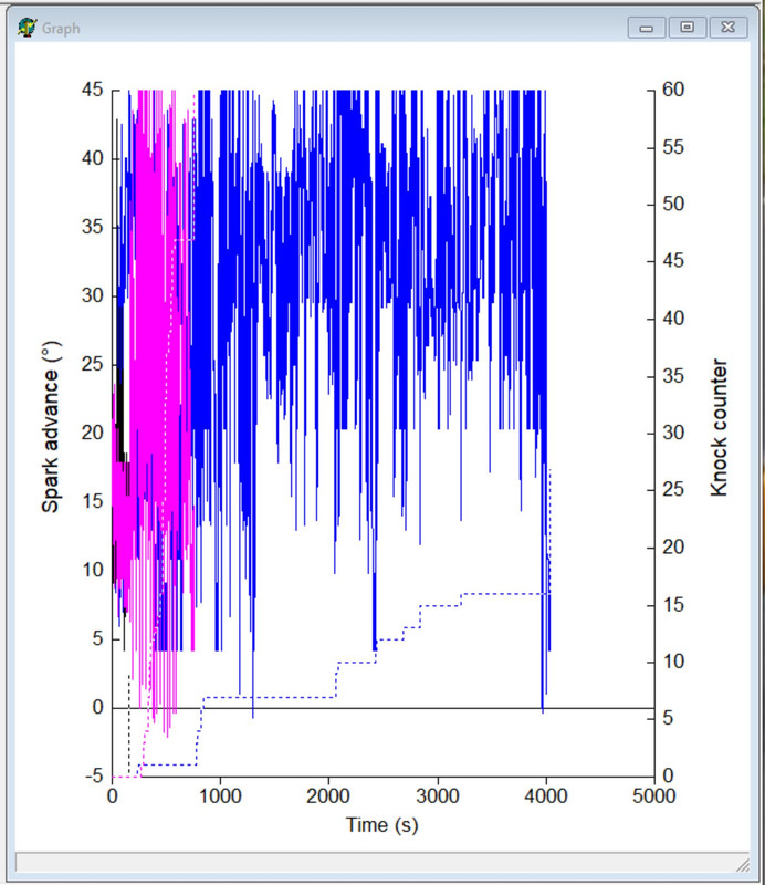

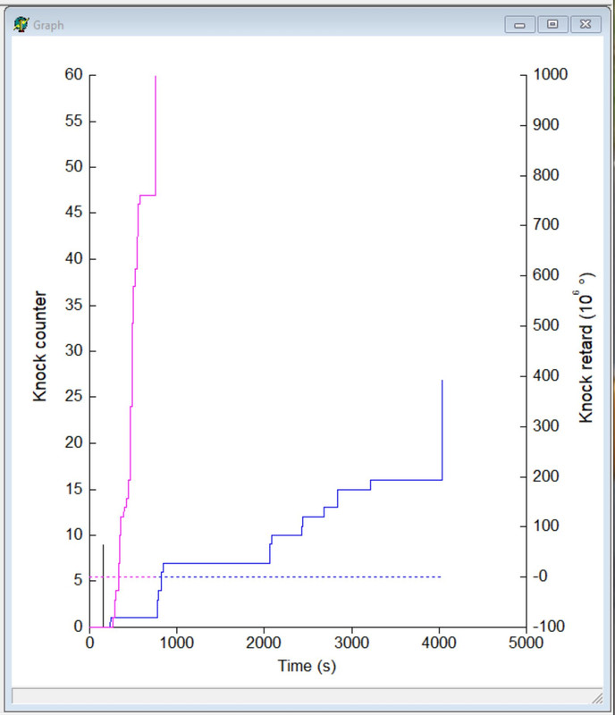

Many, and particularly Simon, were very keen on me checking the base timing (again!) because of the knock count on track. So I checked and thought I needed to change it. Its now set different to how it was and is perfect on the marks, but are the marks right? This is the knock count graph - the pink is the track session the blue the trip to SWLC after the timing change. I guess its better to have less knocks in over and hour on the road than in 10 mins on track...but I'm still getting knocks. Interesting to me that its not recording any retards to any of the knocks. Any further thoughts on this aspect??
So I looked at the advance graph to see if that showed any retard but its a bit too busy to tell really.

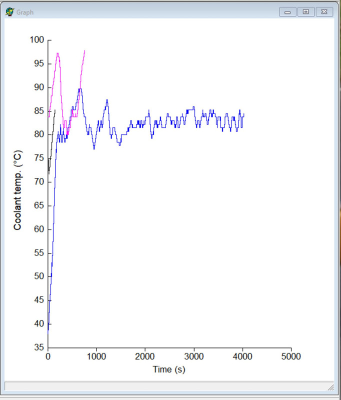

And just for completeness on an earlier theme....looking at coolant temp suggests all is well in that department now
If anyone has the time, I'd be very grateful if anything else in the scan stands out. I'm guessing I wont get any real progress on this until Combe next year!

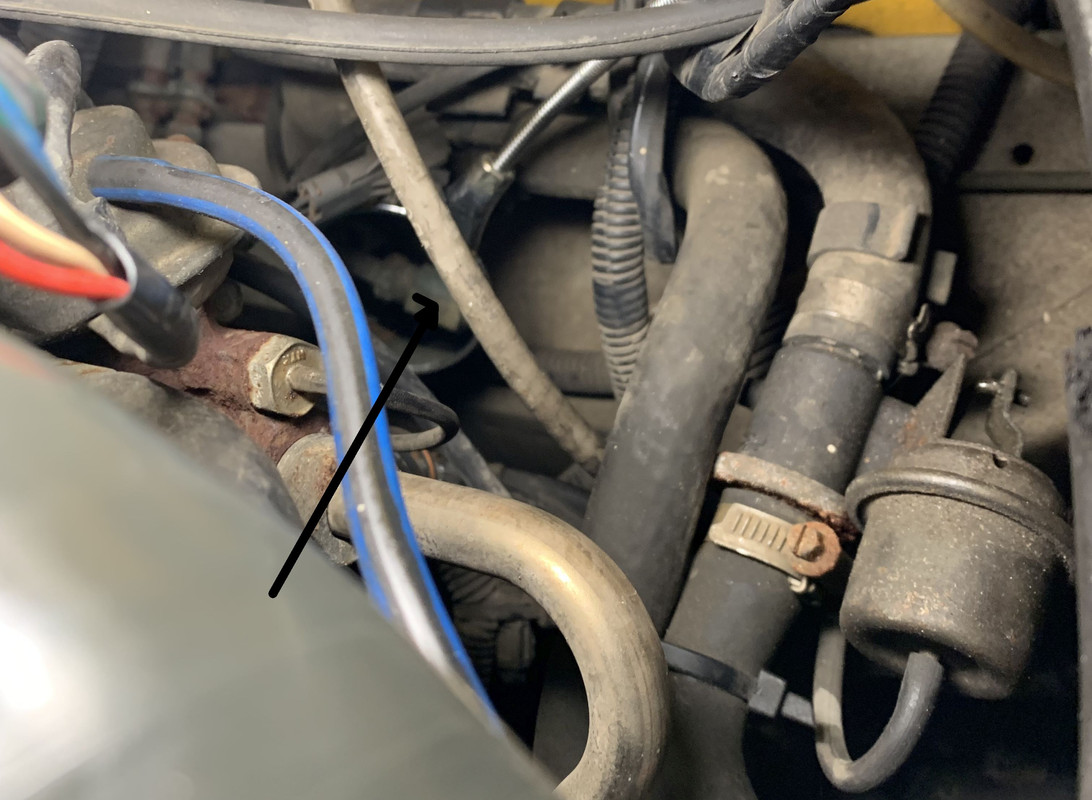

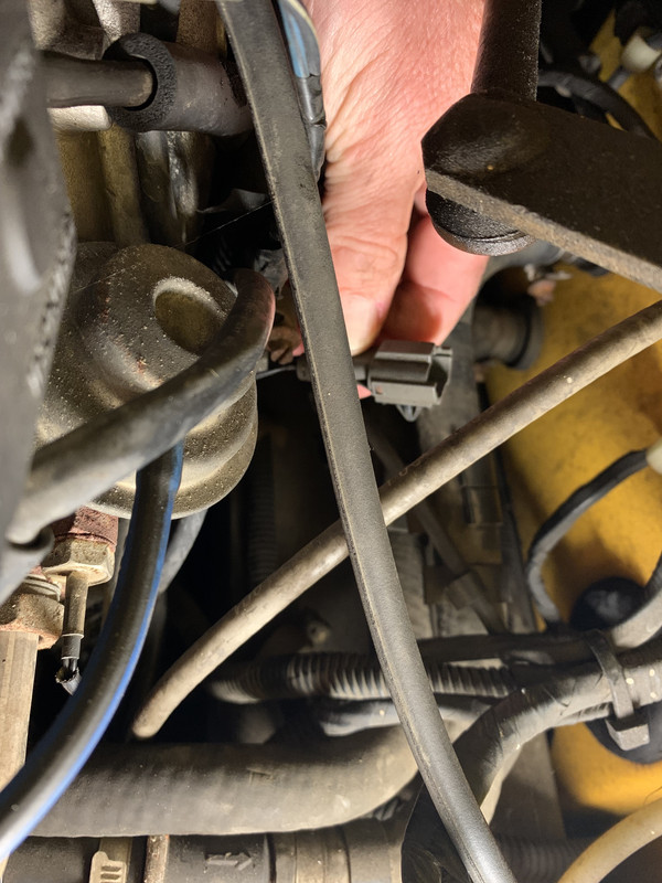

Tuga2112 wrote:Have you checked if the knock sensor is properly threaded in and doesn't have any play?
Ha! I'm guessing this was a test for a bit of a laugh Joao! Took me a while to look up where the knock sensor is. Back of the engine of course makes it almost impossible to get at. Did my best and I'm guessing its this bit arrowed in the mirror image??? If so its all set nice and tight.
While I was back there, I did come across this connector which is always slightly worrying when not connected to anything! As my symptoms are all very sporadic/occasional its almost certainly not relelvant but would be interested to know what its for?
