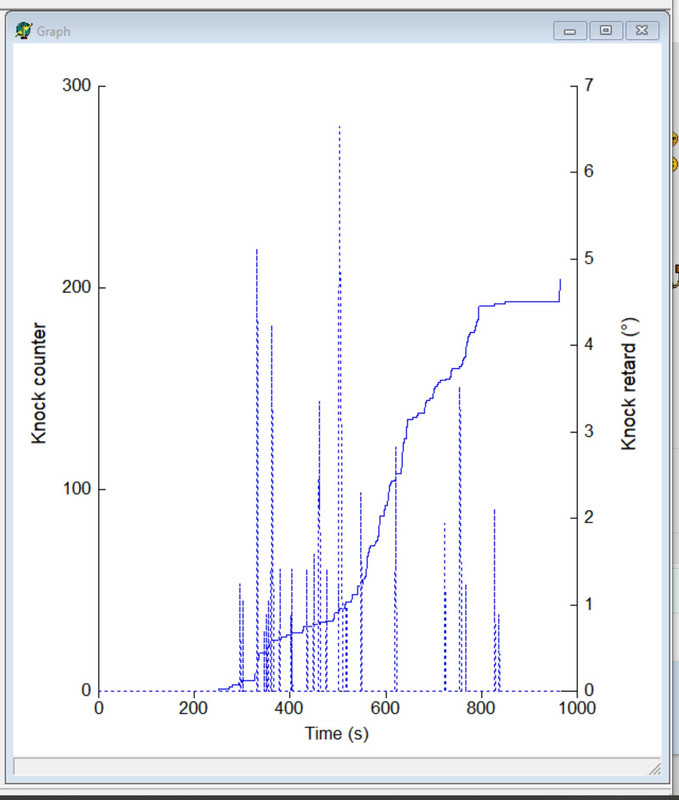

Here's the ElanScan file for further diagnosis. There's a climbing Knock count, an Overboost later on in the run, and a Prom error which could be the mountain switcher doing something untoward. The PromID appears to be 599?

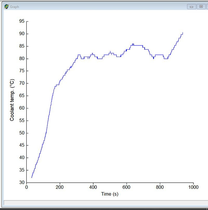

And today I went for a run and produced this coolant graph as promised
In a sense this is good as its much more what I would expect - going from home(cold) to the nearest petrol station - temp climbs to "normal" and pretty much stays steady until I'm sat next to the pump pffaffing about with the laptop to stop logging and save the file while the engine is idling and getting hotter. So the new CTS appears to be working well. Trouble is the 6-7 miles were on a country lane with traffic and at 30 to 50 mph speeds....so not really much of a test!
I did give it some beans on a slightly longer circuit home, but didn't get to any loss of power situation.

Pleased to see the coolant looks more believable than last year. Coolant temp rises while idling/waiting. Dropped for the time of the laps on track. Rose again once coming off track until shutdown. I'm hoping that's what we would expect - reacting to the lack of cooling air flow through the car at low speed/stop? Seems believeable to me anyway despite being slightly counter intuitive that it cools slightly when under max load!
What is Coolant raw? Its graph shape is the opposite of Coolant temp.
There were a lot of knocks (60) recorded in the 10 mins recording. As far as I could see, no retards - why no reaction? Or am I looking in the wrong place?

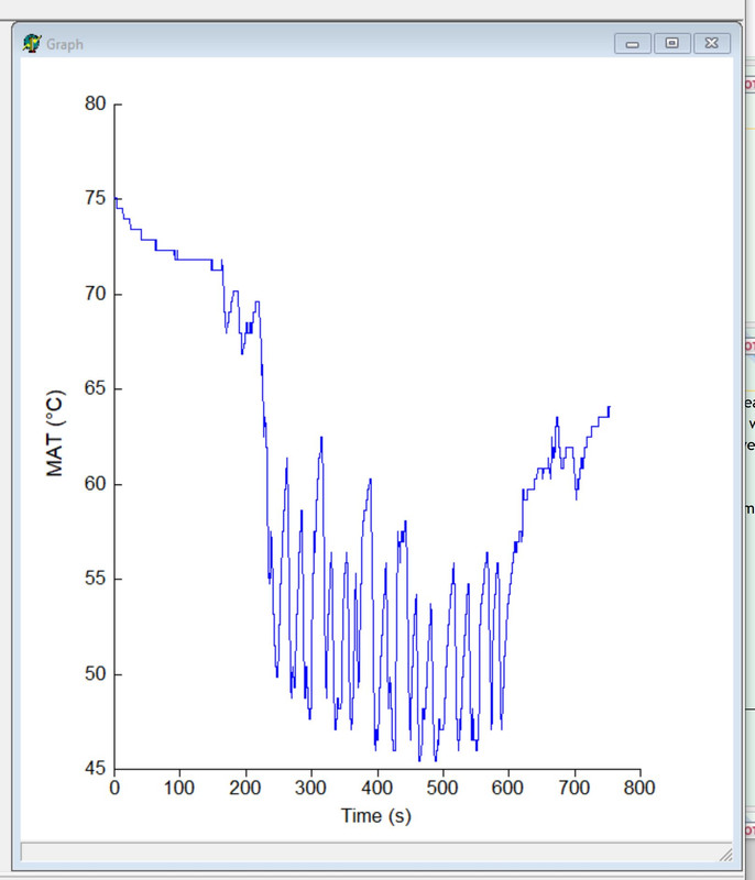

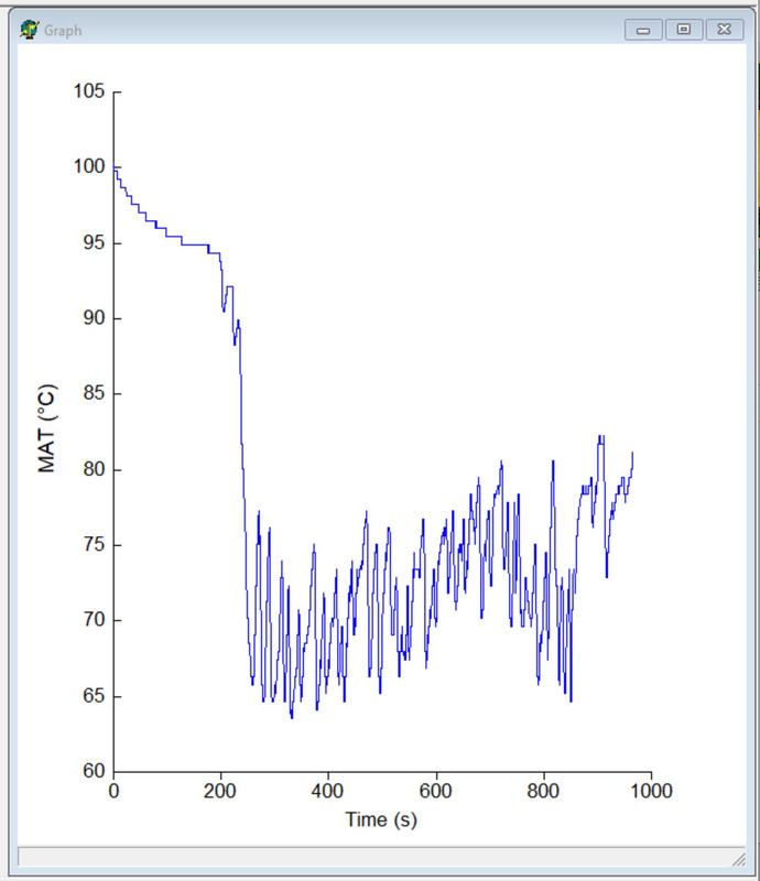

Thanks Joao. Honestly dont know about the pipework as not sure I'd recognise if it was right or not.
Is the MAT temperature relevant to what you're asking? If so here's the graph from this year
Looks fine to me (but it would since we didn't suffer the issue!) - higher on idle while queuing, then oscilating lower while on track, rising again when we came off before switch off. Comparing to last year where the problem was dire...its all much hotter, but also looks OK to me - but maybe that's too hot???

Postby Tuga2112 » Tue 28.05.2024, 08:03
yes Mike, that is the sensor that would report what i was thinking.
now, this is all ignorant statement. and im sure others will know better than me. BUT i looked up air dencity tables based on temperature and found this page.
https://www.engineeringtoolbox.com/air- ... d_600.html
if you scroll halfway down, you find a table (or just ctrl+f "Density and specific weight of air at 1 atmosphere pressure, at temperatures given as °C:")
and there i found these figures first number is temperature and second is kg/m3
60 1.060
80 1.000
now, if i interpret this correctly (and crudely) at 0 bar, you have 6% less air for combustion, if your pushing an everest chip, that be 0.92 bar, which is nearly 2 atmosferic pressures.
im making the crude assumption that would be close to a 10% less air going into combustion in between the 2 readings.
i mean, this is all armchair ignorance. but in my head. i would expect at least 10% less power between runs. which i guess could feel like a huge difference when on a track ?
i just wanna make you aware, i have no engineering background, so this is all assumptions but im hoping letting this thought out there can open up (or dismiss) other avenues of investigation.

My guess would be ignition timing. Either base timing or CAS sensor fault.
I'll guess that when you're tracking it you get enough errors for the ignition timing to be retarded enough that you notice it.
Interesting that you get Knock on the parade lap - there shouldn't be any.

Joao, thanks for the analysis, I can see your logic. However, I dont think your line of thought on the graphs reflects the symptoms I get. On last year's graph, the car was really excellent up to around 600s, and only then did it loose power and eventually backfire and CEL. I'm not seeing a change in the MAT graph that would trigger/result from that albeit there is a slightly less concise movement - but of course I'd be reacting on track (backing off!) which may itself have had some effect.
Thanks Simon. I too am concerned about the knocks - particularly as this year there was no retard reaction recorded at all despite the 100 count. What might cause no reaction to be recorded? Last year there were retards
There were around 100 knocks and plenty of retard over the first 600s thereafter although knocks climb another 100, much less retard action. I dont "know" for certain about my base timing as I dont typically work on the car myself. I've been trying to get to the bottom of this with help from SWLC for more than a couple of years. We've spoken about base timing and I've been assured its been checked and rechecked and is spot on. I believe them - they do this for a living! As part of the elimination of a more prevelent stutter they tried a different dis unit (no change) and then I had a new (s/h) CAS and Hall Sensor assembly which appeared to do the trick. This was in Feb 2023 before last years Combe. Clearly it didn't fix the issue in extremis - or quite possibly there was more than one issue. I did later fit a new Temp sensor myself and that also appeared to help, giving a more believable graphical output. Since then I've not been able to generate the symptoms on roads, just on track, and even there I no longer get a backfire/CEL just a loss of top end power.

Base timing must be checked in service mode - anyone with a strobe can do it - take it to a friendly garage just for a second opinion. You need to know that it is correct or you are wasting your time.
There should be 0 knock - something is clearly not right.

Looking at the spark advance graph, the baseline seems to be 20 degrees, and after the Boost Spark Bias Active flag is set there is more retardation of the spark going on than before.
The flag is set as a result of calculations on the number and rate of knocks, so I think we're getting closer.....

Ah OK. So we're heading back towards a timing issue and a problem caused by the number (and rate) of knocks detected. So I need to take on Simon's mantra - base timing is all - and try to either do it myself of find someone happy to do it while I watch. I hope to get some time to have a go at that later this week. Appreciate the help - thanks again.
