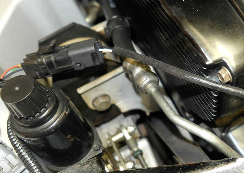

I'll get some scans/pictures posted when I get home today. I did some more fiddling yesterday. If I get it warmed up to operating temperature, I can shut the engine off, plug the MAP sensor back in, and have it running. When I do that, it shows I am idling at 0.45 bar with around 3ms injector pulsewidth. There seems to be a lot of hesitation below 3k rpm but above that it feels good. I did notice that after doing a lap of my neighborhood it threw a VSS code, may need to investigate that further.
Also of note, the battery light is on because of some O2 sensor wiring issues it seems. The O2 sensor voltage in elanscan seemed okay to me but my issues occur more during warm up when it should be all open loop anyways. Also of note, I also never see the closed loop flag turn to on in elanscan. ECU ID is 1499.
I'm going to try and check fuel pressure too, friend of mine says the test ports on GM cars of this era are 3 AN threads.

I think the issue is possibly with the O2 sensor wiring.....
.... a 1499 chip will run 'open loop' until it warms up, then switches to 'closed loop'. It appears that your issue is when cold, so maybe it's something to do with it - but I'm crap at diagnosing issues!

I agree with dapinky:
In my experience the O2 sensor heater 'gets' it's voltage when the ign light is off and the engine is running - so I reckon your sensor probably won't get hot enough to go 'closed loop' as you warm up, unless the light goes out (btw I hear that some replacement alternators from one of our suppliers apparently doesn't switch off that red light...)
In that case you'll stay defaulted to 'open loop' - if you've got an SE that's been 1499 converted like mine - and if you've got a mixture 'pot' still attached I reckon it'll run at whatever that's adjusted to - which might be well out, causing your symptoms? (Successful 'closed loop' will have over-ridden this.)
Elanscan will tell you what your air:fuel ratio is. It should be 14.7:1 on 'closed loop' (btw I found the on/off info flag at 40 in the new EScan...)
When EScan recently showed my a:f as 14.5:1 I discovered my sensor m/plug had de-pinned behind the wheelarch plastic and I was running 'open loop' absolutely ignorantly at 14.5:1 on my pot adjustment for a year or so wondering why I was using a little more petrol and MoT emisions were not quite as good as before :( . New Escan interest prompted me to use it again or I might never have been aware (thanks Matt, Ken, Ron and any others I might have missed :D ...)
You can also use a multimeter to check the O2 sensor m/plug heater voltage is 'there' by earthing it with the engine running; I can't remember which of the 3 wires it was atm tho' - but there is a LEC post...)
edit: almost certain it was the brown lead that gave the ~12V heater supply - pin B apparently...someone might verify, I hope...
