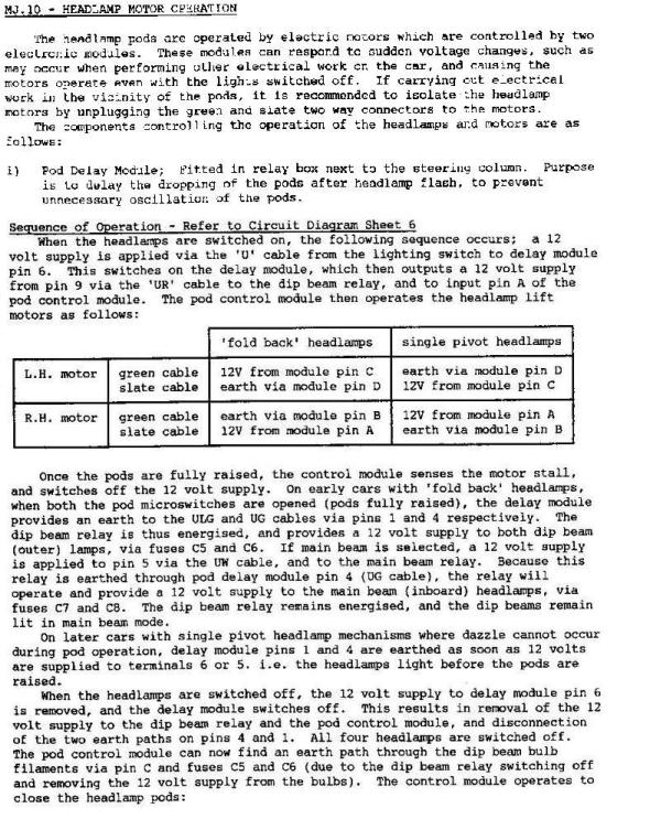

Pod Delay Module, Part # B100M0110F went obsolete 13/11/18. I am in the US and I still have a couple at $40.00 each + postage, but best that you make sure it is really what you need. Read the attached sections to properly understand and test the module.
Headlamp Operation (relays and pod control):
Click to enlarge

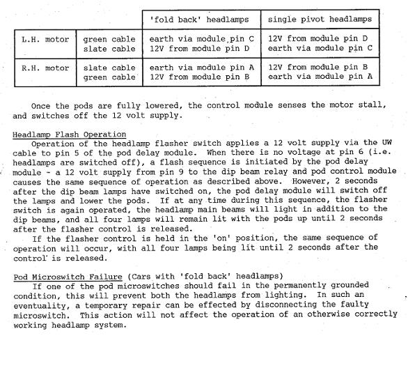

Additional info:
Click to enlarge

How have you narrowed it down? The function of the Pod Delay Relay is just to hold the pods up for 2 seconds after the headlamps are flashed - it let's the driver do a quick 'double flash' without the pods trying to go down in between those flashes.. It shouldn't stop them coming up. If it's failed I think they'll just go down immediately. Wiring Diagram 6A applies to most SE's. (Early 'opera glass' headlamps had micro-switches - Diag 6)
The Pod Control Module controls the feed to the motors using electronic switches to reverse the polarity for up or down, and uses electronic switches to sense current draw. When the lights are switched off, it also uses an earth through the dip filaments to trigger the reversal of polarity to 'down' rotation of the motor, to put the headlight pods away. If both dip bulbs have failed the system will not work properly and get's itself in a muddle with motor feed polarity .. it can pop some fuses.
First thing to check is whether the dip headlamps are coming on when the pods are still down ... quite easy to see when it's dark. With a bit of luck they won't be and all you need is a couple of bulbs.. possibly a fuses or two ..

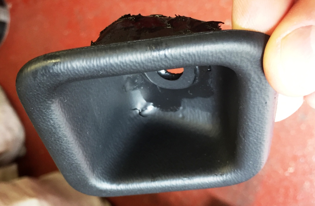

The Stowage Cable is installed in the R/H (your driver's side) "B" Post. The hole in the L/H side is for the fuel lid release cable.
If anyone else wants to receive the picture group, just email me a request and I will reply with the file attached.
Re: H194 VVF
Postby Brit-Car-Nut » Thu 11.07.2019, 23:39
Thanks for your email. I see what you are describing. Too bad the Lotus supplied parts book are all newer than the first generation bodies.
Joe is looking for help with the following:
Click for larger view
He could really use replacements for the housings, retainers and cables.
If anyone knows the part numbers or where he can get replacement housings, retainers and cables, please speak up.
The part numbers are not in any books I have found including DeRoure.
