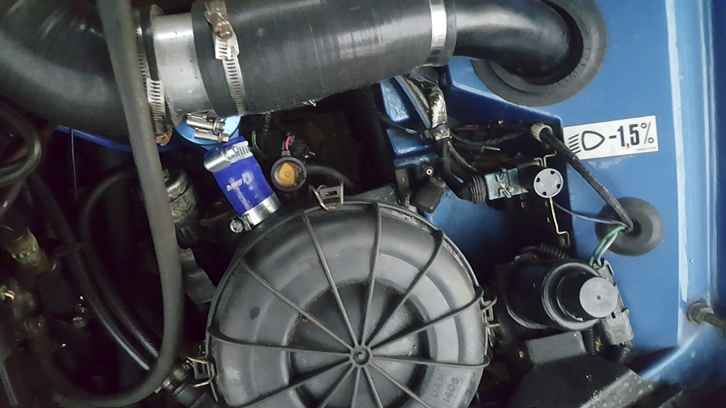

Postby burble61 » Fri 21.10.2016, 12:30
As promised, a few pics....sorry for delay, been using it bit as per advice!
Need to look at the panel alignment between sill and lower wing - what mounting bolts i've been able to see look seized solid, so looking forward to that one...
Interior is reasonably tidy. Glovebox lock was separate, fixed now. Will be taking out the seat spacers on drivers side to give a better position (well, for me anyway). Seals around windscreen are 'orrid..and window trim corners missing (I have one of them but it was so loose it was going to drop off). Seems a 3D printed version now available, so an early purchase.... A patch where plastic has broken off the top rail is just visible - possibly age/UV - will need to see how far thats gone & fix. Will be seeking advice on how best to do that....
passenger side panels much better aligned!
boot contained original, unused toolkit - wasn't expecting that.
Turbo heat shield held on by that single bolt... Vacuum tubing was quite perished so replacing that - first part made a noticeable difference. Tube strung across cam cover is vacuum input to BOV....to be replaced shortly by line using spare port on throttle body to tidy it up.
Loads of jobs to keep me busy over the winter months...still at the ownership stage where I smile every time I see it!

I see you have a Bailey Recirculating Dump Valve that is not 'recirculating'. Ideally it should 'blow off' into the filtered side of the air filter and straight back into the turbo. More efficient and quieter too.
Short length of hose, 'top hat' connector through a hole in the air filter canister and couple of jubilee clips is all you need... something for the 'things to do list' ? :lol:

Phil, yes, "Project Recirculation" is now in the top 3 to do (others being finish off replacement of the vacuum tubing and replace the thermostat which is stuck open).
A question for you and any others who have done this....it looks reasonably straightforward, albeit with care marking up and cutting into the air filter housing. What bulkhead fitting into the casing did you use? I have some the right size from a garden project, with a max temp rating of 80 degrees C. would that suffice (i'm assuming it would, given the filter housing is made from a similar plastic) or is a higher spec part needed in this position?
Thanks
Burble

For the RDV I couldn't find another 'through connector' similar to the Bailey supplied one I have on the other SE so used a 25mm aluminium blanking plug and drilled it out to make one. (Step drill is very useful)
www.ebay.co.uk/itm/Alloy-Hose-Blanking-Plug-Bung-Silver-BOV-Dump-Valve-New-Aluminium-CNC-Pipe-/221847809272?var=520733911436&hash=item33a728ecf8:m:m3s948unYgH79uN3pRnviuA
I cut a thin slightly curved slice off the hose and used that as a 'curved washer' on the connector inside the air filter housing and the curved end of hose outside deals with a flat shoulder against a slightly curved container. Seemed easier than trying to curve the aluminium shoulder.
Hope that helps...
