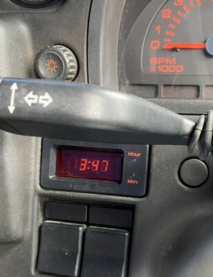

Postby Imnotajediyet » Sun 20.06.2021, 13:16
Ok thanks. I’ll suck it and see what I can do. Don’t suppose you know how to remove the digital clock?

Re: New Member
Postby dapinky » Sun 20.06.2021, 13:34
Imnotajediyet wrote: Don’t suppose you know how to remove the digital clock?
Mine hasn't worked for many years (I have a new one to fit, but haven't got round to it yet!) - due to it's position it is a pointless part of the car, and it is far easier to look at my watch (which is at eye level with hands on the steering wheel).
I have yet to consider how it is held in, but would expect it to simply pull out with a couple of plastic tabs....... (don't quote me - I don't know). Unfortunately, the Workshop Manual doesn't tell you, and nor does the Electrical Manual (unless I missed it when I just had a look), so it can't be that important a procedure, otherwise they'd tell you.

Postby Imnotajediyet » Sun 20.06.2021, 15:08
Yeah , I know it’s fairly pointless but I’d like it to work, once again I’ll just give it a go, what’s the worst that can happen. Even worse the bonnet release isn’t working, not sure why it has been working apart from once the other day. I’ve tried pulling and pushing etc on the bonnet but no joy. Ordered some Sugru though

Postby Imnotajediyet » Sun 20.06.2021, 15:48
Clock just levers out
