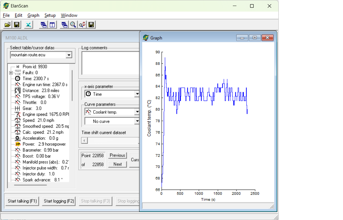

Postby dapinky » Mon 15.05.2023, 18:23
If you have a look at many of the published Elanscan results it will show the exact temperatures at various stages (ie, when the thermostat opens, when the fans cut in, what it runs at when the fans stop etc etc).
This is one of my old runs when I was in the Isle Of Man on the Mountain Route....
It shows the thermostat opening at 83C, then allowed to warm up to get the fans to cut in at 89C, then generally dropping to the 82-84C range during the run
