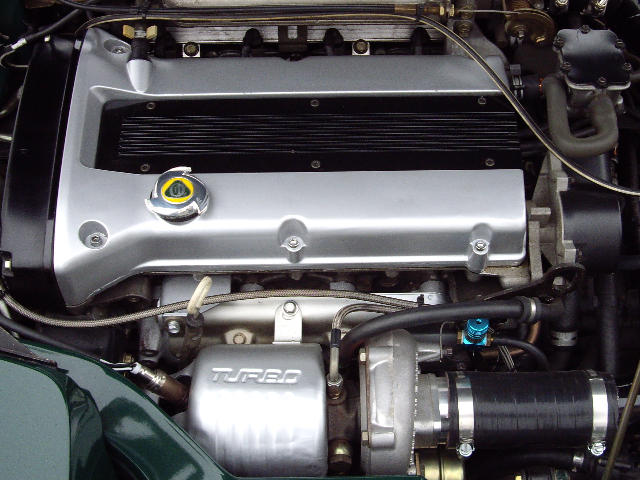

My valve cover used to be stamped "Isuzu-Lotus," now it's just "Lotus." I went from a car with just "Isuzu," to one with "Isuzu-Lotus," to "Lotus." I guess the next step is no stamp at all????
