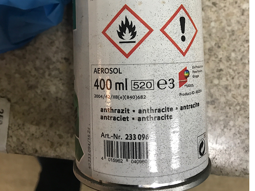

I used this aerosol (recommended somewhere on the forum) to respray the steering column cowl on my S2. I can’t tell the difference between this and original colour. Make sure you clean and degrease the surface thoroughly before spraying.

Just done a search but cannot find anyone selling the Auto K with any in stock, did you buy it recently, could you let me know where you purchased it from?

I got mine from Amazon, but I see it’s unavailable there. The only other place I can find is here.

Firstly thanks to Saltire for recommending the Auto K Anthracite (233 096) spray paint.
I managed to find a U.K seller that had some in stock and I have to say the colour match for the centre console is excellent. Once the console surface had been prepared and cleaned the spray went on easily making it look like new. Two coats would have been enough but I did three to be sure which used approx three quarters of the 400ml tin.

Grogers wrote: . . . thanks to Saltire for recommending the Auto K Anthracite (233 096) spray paint.

I like the look of the console. Where did you get the paint from?
