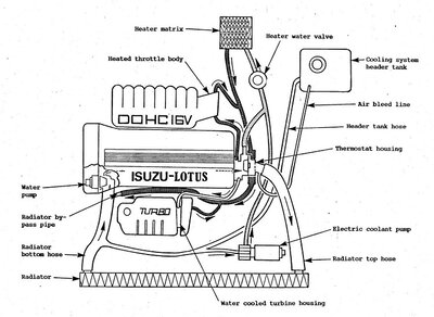

Postby Wevster » Sun 27.04.2025, 19:10
A quick update, the heater valve definitely needs changing mine is original and working ok but the newness has definitely worn off! I’ve replaced all the coolant hoses which was an interesting job, the small hoses around the turbo were a bugger to remove. I started the car with it jacked up higher at the front, and bleed the rad from under the light pod, I ran it up to temperature until the fans came on, however the temperature didn’t drop. Heater control open but no heat so I have an airlock within. To make matters worse the brand new long hose that routes from engine to rad to auxiliary pump and expansion tank has developed a weep from one of the manufactured joints! So i’ll need to drain the system replace the hose, and remove the airlock, any recommendations on that? I did flush out the heater system both ways to clear the usual debris. Hopefully it’s just bad luck on the hose and the airlock is a common issue.

Postby Wevster » Sun 04.05.2025, 13:35
Hi All, so the new hose has arrived along with the heater valve and fitted up this morning, I decided to fill the coolant from the heater feed hose until it reached the header tank hose and back on its self to the heater valve. I then undone the rad air bleed bolt under the headlight to release air. I topped up the expansion tank. I started up and ran for 10 minutes and up to temperature, the fans came on at 3/4 mark but didn’t drop the temperature. I switched off and let cool down releasing the rad bleed valve. The temp switch within the cabin was on hot but still no hot air. I decided to run the car up the road for 2 minutes and return, unfortunately no difference still getting too hot. I have repeated this process again and no luck. I have noticed that the right side of the radiator is cool to touch and so is the bottom rad hose and also the heater return pipe, the rest are hot as expected. Obviously I have an airlock/circulation issue going on, any bright ideas? Possible water pump failure, anyway of testing?

Postby Fredjohn » Sun 04.05.2025, 16:10
Try parking on a steep slope, pointing uphill. Run the engine with the bleed valve open, and the air should naturally go upwards. Ensure the heater valve is open too.
Another thought: is the thermostat stuck closed?
Do the cheap things before tackling the water pump.

Postby Tuga2112 » Wed 07.05.2025, 12:48
you can "bench test" the thermostat to be 100% certain its woreking
however. this is a story from a very long time ago. but may apply to you. porche owner in portugal back in the mid 90s, had issues with overheating only during trafic and the engine didnt cool down, porche engineers checked "everything" and couldnt find the culprit.
guy sells car. and 3 weeks later the new owner figured out the radiator fans where blowing in the oposite direction to what they were meant to.
which is kinda funny as a asside because someone asked about the rans direction in the forum just a few days ago. but its something worth checking
water pump is also something that comes to mind.
and just to clarify. you definitly bleed the coolat with the heater on maximum temperature right ? people will say "heater on full blast" and when they say that its implied that your going to set it up in hottest temperature. you want the valve to open (have you checked its operation?) which requires the engine to be generating vacum.... (we assume you dont have vacum leaks)

Postby Wevster » Wed 07.05.2025, 15:24
Hi, thanks for info.
The fans are definitely sucking air through, and the temperature dial was all the way round on hot, and the air coming through the vents is hot. (when warmed up).
The inline heater control valve vacuum is working ok. The radiator does seem strangely suspiciously cool,(is this normal, or should the rad get hot?) which does lends itself to air still being in there. It looks like a new all alloy rad. The garage did pump the coolant through using their machine, and I did explain about the bleed bolt under the light housing. I'll try again bleeding it as it's quite easy, however the coolant can shoot out when under pressure, I'll just crack the bolt to see if any air hisses out. The only thing I haven't checked is the water pump, which I believe was fitted last year. I'll keep plodding on.

Postby dapinky » Wed 07.05.2025, 15:52
I know that you said in the top post that the cambelt and waterpump were replaced, but having read through the whole thread, the thing that concerns me is that there seems to be inadequate water flow through the whole system......
...... If it were me, I'd be suspecting a fault with the "new" waterpump - it isn't unknown for the impeller to become detached from the shaft and as the belt turns the pulley, there is no water flow through the engine (other than thermo-syphon effect).

Postby KenS » Wed 07.05.2025, 22:39
If the heater matrix is working well, would that not indicate that there is flow in the system, so might still be worth double checking the thermostat and for kinks in the hoses before commiting to change the water pump.
