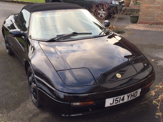

First things first, a post winter spruce-up; came up quite nicely with just a soapy wash.
After a bit of a battery top-up, started first turn of the key and warmed up nicely. Out for a quick run round the block only to discover that the brakes were less than great....hopefully it's just a matter of bleeding them. Still, pretty happy that nothing disastrous has happened after the winter lay-up - bring on the sun!
Comes up nice....

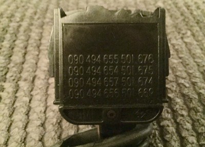

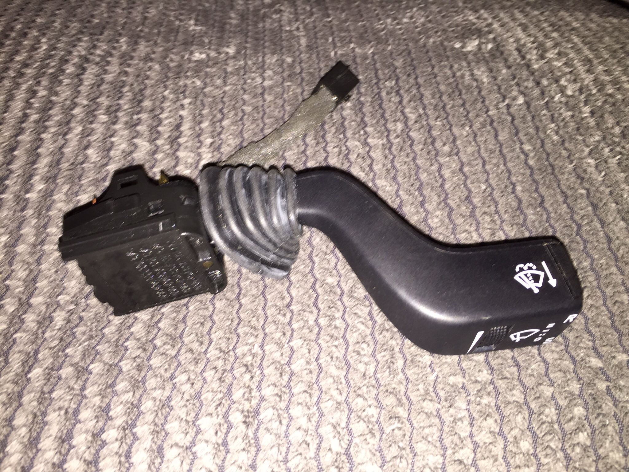

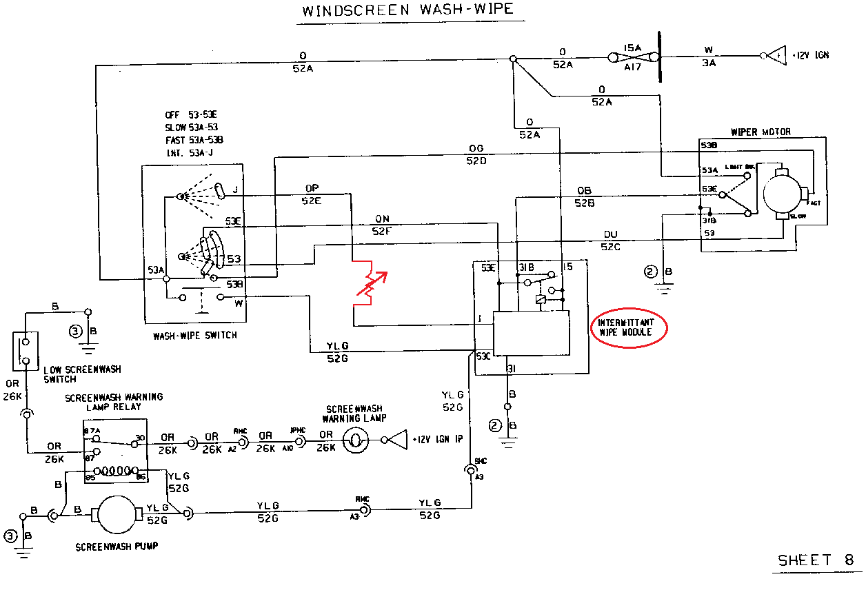

So, number 8 on the list is 'intermittent wiper upgrade', so here goes...
I am aware of the type 99 'programmable' replacement, but I like the idea of being able to turn a dial to set the interval - just personal choice, nothing against the alternative.
Having had a study of the electrical schematics and trawling the Interweb, it looks like an absolute breeze (famous last words).
Only 2 new bits required:
Firstly, a new wiper stalk from an Omega. There are a whole heap of variations, but the one needed is from the saloon model. I picked the one with the MFD (or is it cruise control?) buttons as I want to use them to change tracks on my Sony head unit. Cost £20 new off fleabay. You can read the partnumber on the piccy below:

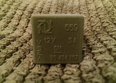

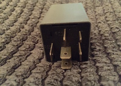

Secondly, a replacement wiper relay, again from an Omega; part number GM 90494187; these seem to be quite often yellow, but I bought a grey one simply because it was new and not s/h. Cost £13.50 new, again off ebay.
Not fitted yet, so I may be back to eat my words, but I've had it working on the bench and it behaves exactly as I expected. To fit will require one wire to be cut in order to insert the new control. More pictures showing fitting to follow once I find time to spend on the car. Watch this space...

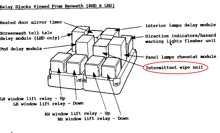

By way of background, for those interested, all that is required for the variable intermittent wipe to work is to introduce a variable resistor into the circuit that feeds 12v into to 'I' pin on the new relay; the larger the resistance then the longer the delay between swipes. Therefore, cutting the orange/purple wire that goes from the intermittent stalk setting to the new relay and introducing a potentiometer will give a variable swipe delay. The knob on the Omega stalk is a simple variable resistor. In theory, this mod could be achieved without changing the stalk, but instead using a pot mounted somewhere else.
Here is the modded circuit:
And the relay that needs swapping:

Postby Enright » Wed 18.03.2015, 13:53
Great minds must think alike because I figured this could be the way to go a while back (for the same reasons as you), and even installed the same wiper stalk on my original Elan, but never got round to butchering the relay.
I'll be interested to see what you do to the Omega one when you open it up.

I have a wiper stalk ready to go (just need the relay now) and am waiting to see how this works out. Should be pretty simple. The stalk I've bought also has the extra controls on the tip of it for a trip computer. I am planning to wire those up and use the contacts as stereo controls. There's also a light switch stalk with extra controls that I'll probably buy and use for more stereo controls. Fun!
A full write up with a schematic and pics will get you extra points on the LEC project board! :poke: :-D

Postby maz_r » Wed 18.03.2015, 15:04
Thanks both,
No butchery required to the relay - it is (should be!) a drop in replacement.
I too have the indicator stalk with extra buttons, but decided against adding more controls for the stereo - I might change my mind later on :)
To be perfectly honest, I was toying with the idea of designing something that made the wiper delay speed sensitive by hooking into the VSS signal on the back of the instruments, but this seemed a heck of a lot more straight forward! Maybe I'll revisit that when there is nothing more on the list....
