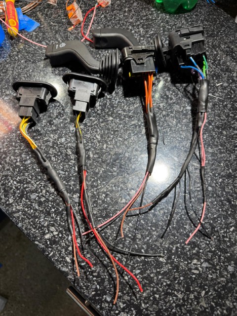

The limit factor with the MaxECU PDMs is the Inputs and knowing that one needs to leave the ECU inputs for the engine I've had to use a few tricks as well. Instead of using a bunch of simple digital signals I have had to use analogue voltage ladders to get multiple signals into the PDM using a single wire. Basically, instead of On/Off I get say 5v, 3v, 2v, 1v, 0v. On the flipside the PDM output a known and stable 5v with internal Ground, so no need to build voltage table to compensate for common ground or alternator speeds.
Above are the window switches and stalk commands, the black wired are AIN (Analogue IN), pink are Sensor 5v and rest is usual.

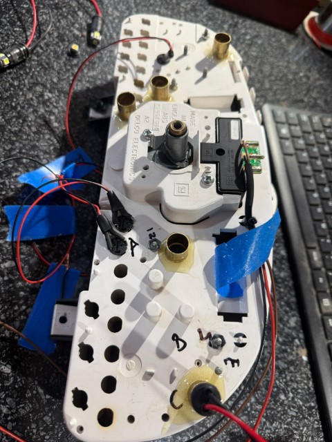

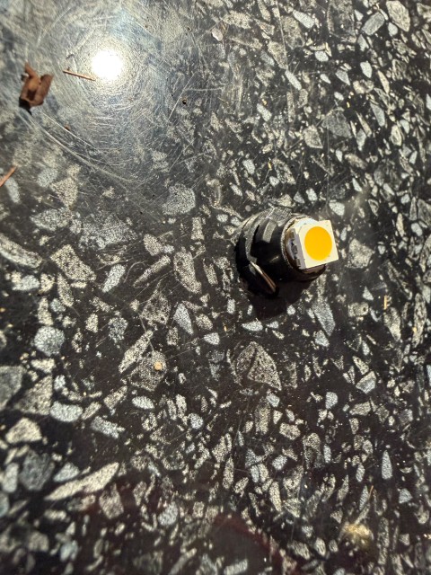

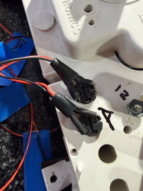

Most of the electronics are now done from the inputs side. Lost the battle with the Hazard switch and its simply too difficult to get reliable. I have opted for Blink Marine canbus switches for Fog, Hazarad, and a new "daughter configurable" switch which will probably involve some blinking and quick toot of the horn. Photos later on.
In the meantime, I have found a way to get decent light for the instruments, Problem is that LEDs are very directional so I tried all sorts of solutions, from frosting to a reflective cap. In the end found some with good number of small side SMDs and had to Araldite brass fittings to be able to use the rubber holder. Have some new LEDs coming with three times the amount of side SMDs and each one is much smaller.

Otherwise the T.47 units from ClassicLEDs went straight in, I am not using the original circuits so had to solder tails. Eventually they will go into a Deutsch connector and back to the PDM.
