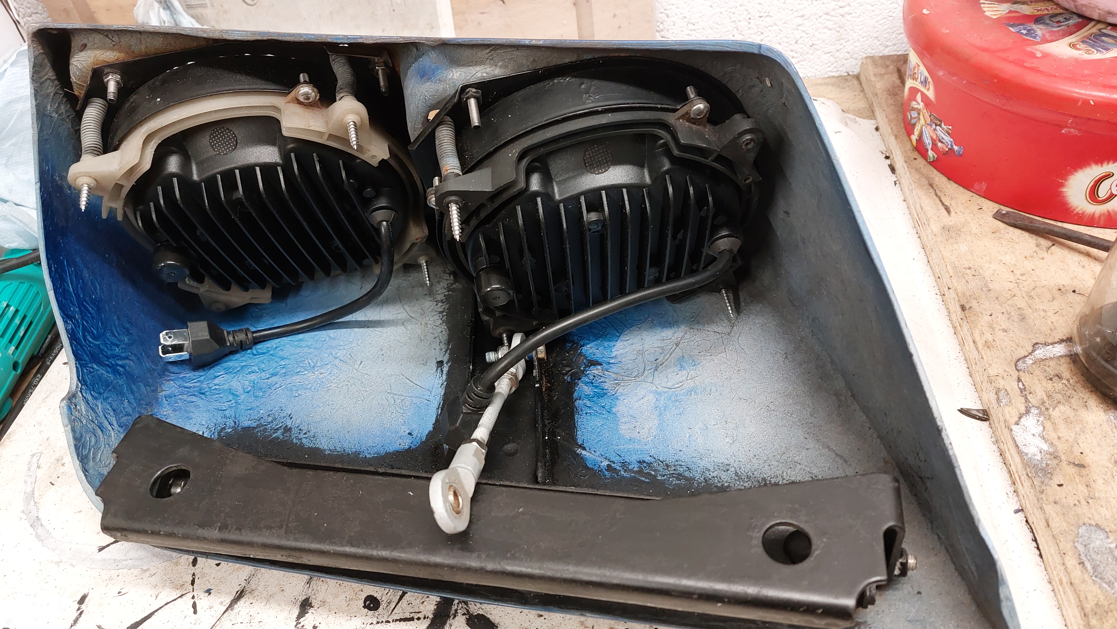

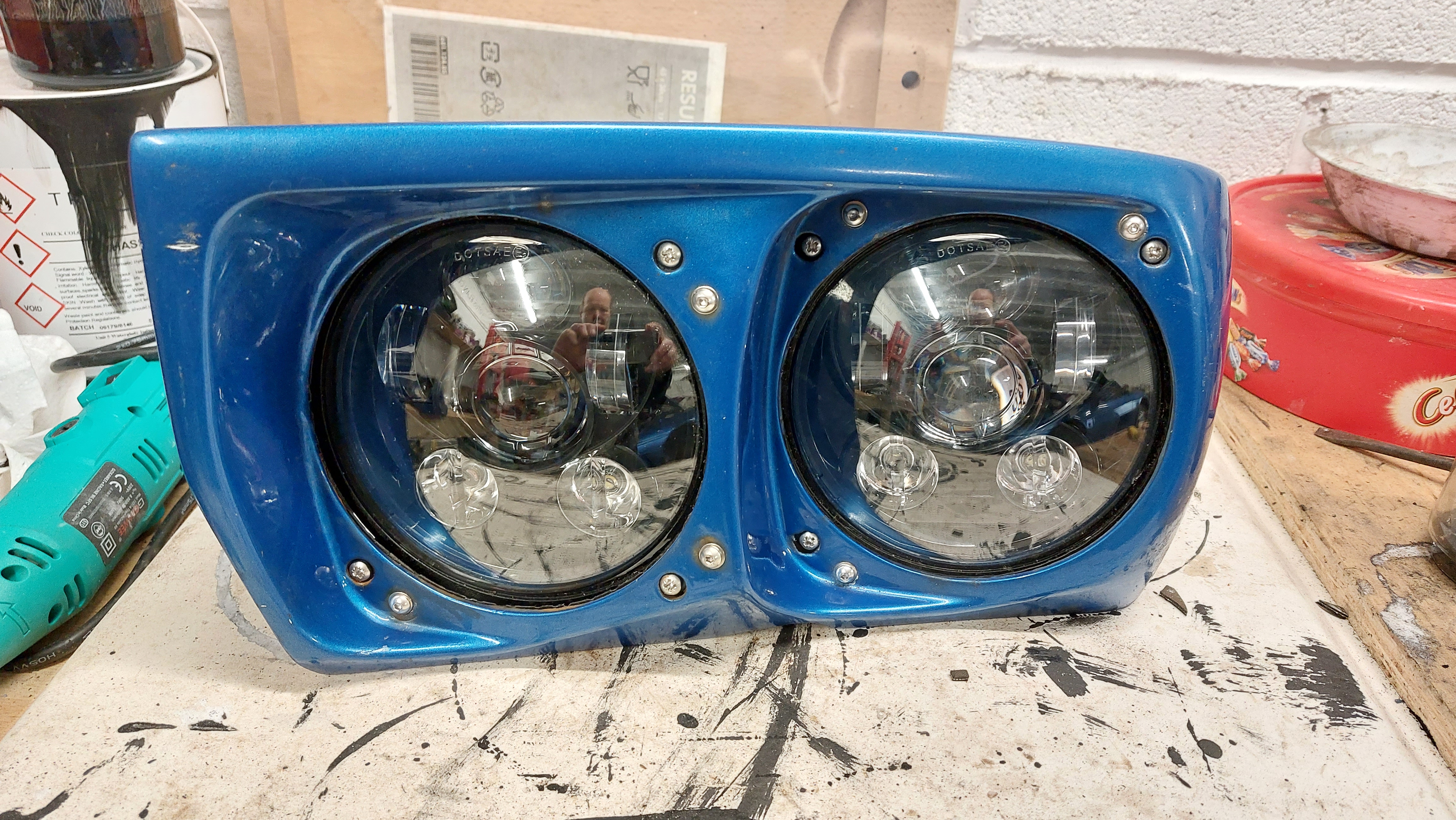

Still, I have been refurbishing the headlamp pods, and anyone who has ever taken theirs apart will probably (unless they were very lucky) know that the metal bits which hold the headlamp units to the pods have a habit of falling apart due to rust.
I was quite fortunate in that all 4 of the metal rings which hold the lamp units to the plastic rings were good enough to re-use (after a good wire brushing, soak in phosphoric acid & repaint). Also, 3 of the 4 flat mounting rings which bolt to the pods were good enough to re-use. I needed to drill out some of the M4 bolts and clean them up a lot before dipping in acid and painting them. The one that was too weak to use was sound enough to use as a template to make one out of a spare bit of stainless steel sheet - so all good there.
I reassembled them all today with new LED lamp units sourced from China at the huge cost of about £8 each (and about the same for shipping, then add on VAT..... so all 4 on my doorstep was still under £75, so I call that a result.
Fitting the new units took a bit of fettling, as it was necessary to cut a new groove in the plastic rings so that the LED units sit correctly are are not 20 degrees rotated from vertical - but it took longer to work out where to put it than it took to cut it, so no dramas. I had to cut a gasket out of 2mm neoprene (used only because I have a sheet of it on the shelf anyway) to prevent the lamp from being too loose in the metal rings (they have a rim which is about 2mm thinner than the old lamp units, and without this gasket they rattled a bit). A thin bead of silicone would have been far quicker, but may take more effort to dismantle in the future - if necessary.
All in all, it has taken me over a week of messing around to do the job (but a lot of it was either waiting for the rust removal chemical process, or waiting for paint to dry).
Still, as I had the stainless sheet in stock, re-used most of the parts, was happy to wait 3 weeks for the parts to arrive (I bought some ballast resisters as well so that the headlamp pods will still raise and lower - hopefully), and only had to buy some M4 setscrews and self-tapping screws for the beam adjusters, I was quite happy......
...... total cost to me was well under £100, and when PNM will sell you a set ready-to-fit for £450 (with all new stainless bits and pieces - so better than having to re-use your old stuff) I was quite happy with that.
The light units I bought are identical to the ones used by PNM (and the same as Mark used when he was looking at doing this job on Stevos old orange elan) - 45W main beam, or 30W if only using the dipped beam portion of the unit.... all fully DOT and E certified for UK use

My selection was based on a couple of things.....
(1) it needed to be a unit that can be used (partially illuminated) for dipped beam, and fully illuminated for main beam (most of them can do that as they are designed for single use on a motorcycle).
(2) It didn't need to have the 'additional' bits of a DRL (usually an 'Angel Ring'), a sidelight or an indicator built in.
(3) It needed to look okay (some had silly things like skulls or zombies in the lamp pattern).
(4) It needed to have a reasonable light ouput, and power input which the standard wiring can cope with (pretty much any of them).
If you look at the link I put to the PNM ones, then find the same unit on the Yangule Lighting Corporation advert (I think it's the 3rd one along, top row) you can also have units with either black or chrome background.
I went for black as it isn't a reflector surface for the lights, and it is out of view unless they're on anyway.

Postby dapinky » Wed 29.03.2023, 15:34
A bit of an update, and as they say, a picture is worth a thousand words.....
The re-assembled light pods with painted metal bits and all new stainless fittings.
I am pleased with the way they fit and look - won't know for a while how they work as re-fitting the pods is well down the list as I still have to sort out the metal hinge bracket things attached to the clam (except they are no longer attached to the clam, but the rusted bighead bonded thread bolts sheared off so will need replacing - as expected).

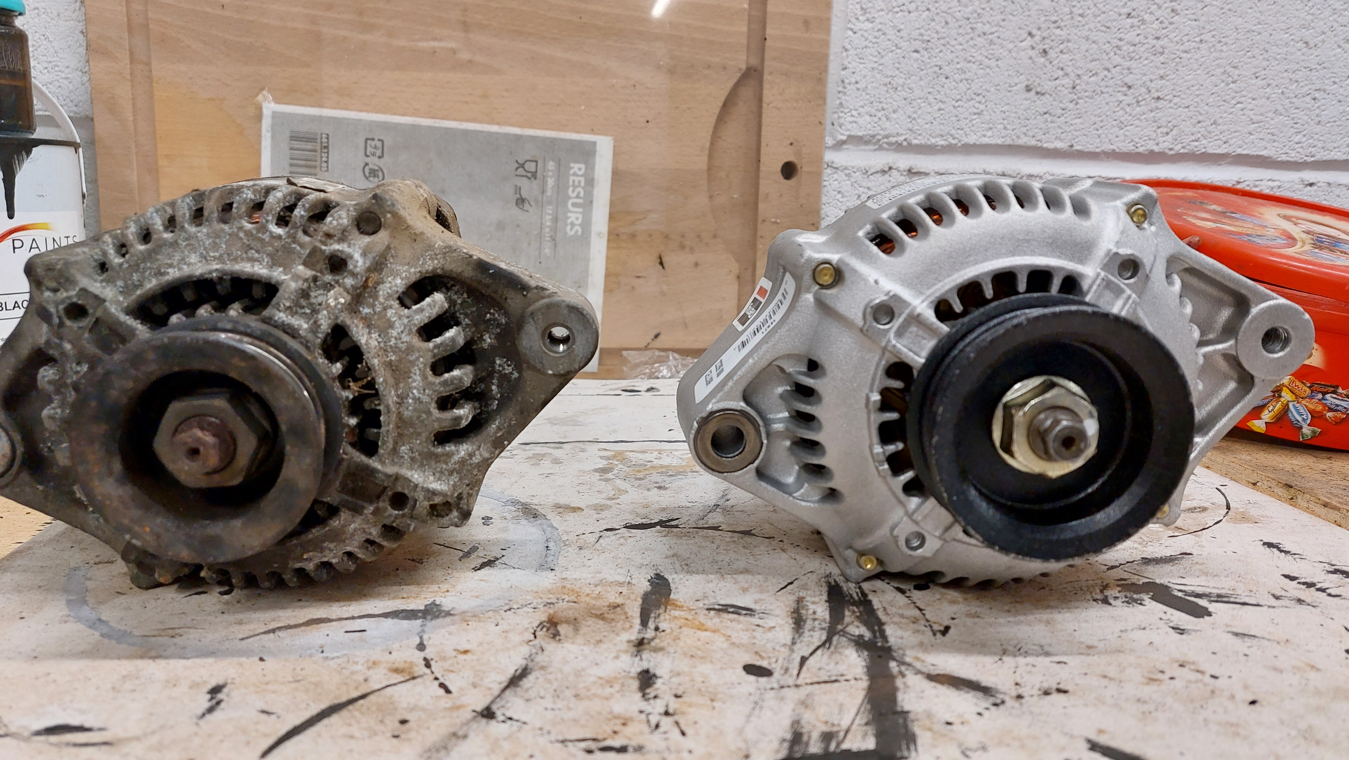

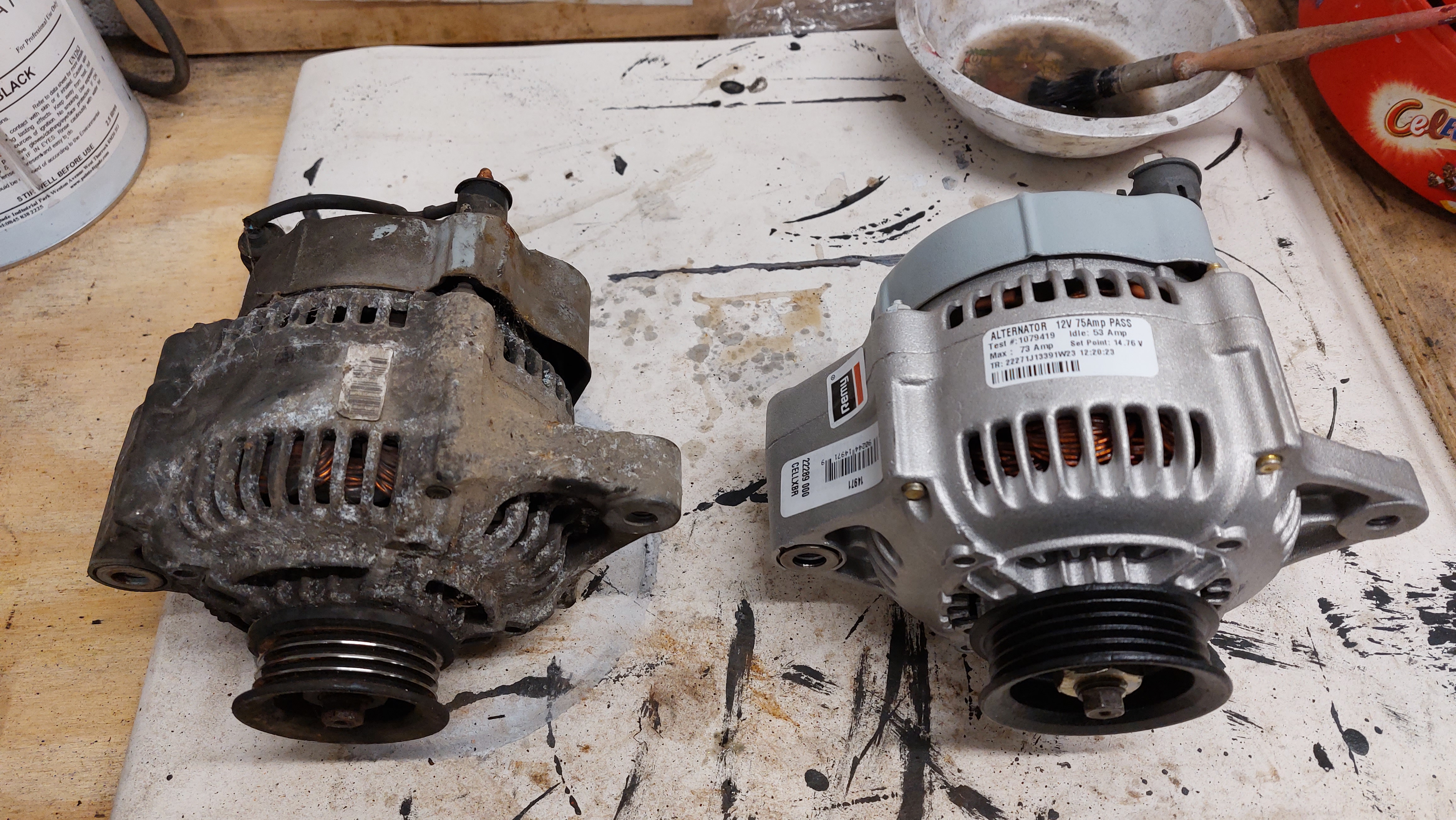

On to the alternator - really can't see what the fuss is about when people think it won't come out/go in...... it's really no problem if you simply remove the whole suspension unit and drain down the PAS fluid so you can whip the reservoir off to get to the top bolts (also allowing you to release the pipe which otherwise gets in the way a bit)
Anyway, enough of the sarcastic comments from me - now onto a bit where I need some advice:-
The alternator I have bought is from Rock Auto, and is listed for the Impulse. I am aware that it is 75A rated, and I am aware that it is a few mills bigger than the OE one - but as I smugly pointed out above, I have room to get it in without too much swearing.....
My initial thought (as can be seen from the picture) is that the new one has a slightly larger pulley than the old one.
I measured the diameters and the old one is approx 45mm, whilst the new one is approx 55mm...... this gives a circumference difference of 141mm vs 172mm, which means that it will rotate something like 80% slower.
Now, I can obviously swap over the pulleys (if they can be removed fairly easily - I haven't yet tried), but wish to know if it's worth it, or should I leave it as is?
My thought process is that the new unit will deliver 75A anyway, so running a bit slower will only mean that the bearings and internals have less wear than if it were going faster. Also, on the Impulse, it clearly works.
My concern is that at idle the red light may come on as it won't be going as fast as the Elan one - but I don't think it will happen, or if it does, it doesn't really matter.
If there is anyone with any knowledge on this, I'd love your thoughts.
I have already thought about the drive belt needing to be a tad longer, and don't think that is a worry - but I may be wrong on that as well.
on mine the pulley came out very easily.... i did use a fairly powerfully impact driver to remove it, but i think you wouldnt have issues with that.
as far as pulley side. i can only throw some guesses.
if it delivers 75A with that pulley on the impulse.. if you put the Elan pulley on it. it will run at 120% its speed on the Elan (assuming the crankshaft pulley on the impulse is the same diameter as the elan)
which seems likely to be a bit too high and prone to internal meltdown if you consider your motorway cruise speed is 3k it becomes the equivalent of 3.6k
Personally i would fit it with the current pulley first and see how things go.
Posts: 3075
Re: Angie's new car......
Postby dapinky » Thu 30.03.2023, 10:59
I hear what you say, Joao - and understand that an alternator has a "red line" at about 15K revs....
..... the motorway cruise won't worry it going at 120%, and I can't see Angie taking it everywhere at 6500 revs, WOT and turbo blaring!
So, the unit itself should be okay with either pully.
My thoughts are along the lines that I want it to provide enough amps (which it should) at idle to turn off the red light - the label on the unit showing its test results mentioned 53A at idle). I don't want the bearings and brushes to wear prematurely, so keeping the speed down will help.....
....my thoughts being that it is a make I know nowt about, and it may or may not use components of equal, higher or lower quality than the original unit - but it is new, not reconditioned.
It won't be used enough to ever wear out again (hopefully!), but if it does, so be it.
I think that either pulley will do, but I will stick with the one fitted and see what happens - worst case scenario, I have to take it out and swap it...... and I intend to try it before I refit the suspension just to make sure the lights go off on the dash and it seems to be working. (of course, I am assuming that the whole unit will be fine and not defective, but that is always a risk with anything we buy).
Basically, I was/am just after confirmation that I am not overthinking something simple, and just fitting it 'as is' will be fine.

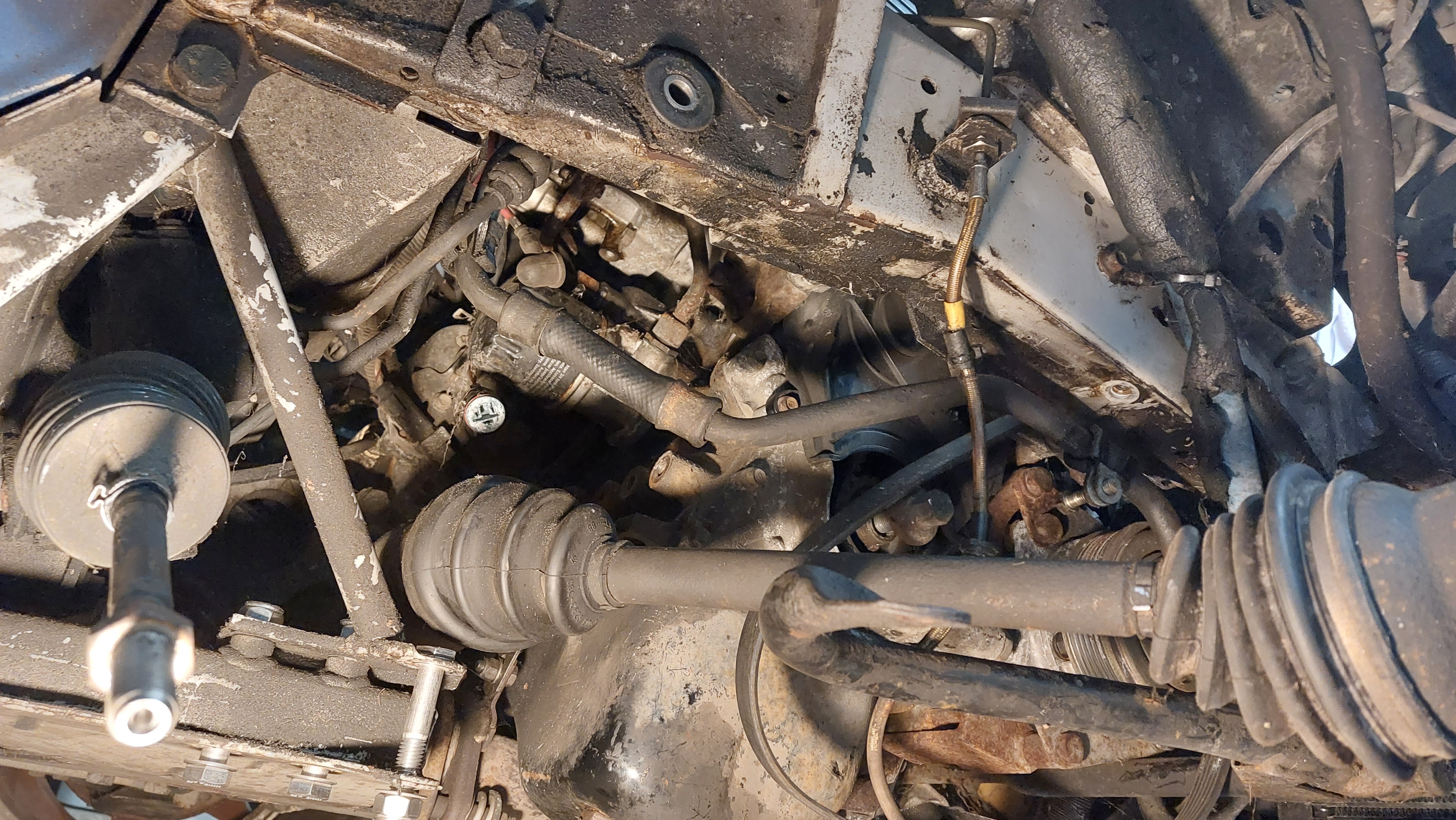

The NS suspension is in the process of renovation, but is broken down to it's constituent parts on the bench, so doing a bit when i don't feel like crawling under the car.
There was the usual worry trying to undo the bolts holding the exhaust front (down) pipe to the pre-cat housing dustbin - they always seem like they are really tight and are going to snap off, and being captive thread, there is no way to soak the nuts first - but a long swivel bar and a good socket using a steady pull, not a jerky tug got them all out, and once they had gone a turn, they could be undone with just fingers.
Getting to the sump bolts is straightforward enough - but I nearly forgot to actually drain the oil before taking it off - schoolboy error in my haste to get it done.....

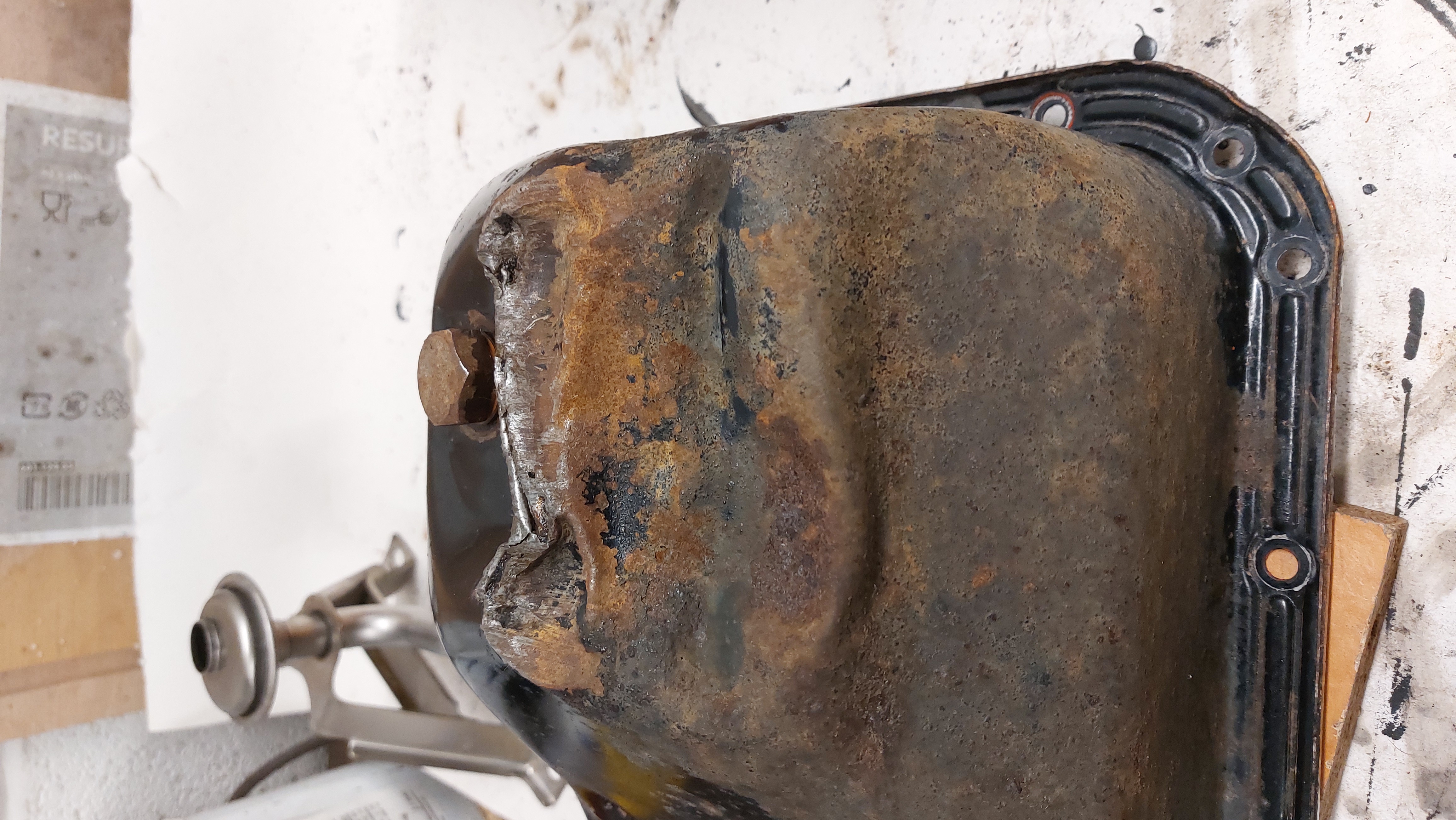

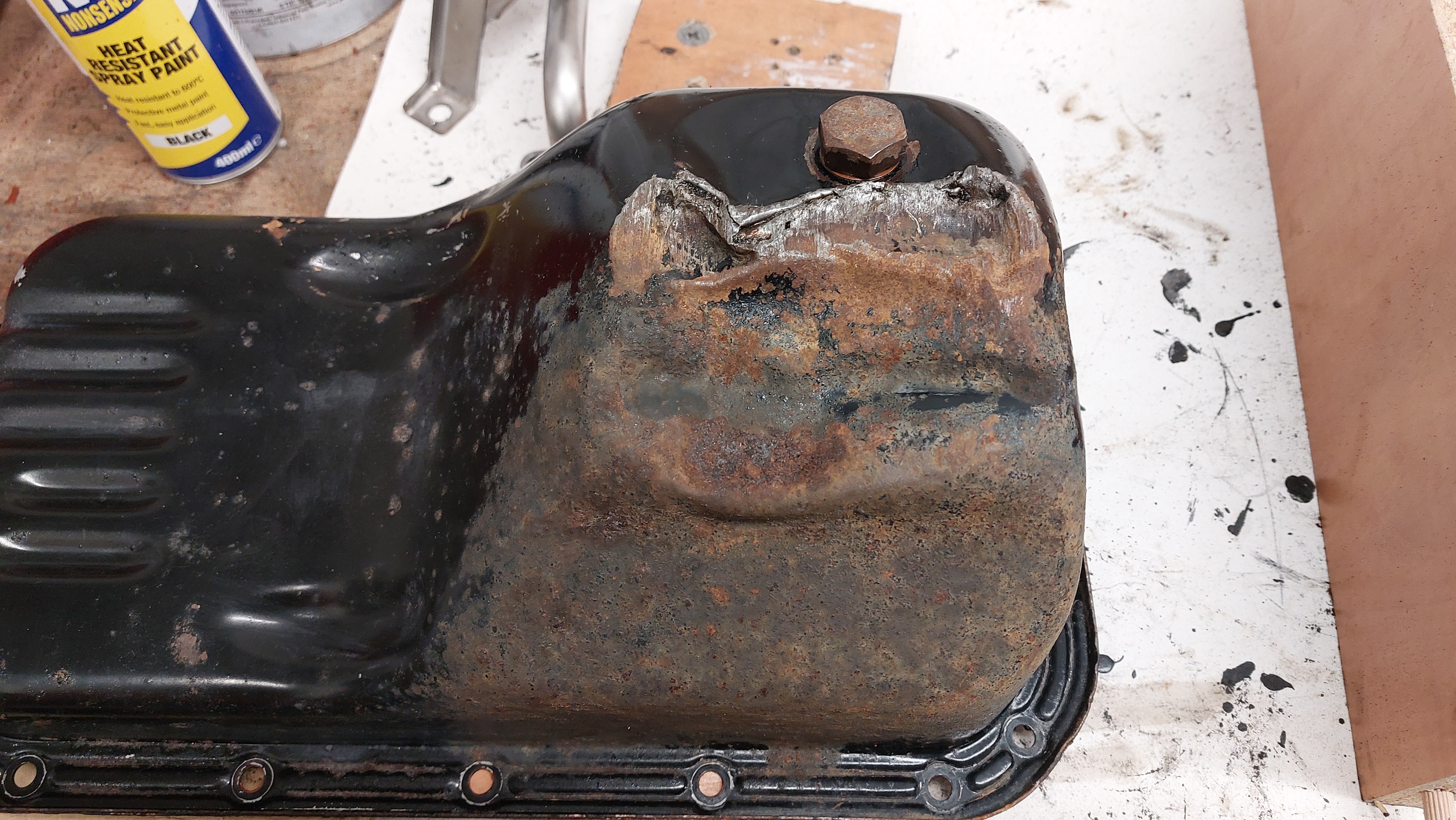

Postby dapinky » Mon 24.04.2023, 14:48

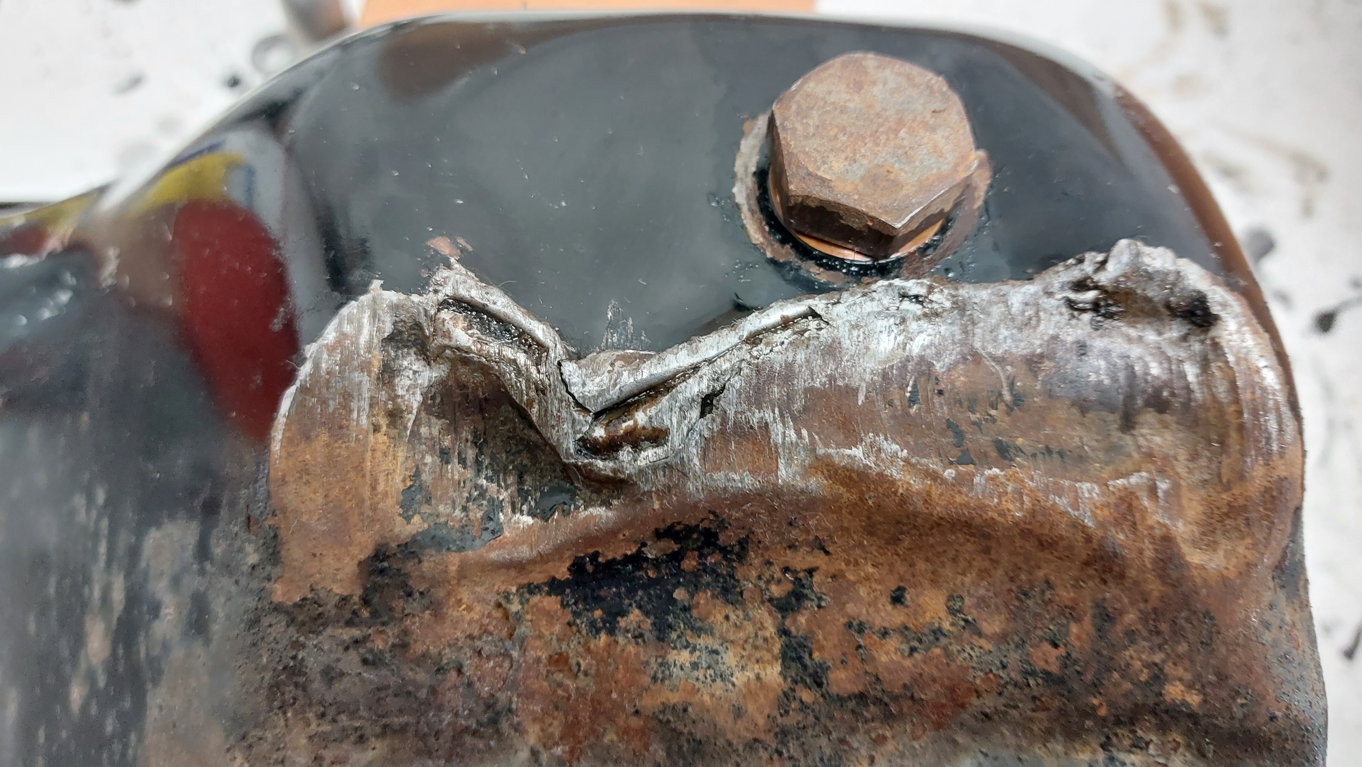

Well, looking at the sump, I'm not at all sure how it has remained oil-tight. The outside looks well bashed about, but the inner surface is completely intact (to my eyesight).
The plan is to clean it up to get all the crap out of the splits/cracks/folds and down to bare metal, then smack it about with a hammer and dolly to try to get the shape back to something like it should be (probably heating it up first to prevent any shock damage to the metal).
I hope to get away without any welding, but if I need to, I will.
If I can get away without it, I'll add a layer of Chemical Metal and maybe a thin sheet of metal to give it some support and (hopefully) prevent any future damage from vibration.
I'll dry it all off, then fill the bottom with paraffin or diesel which should find any gaps which I can't see - if all is okay, then a bit of preparation, paint and refit.
I'll also go off at a tangent and add a job of making up a sump guard like I have on my other car to try to prevent any future damage to the repaired item.

The issues with the battery light appears to be restricted to some of the aftermarket recon units.....
..... my unit is an aftermarket recon unit, but it was reconned in America (probably outsourced to Mexico though - most of the recon parts seem to come from there), so it is a completely unknown quantity.
I am not yet in a position to be able to think about starting the car, and need to get the sump refitted before I even consider whether to wait until it is back on the wheels, or keep it up on stands.
Whilst I quite like the idea of getting it running as soon as possible, common sense suggests that i put the parts back that I have removed first, otherwise I'll be off down a different rabbit hole and have even more irons in the fire.... Obviously, if it all simply fires up and runs, then it is job done - but as it hasn't run for 7 years, the chance of it being quite that simple is slim, and it will need a bit of fiddling with. I don't want to risk damage to the engine as any oil will have drained down in the last few years, so will remove the plugs and put a squirt of oil in the bores before turning it over to get the pressure up... so I may fit the new plugs and leads at that time - oh, how it all adds up when you think about it (that's why I try not to think too much, but just go with whatever feels like it should be next on the list).
