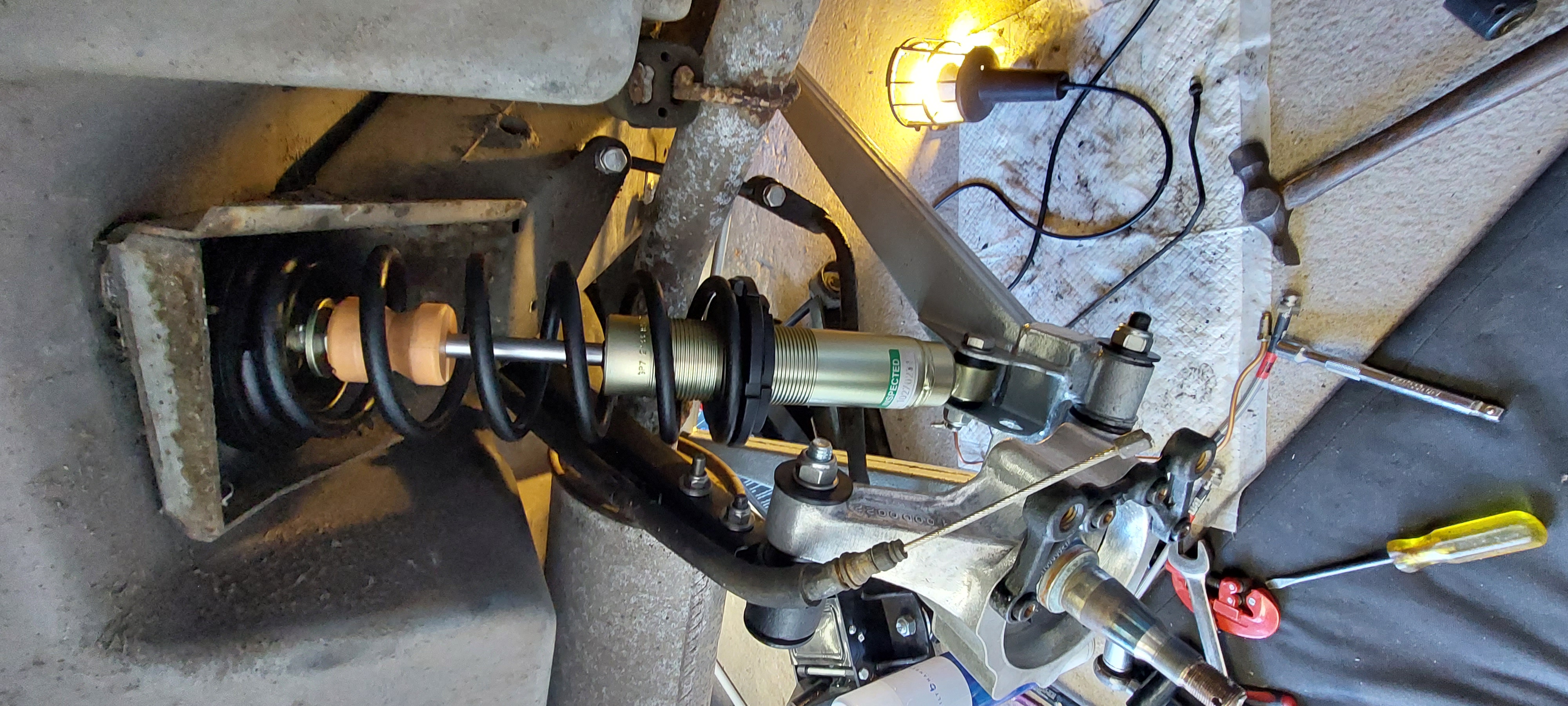

The suspension went on next, and took a bit longer than expected as the GAZ shocks were built up on the bench to the correct (ish!) ride height and when I went to fit them, the top rubber mounting had squished just enough to prevent it passing up through the hole in the chassis leg. No matter how I greased it and tried, it just wouldn't go - I had 3 choices - cut the hole bigger (No!), Trim a bit off the rubber bush (Also No!) or drop the spring platform to take the pressure off the top bush (a bit of a pain to do, but the only 'proper' way to go). It would have been nice if you can get spring compressors on whilst the shock is in situ, but mine are a bit chunky to do that.
Having fitted the shock, tightening down the centre shaft nut is easy, then winding up the base is a bit of a ball-acher with 'C' spanners as there isn't much room to get a good swing, so it's 1/6th turn each time, and it needed 21 full turns.
Then I had a bit of an epiphany (having knackered myself out doing the off-side one the hard way)... with the 3 top mounting bolts done up to prevent the shock moving, and before attaching the 2 halves of the lower yoke, it is actually quite simple to just rotate the whole shock body, keeping the platform stationary (actually, the spring pressure holds it, so you don't need to wedge a 'C' spanner in there anywhere). It can be done by hand, but sticking a screwdriver through the hole where the yoke attaches gives far better leverage as it gets tighter the more the spring is compressed. Doing it that way took about 3 minutes instead of the 30 minutes doing it the 'hard' way, and was far less physically tiring.
I rebuilt it with the same caster & camber shins as came off, and will worry about getting it correctly set at a later time. Obviously the whole lot needs to settle down before finalising the ride height, toe-in and camber/caster anyway, and there is no point trying to do it before the back end is done, then it'll be out with the string and spirit levels.

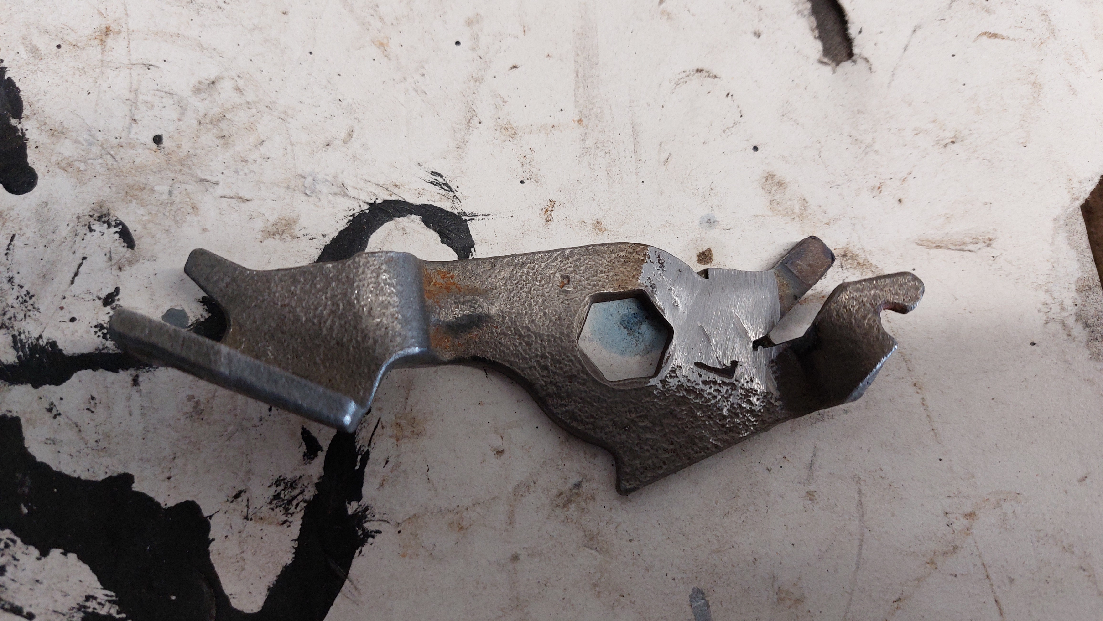

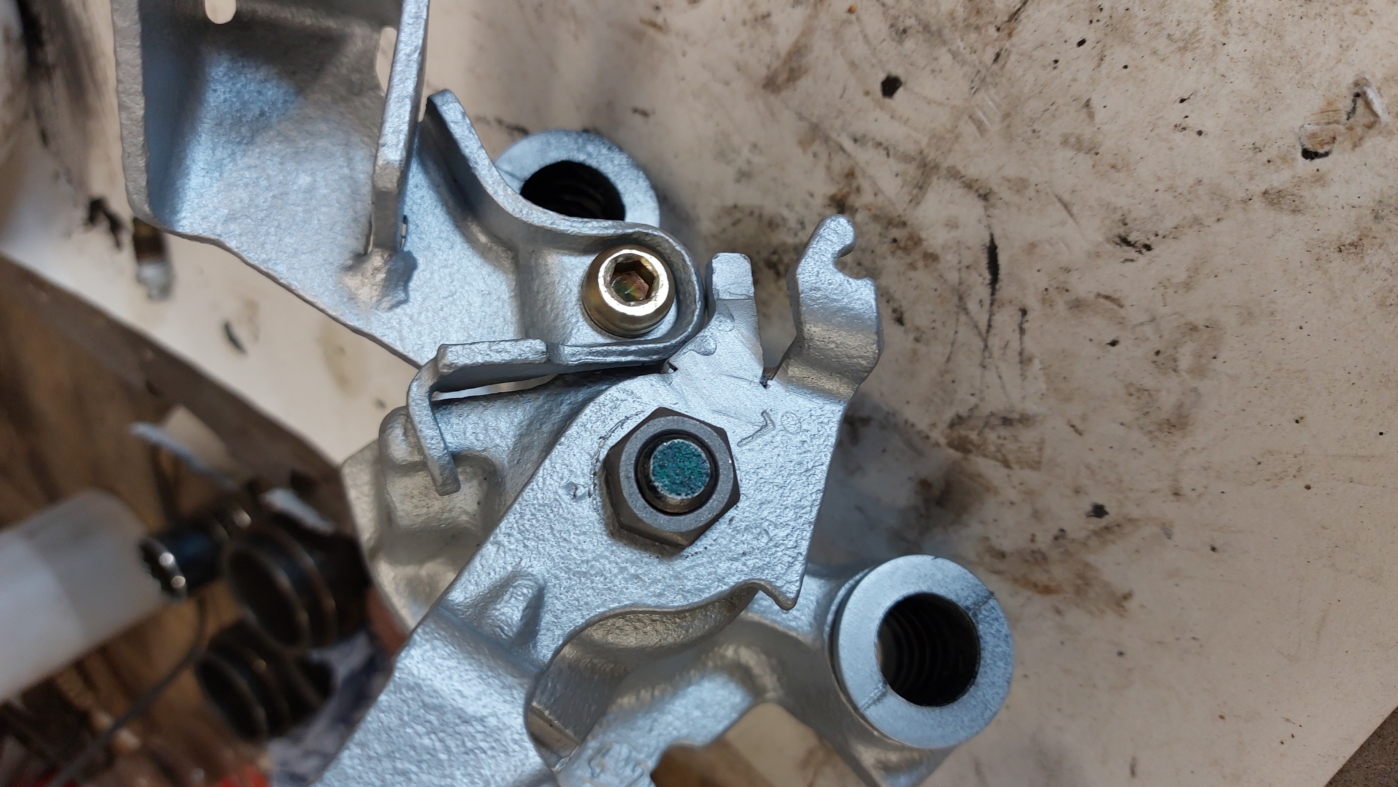

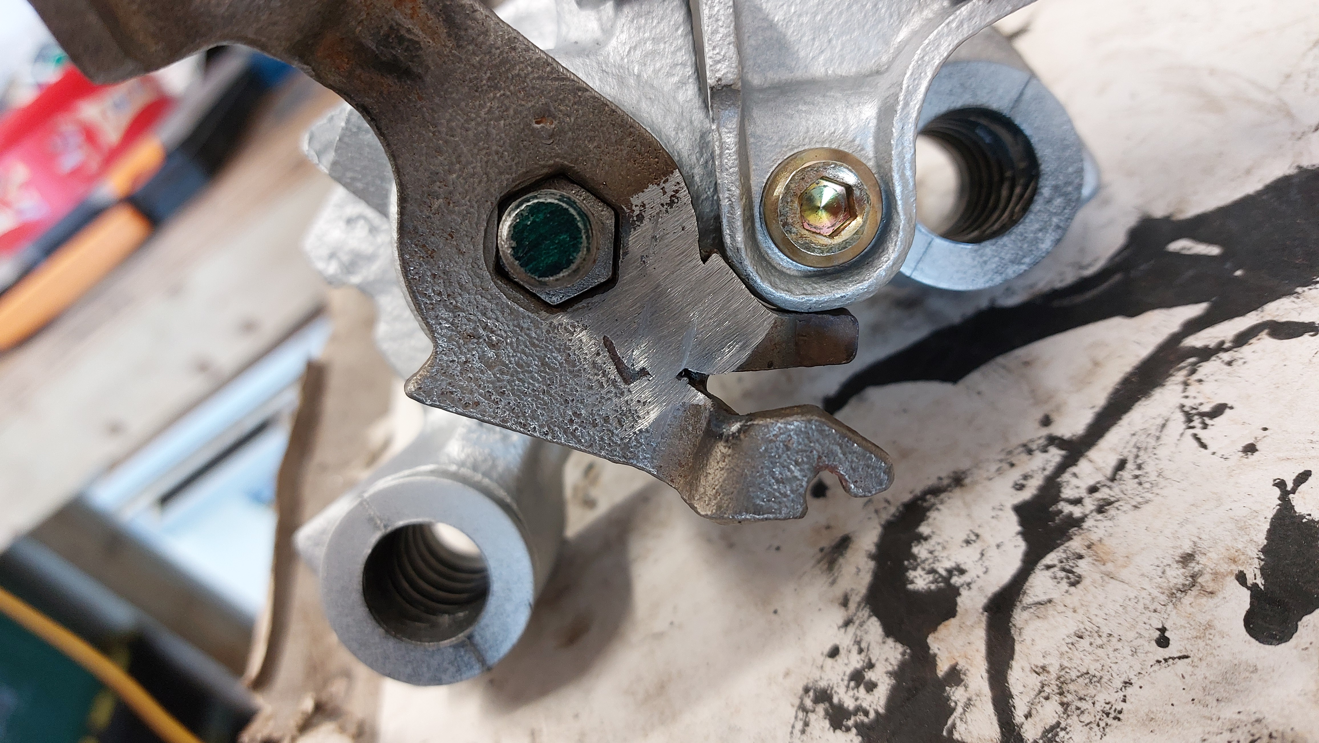

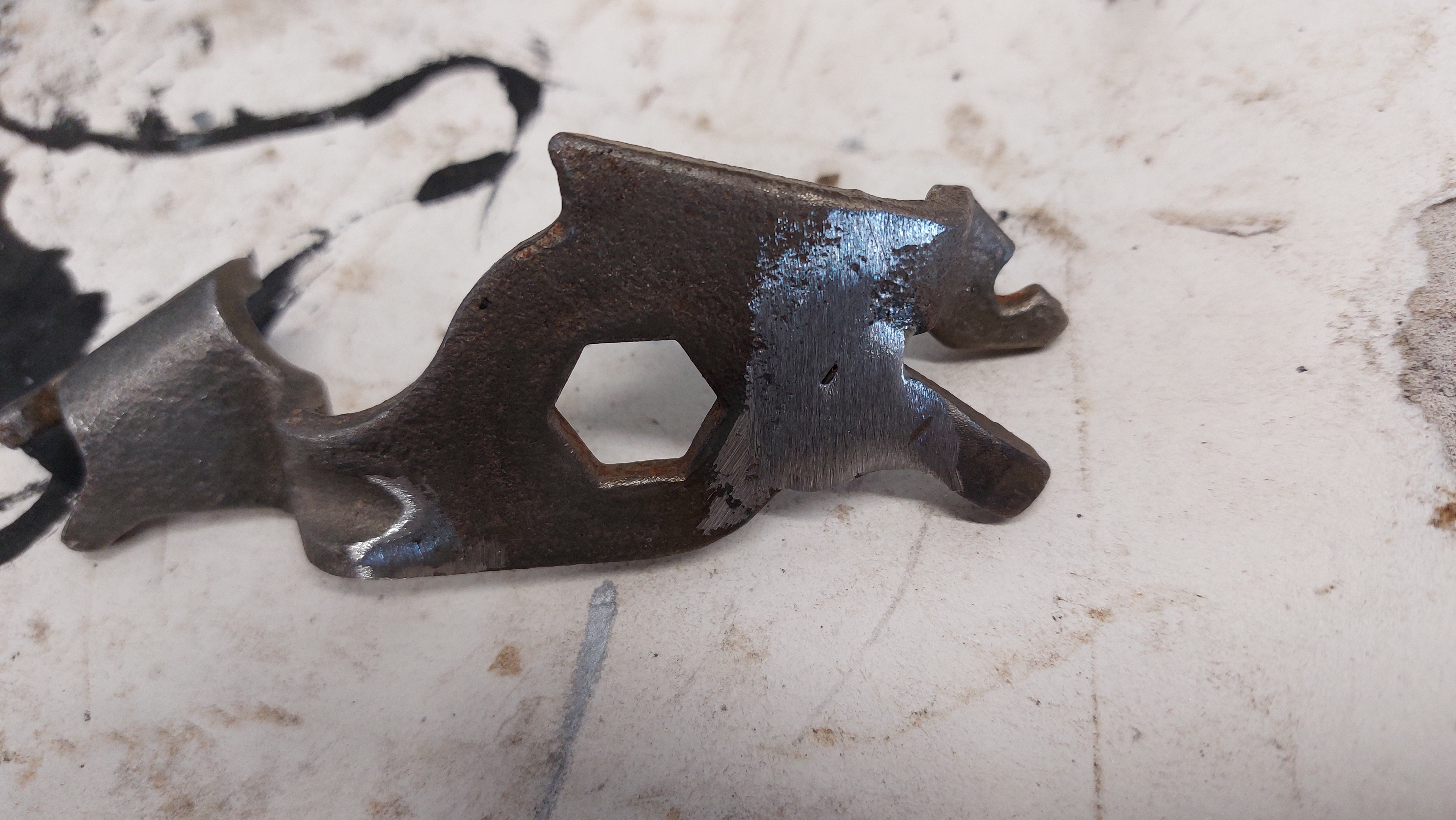

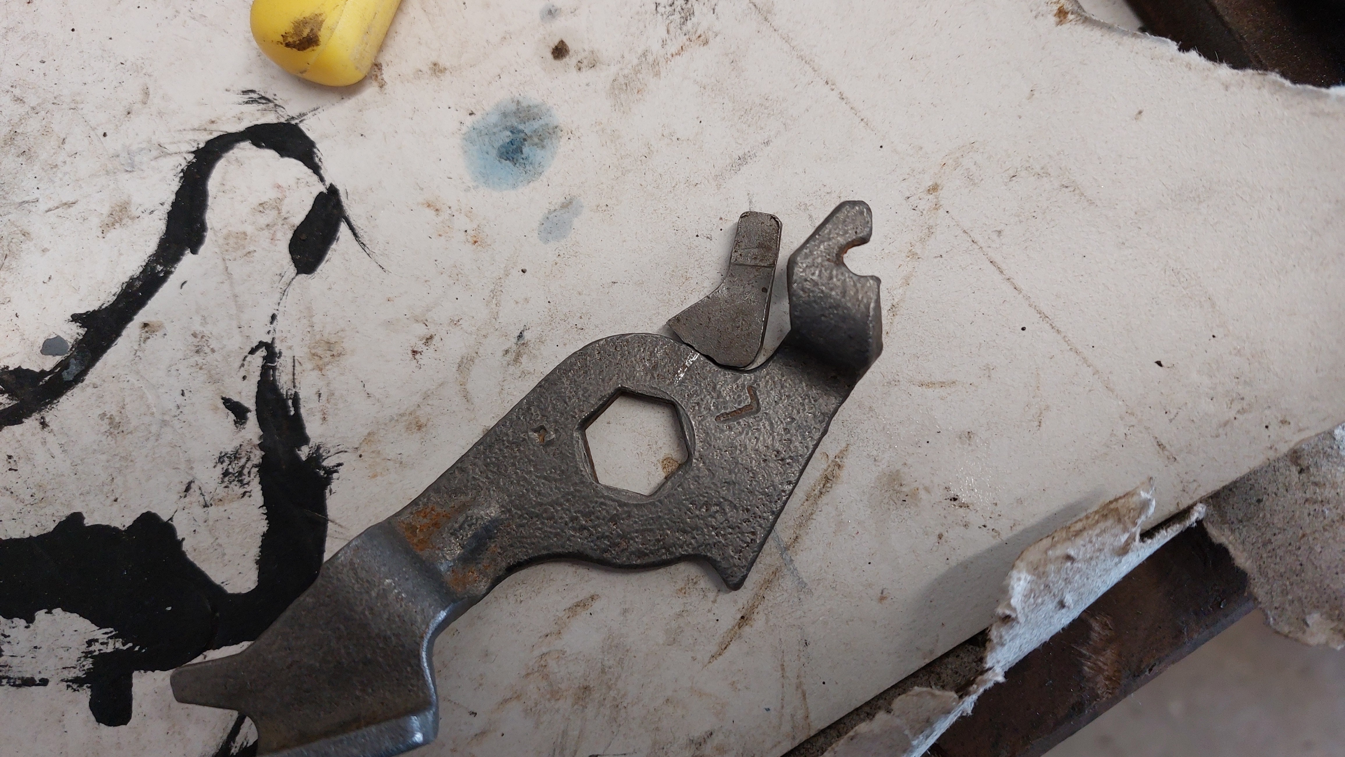

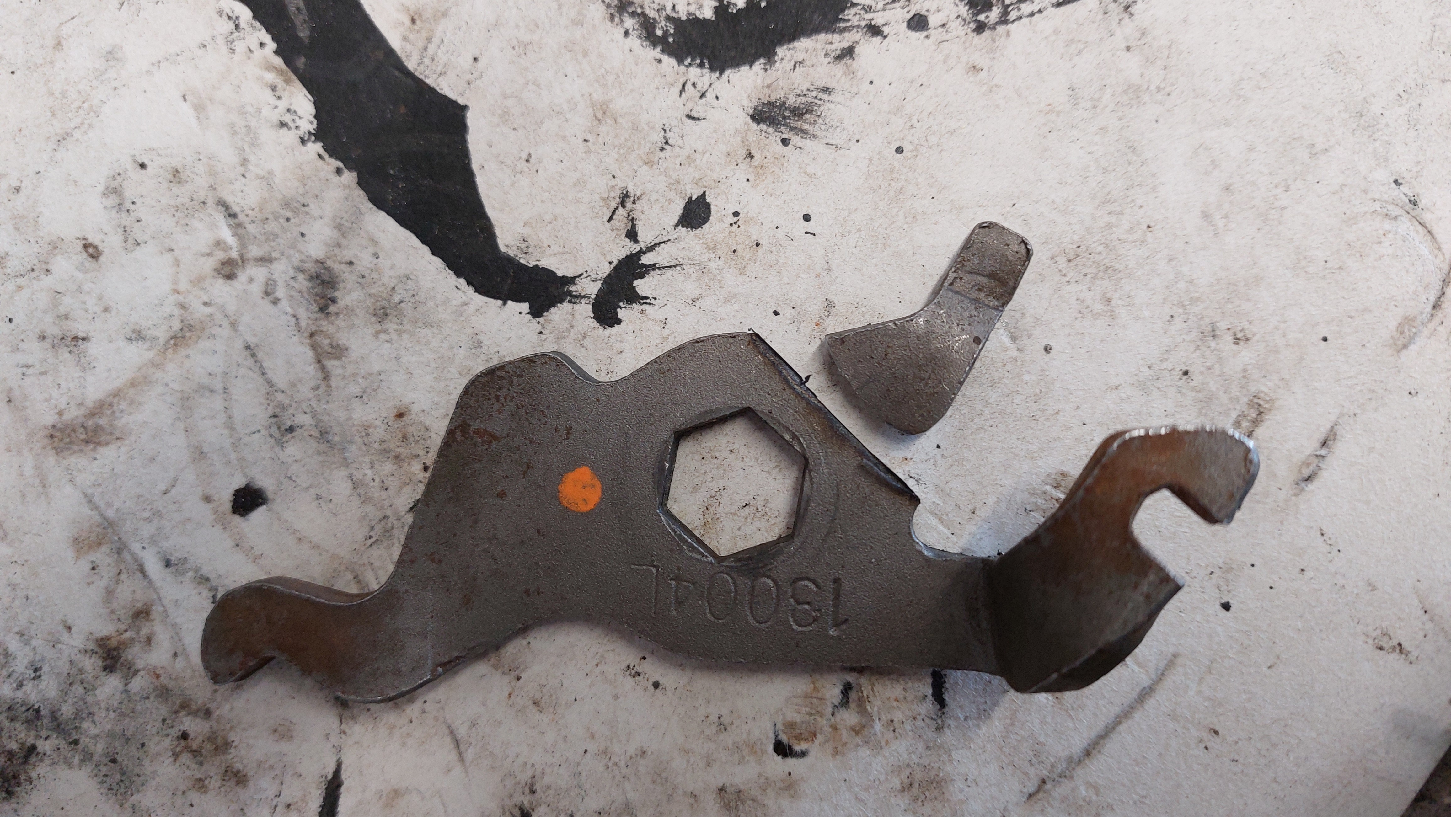

Well, in the process of doing the rear suspension, I took some pictures of the brake calliper lever that needs adjusting for use on the Rear-Right of the Elan (if using the 'stock' item as listed for the Oldsmobile Cutlass Supreme Rear-Left). I know that there is a 'pdf document somewhere on the website showing how the GM callipers needed to be modified to work correctly with the Elan (Jim :poke: :poke: ), but for the sake of filling this post up a bit, I modified my new one yesterday and it isn't at all hard...... this is posted on another thread about the handbrakes, but duplicated here just for the sake of keeping the info on my car in one place!!!!
It simply needs a bit of metal welding on to the old handbrake lever, so that it 'stops' when the metal hits the mounting bracket (so different to the Elan, where the stop is on the caliper casting), the same as the "wrong" lever already does.
I looked for a chunk of 5mm steel to modify, but then decided that it would be far easier to chop the relevant bit off the brand new lever which was going into the bin anyway, and weld it all together.
As always, a picture is worth 1000 words, so here you go:-
new lever, unused on the Elan - cut off the 'stop' part
fettle and adjust to fit the 'old' bracket you take off the Elan caliper
Weld it together
clean up the weld with a grinder
check it all fits (in fairness, I did check when I only had a single 'blob' of weld tacking the parts together, but didn't take a picture of that stage!)
all done, painted with zinc spray

Right-side completed, left side stripped, cleaned, painted in primer, some bits painted in top-coat......
.... will finish the painting today, then can start the reassembly tomorrow (hopefully).
I keep finding extra things to mess about with though..... like all the brake pipes...... oh, and swapping old rusty bolts for new stainless ones just for the hell of it....
Not the best photo in the world, and it shows the exhaust up a bit, and it was taken before the hub/disc and calliper went on, but at least it is all clean, tidy and corrosion free now.
Whilst I remember, I measured all the new Samco hoses and purchased all new stainless clamps for them.... not fitted any yet, and not intending to for a while, but thought it may be useful to publicise the hose diameters and clamp sizes required for them, in case anyone else buys a set (or needs to replace a single hose) and wants to have the right size clips on hand before starting....
Posts: 10621
Re: Angie's new car......
Postby dapinky » Sat 01.07.2023, 20:08
Good and bad today - but I suppose the 'bad' isn't really that bad, just a bit of extra work that i thought I had got away with.....
Both sides of the rear suspension are now refitted, just need to torque up the pivot bolts when I drop it down off the stands, however, it was all going so well, i wondered when something would go wrong.....

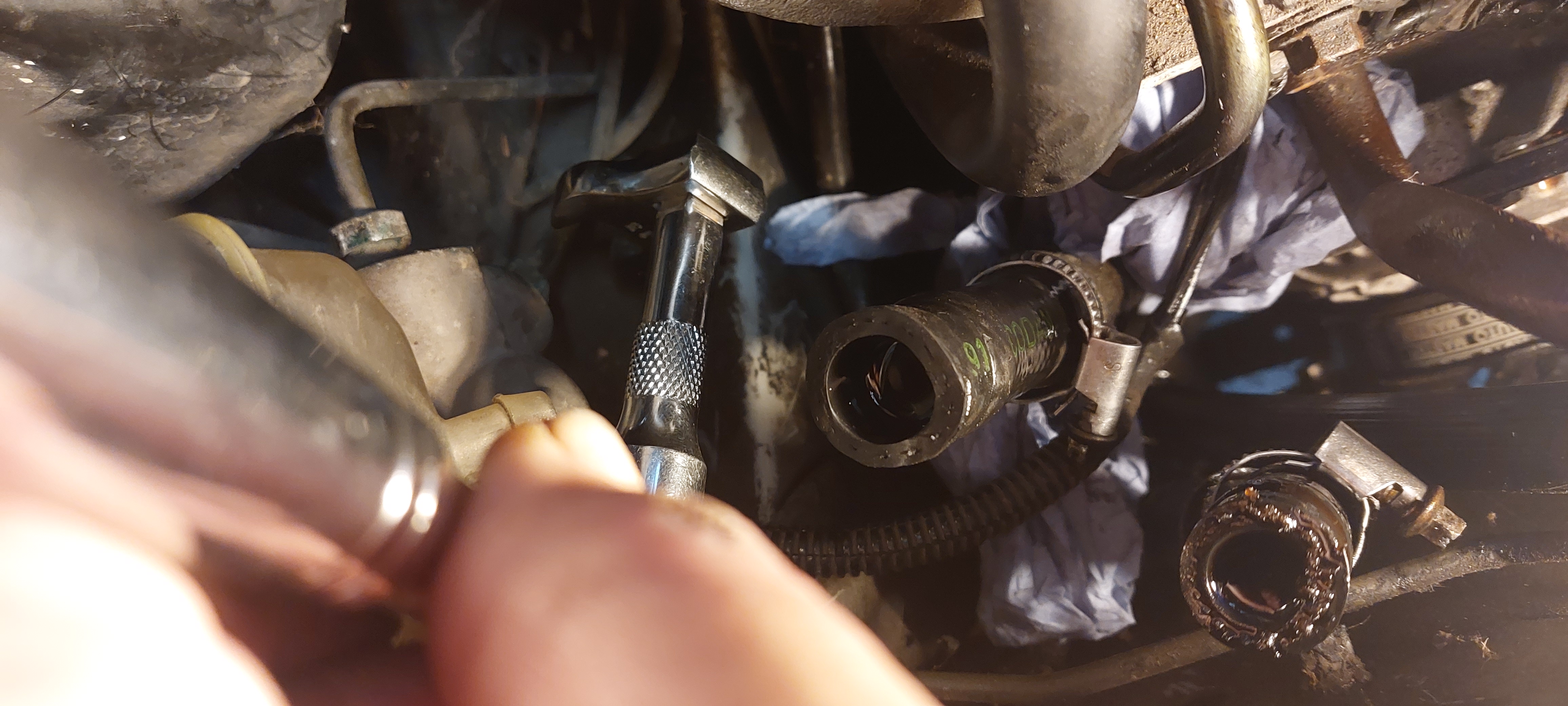

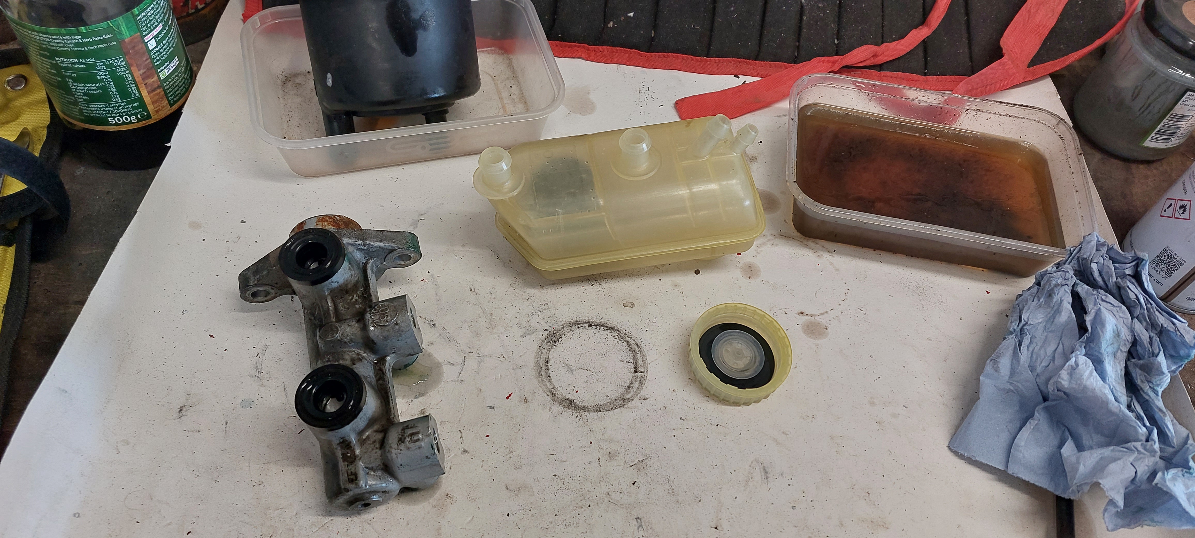

Following on from the above, I had a couple of hours to throw at the car this afternoon, so decided that I may as well make a start on removal of the master cylinder for when the new one gets here - knowing from experience that it is a job that is never easy, and never gets done the same way twice, and that it needs either a lot of luck, with flexible hands - or - removal of a few bits to gain best possible access.
It was with this in mind that I first removed the vacuum take-off/filter from the inlet manifold (otherwise it is really easy to snap off the plastic spigot, leading to a world of pain as they are NLA, so the options are to repair or find something that does the job...... far better to spend 5 minutes taking it out of the way.
Next is removal of the PAS reservoir - simply taking off the bracket will help, but removal makes it all a lot easier..... except that you get PAS fluid everywhere. It is possible to get the majority of the fluid out with a coffee syrup pump (or turkey baster), but there is always about a cupful left once it looks dry (false bottom on the reservoir stops you getting it all out). Then it is a case of undoing the 2 jubilee clips and trying to catch as much fluid as possible. I suppose, removal of the pipe at the pump would get the levels lower, but I decided not to do it that way (now I wish I had!).
That gives as good an access as you are likely to get without removal of either the inlet plenum, or the entire engine.

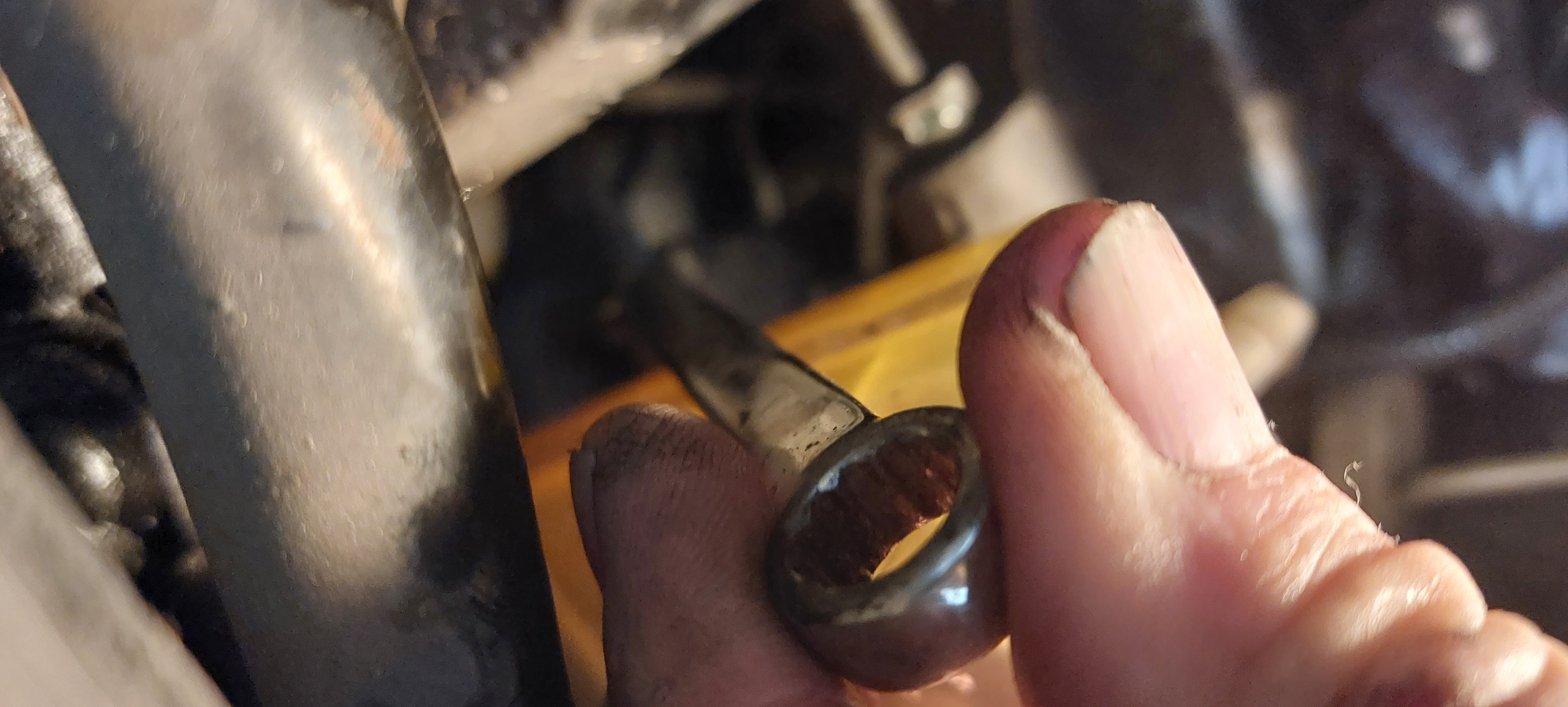

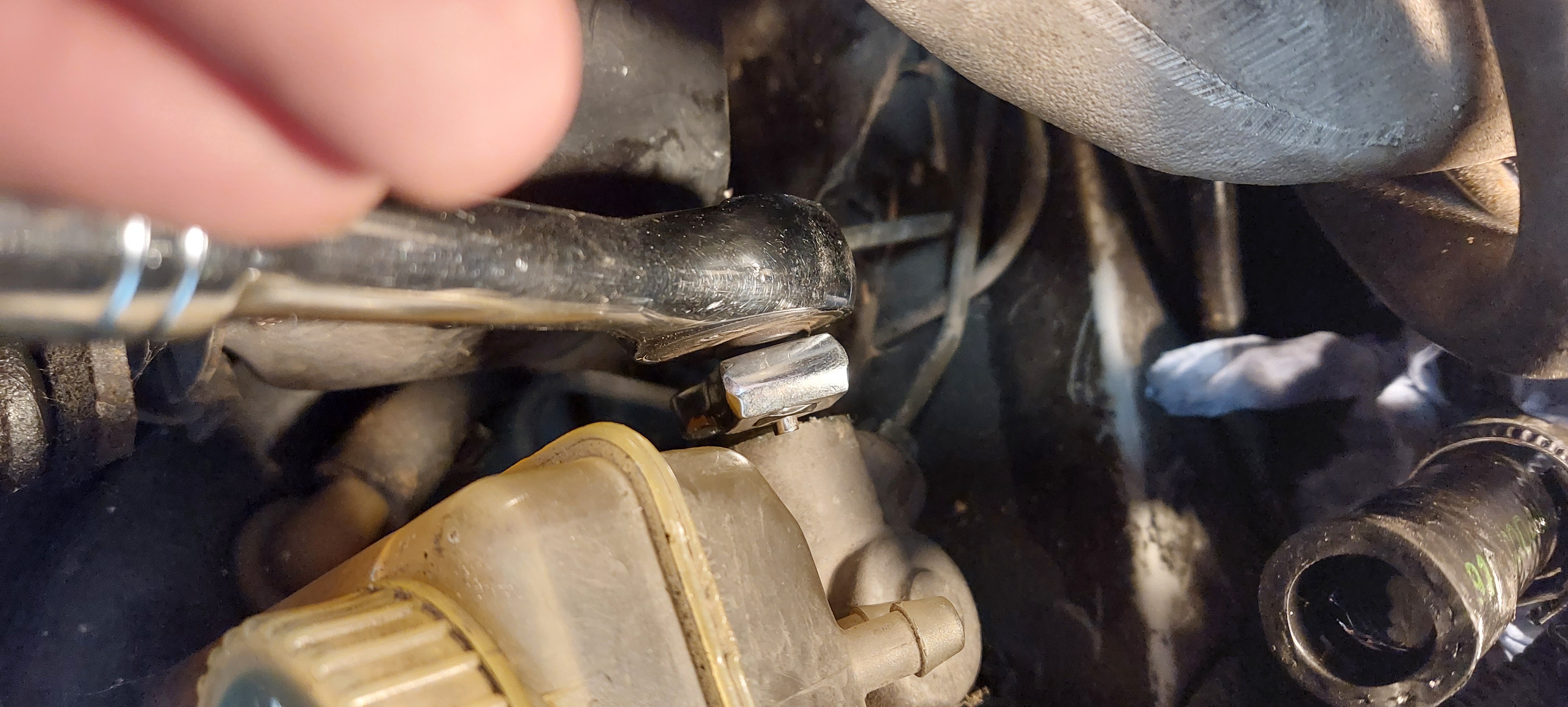

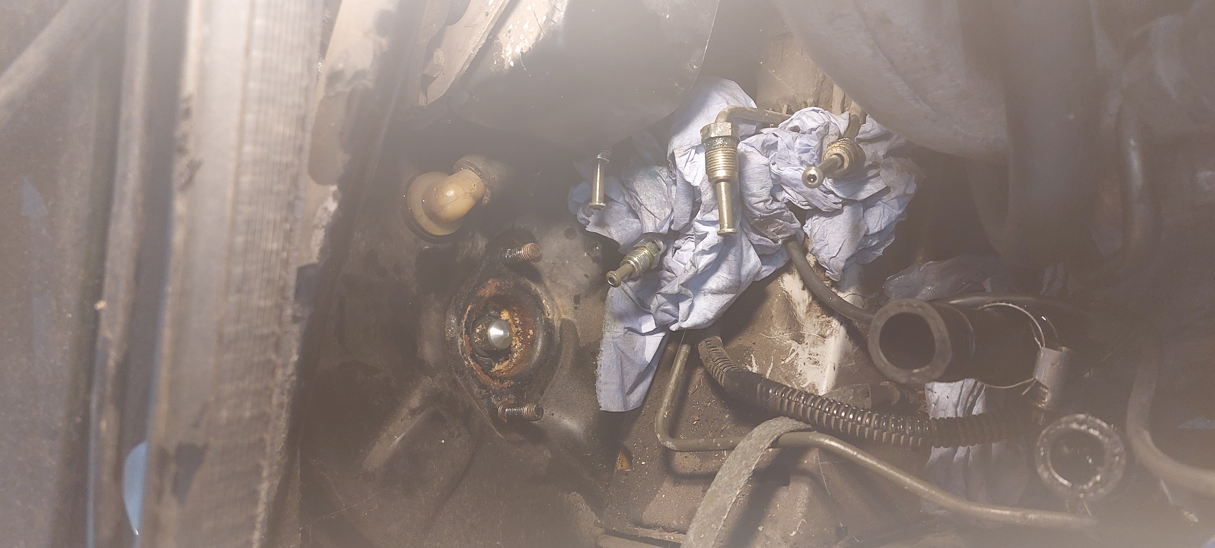

I then decided to just see how easily the brake unions would 'crack-off' before calling it a day.....
The front 2 are M12 fittings (requiring a 13mm spanner) and the rear 2 are M10, requiring an 11mm spanner..... no room to swing a spanner though (except for the rear upper one which you can just about get a spanner on if you're lucky, and the spanner is short enough to miss the engine, whilst still allowing enough leverage to undo the union - not a great combination of 'required circumstances')
My tools of choice are crow-foot spanners on a 3/8" bar - they are a bit thicker than a 'standard' spanner, so you get a better grip on the union without so much fear of it rounding off.
Ideally, you will remove the brake fluid reservoir from the cylinder first as it means you can see what you're doing, and get to the nuts easier - but for the photos I hadn't done that yet as I only took them to indicate the "angles of attack" for the unions which worked for me...... a selection of extension bars of various lengths means that you can better find a position where you can swing the ratchet handle, but none of them are perfect. Fortunately, once they are 'cracked-off' they came off with finger pressure.
Emptying the fluid is done with the syrup pump, but it isn't possible to get it all out, so expect some drippage when you take off the reservoir (or drain it from the union ports first), Don't forget to undo the electric connection for the level warning lamp - mine was secured to the master cylinder with a cable tie, and the plug/socket is away towards the centre of the car.... easiest way is to carefully lift the electric board out of the float in the reservoir and leave the wiring intact.
With the reservoir out of the way you can see (and get to) the 2 nuts which hold the cylinder to the servo, so it is time to remove the 3 loose unions, then you can undo the outer nut with a 13mm socket on an extension bar. The inner one is awkward to get to with anything other than an offset spanner (13mm) - but you may be able to get a crowfoot in there and a normal spanner once it is a bit looser - be aware that the nuts are 'k' nuts so won't be loose enough to undo with your fingers until they are nearly out anyway......so it's a case of move the nut 1/12 turn with a spanner. then repeat. I could get a flexible ratchet spanner on it, but couldn't get the angle to actually turn the nut, so it was the slow and steady process with an offset ring spanner.
The last connection is the lower rear M10 union, but with the other pipes pulled away (which is why you have to remove the cylinder from the servo first, to give enough room to separate the other pipes) you can get a crowfoot on it by replacing the cylinder back on the servo studs to hold it steady enough to crack off the union.
Then it's 'job done' - lift it out and mop up all the mess you'll have made!
This was the best angle I found to get the lower M12 union undone
Likewise for the upper M12
not much space to swing a spanner on the rear upper M10
all the bits out
.... anyone who's done this job knows what a sigh of relief you get to see this view.
.... and once it was all out and I was cleaning up the reservoir, I noticed how little angle you need to actually stop fluid flowing from the front chamber to the rear one...... so now I am wondering if the air getting into the system was purely because the rear of the car is on axle stands, and the angle of the master cylinder was such that the pickup from the reservoir was running dry enough to allow air in with 3 pumps of the footbrake????
Still, never mind, eh - a new Master Cylinder won't do any harm overall (and the rear of it does look a bit damp, so it may not have gone on very long anyway, if at all) - with a new one on the way for under £30 (plus some more PAS fluid!) it can't be complained about.
