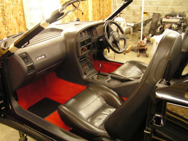

Yesterday consisted of fitting the new handbrake cable which allowed me to fit the centre console, also fitted the sill trims and the seats and then managed to fit the plastic trims and a new seal into the hood stowage compartment. Im holding off fitting the carpets into the hood stowage compartment until I fit the boot lid because I have to adjust the hinges to suit and one of the carpets is glued over the top of the hinge plates.

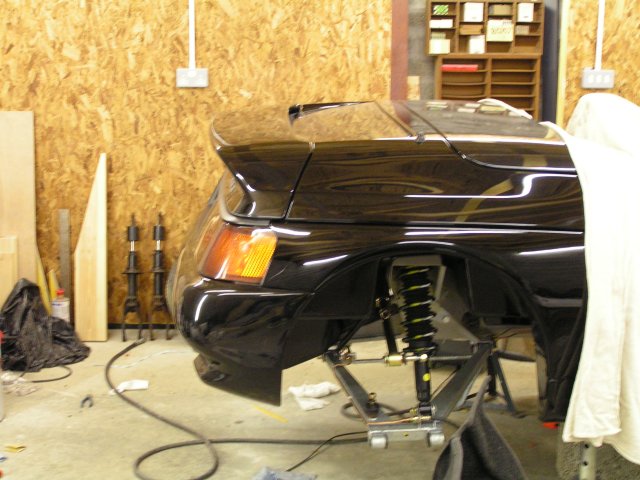

I spent most of the day today fitting the boot lid, rear bumper, rear lamps, no plate plinth, spoiler and hood stowage lid. It only took 2 hours to fit these parts and then another 10 or 12 hours to get them to fit so I had half decient gaps. There is no way they spent that much time at the factory getting the gaps right, I reckon most elan gaps have been tweeked by their owners or a local garage at one time or another. It was quite frightening to see the way the rear spoiler was sitting when I first sat it on the boot lid. A tip if anyone else has their back end in bits, start with the bumper and get it lined up with the rear wings, line the rear lamps up with the bumper, line the no plate plinth and brows up with the rear lamps, fit the boot lid, centralise and adjust height to suit plinth and brows and now fit the spoiler :shock:
:smt017
what the hell did I do with those plastic shims :roll:
If you get it to fit first time then your a lucky devil
Anyway I only tried on the bits now so once they are painted (hopefully this weekend) I won't have to handle them so much.

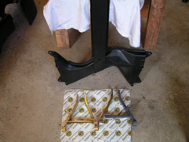

Here are the front upper wishbones I purchased from the surplus stock sale along with the progeron I bought prevously. Lotus must have a new policy of coating things in yellow passivative coating and cathodic black primer. Incedentially the yellow coating won't last long in this country and the cathodic primer should be overcoated.
You guys over in the states are so lucky with your climate!
Anyway, made good use of the spray booth last night and pressed the new bushes in this morning,should be painting some of the body panels today / tomorrow.

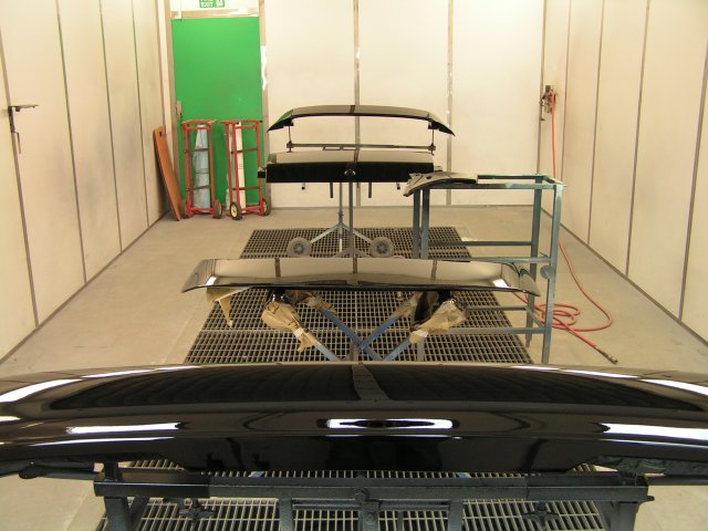

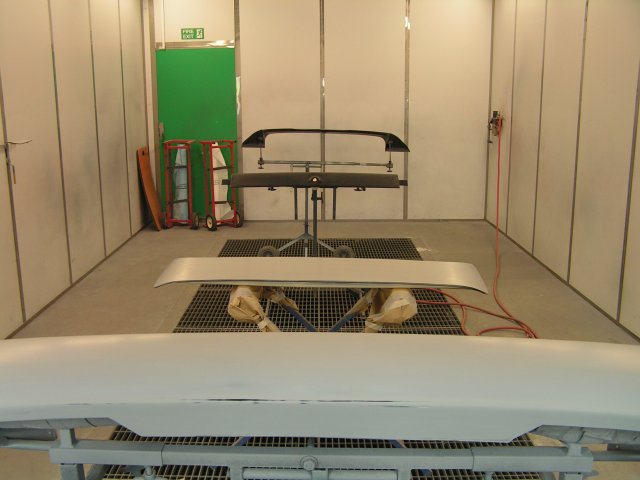

Postby jimbob » Tue 15.05.2007, 01:04
Got the bits painted at the weekend - boot lid, spoiler, hood stowage lid, rear bumper, fuel flap, and N/S A panel. Most of the parts have now been flatted and polished and are back on the car with exeption of the hood stowage lid + A panel, a job for the next lot of days off. Spray booth before and after pics enclosed.

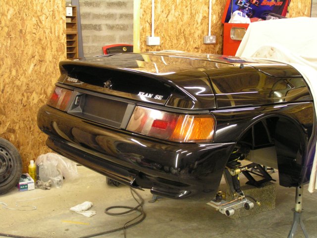

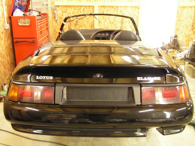

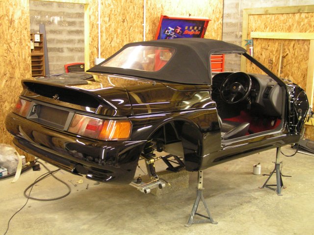

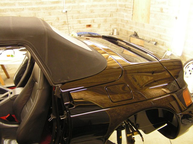

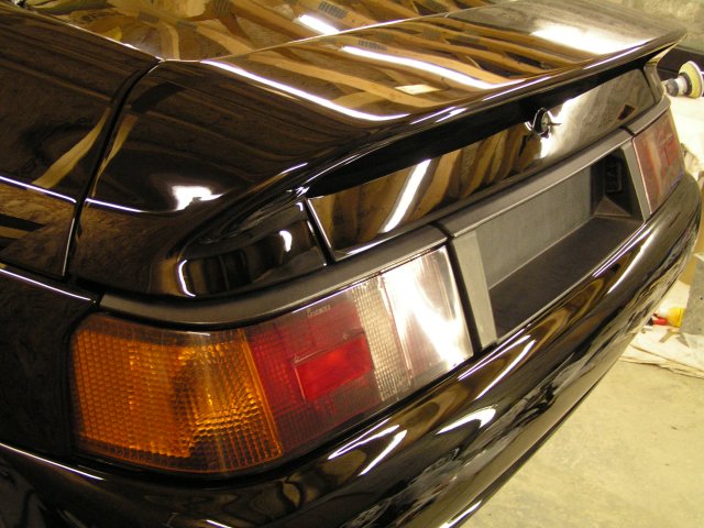

Postby jimbob » Sat 19.05.2007, 02:53
Enclosed pics of the finished back end, spent the whole of today fitting the soft top - a real pain in the ass job, but I have to say Im reasonably happy with its new fit and operation, don't fancy fitting these things for a living though. :smt101 Enough to drive you to drink.
Rear lights will be coming back off for a clean up and polish.

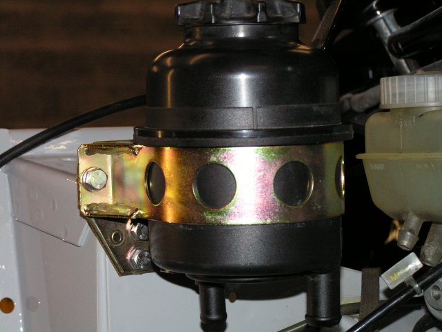

Oh, and another bit of factory bling that came yesterday for under the bonnet. :smt080
Starting to see light at the end of the tunnel!
Or is it the shine from the p/s tank bracket

Postby Ekapol » Sat 19.05.2007, 07:26
Very inspiring. Top rated! Way to go!

Postby Gazza » Sat 19.05.2007, 07:52
jimbob
If you are going to take the rear lights out, why don't you change the indicator lenses to clear ones.
They look excellent on dark cars.

Postby jimbob » Mon 21.05.2007, 02:59
Gazza wrote:jimbob
Gazza
Hmm sounds alright, but I want to keep things as close to factory as possible, with the exception of an upgrade or two under the bonnet. :wink:

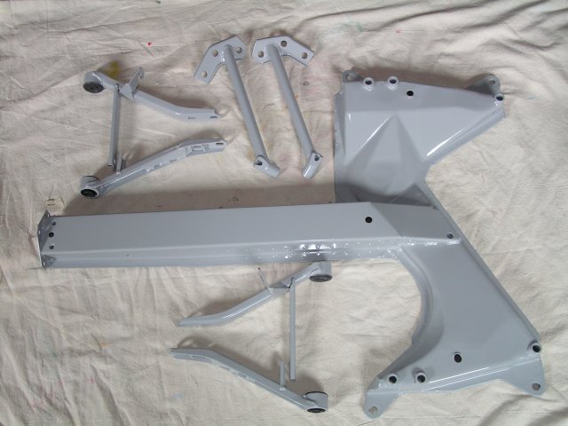

Today consisted of cutting the chassis up :shock: to be scrapped, after a little work with the measuring tape I discovered that the front bulkhead part of the chassis was back 20mm on the n/s. No wonder the n/s/f wheel appeared to be closer to the sill than the o/s.

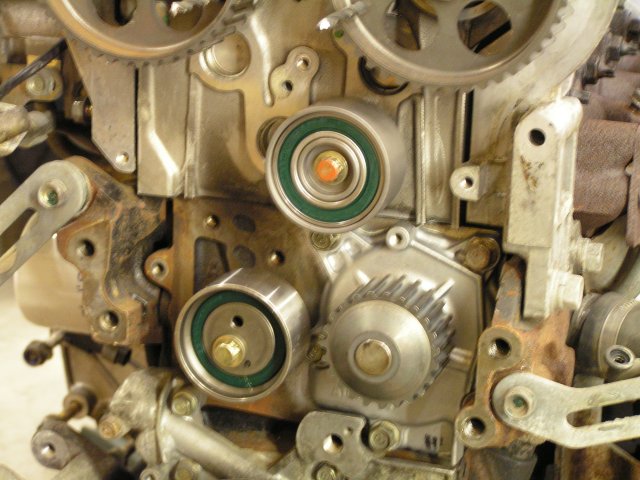

Started on the engine today also, fitted the new oe water pump and the cam belt idler and tensioner pulleys that came from the states. Also cleaned up the rear hub carriers and got my rear brake caliper brackets blasted and into primer.

New water pump and pulleys fitted. Note lotus special tools locking cams!!
