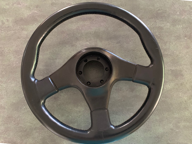

In other news: I recently saw a photo of the Fed steering wheels - man they are UGLY! And I can’t imagine a 30yr old airbag makes you feel much safer. I’ve got two of these, want one? I’ve got the centre for it too. I’ll post it over if you want it, none taken if you don’t of course.
I have three steering wheels... can definitely afford to reduce the number of spares!

Wow, that is really generous! Unfortunately, I don't think it is a straight swap. But if/when I get to that part of the rebuild I'll give a shout!

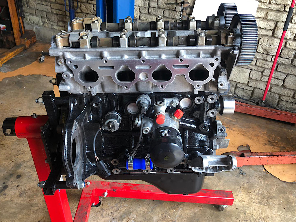

Looking good. By way of encouragement, here’s mine a few days further on (photo taken last summer)

Saltire - best photo I’ve seen of the back of the engine - can I please ask two questions?
1. My oil warning light still isn’t working although my pressure gauge is. I thought that the pressure sender / low pressure sender were one unit but they look like two on yours, is that right?
2. My Samco set does not appear to have that little blue hose, is that oil or water?

378S2 wrote:Saltire - best photo I’ve seen of the back of the engine - can I please ask two questions?
Yes, funnily enough I had no problem at all changing the oil filter; don’t know what all the fuss is about :lol:

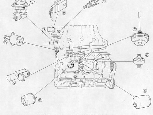

378S2 wrote:1. My oil warning light still isn’t working although my pressure gauge is. I thought that the pressure sender / low pressure sender were one unit but they look like two on yours, is that right?
On my car at least, the two oil senders are different:
Image courtesy of SJ Sportscars
378S2 wrote:2. My Samco set does not appear to have that little blue hose, is that oil or water
It’s not part of the Samco set; I made that little hose up from a spare piece of silicon hose because the original black one was FUBAR. In fact, I’d have preferred to use black, but I had some blue of the right diameter, and I was too parsimonious to pay for a metre of the black :roll:

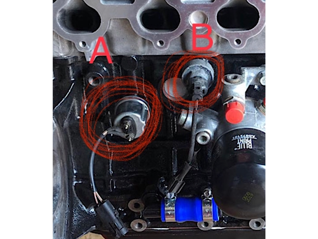

Ah, I think I misunderstood.
A) is a pressure transducer and low pressure switch in one unit?
B) is the knock sensor?
And the blue hose is the oil separator return (not coolant)?
For the life of me I can’t get a hand to A from above. I’ll tackle it when I start work on the Samco / Brake refurb this winter.
21 = knock, 23 = oil pressure

Sorry, only just noticed your comment. Correct in all particulars
