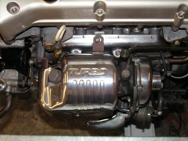

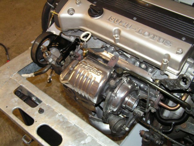

Got the ex. manifold and pre-cat back from the blasters and then coated them, fitted new studs in the manifold and the bottom of the pre-cat.
I spent the other night breaking a sweat removing the bits of stud which were left in the turbo and re-tapping the threads, new studs fitted now - I'm glad thats done now! (see new thread r.e. turbo nuts in X-ref thread)
One point you may want to note, the 3 studs on the bottom of the pre-cat are M10 metric on one side and M10 metric fine on the other, this gives nothing but grief when trying to locate nuts for your exhaust downpipe. I changed them for plain old M10 metric studs so the nuts are commonly available.
Also ported out my turbo wastegate to 20mm - Roll on peco!
Another point maybe worth mentioning, the turbo coolant pipes and oil feed pipe all have coppper washers, they seem to be real odd-ball sizes, may be worth getting well in advance for all the cost because I wasted half a day of running around looking for them.
Dip s**t tube bracket and engine hangar bracket really bugging me! Where does it end?

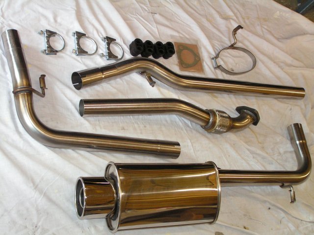

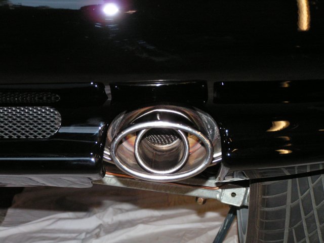

Peco Stainless exhaust came today should be interesting to see if its a good fit. :shock:

Postby paulwatkins » Tue 19.06.2007, 18:11
Jim,
A bit of friendly advice before you fit the peco exhaust; Check that the inner pipe (the round one within the oval piece) of the very last section is securely attached.
Mine fractured and I found it loose within the oval pipe. It's not able to come out completely, but I have now had to wedge it back in! :shock:
Peco will take it back and repair/replace but I've agreed I wont do this until I take it off the road for the winter.
Yours is probably ok, but its just a 2min check.

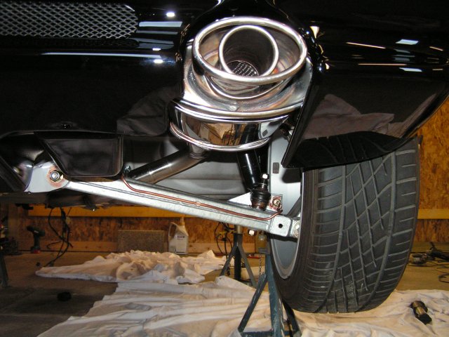

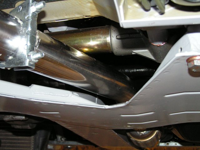

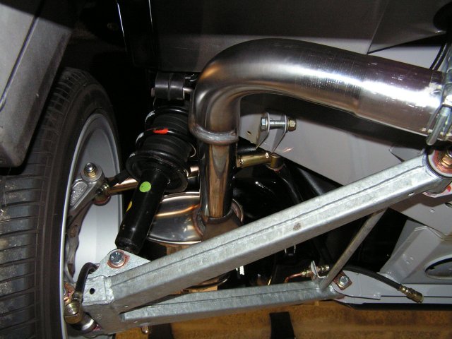

Postby jimbob » Tue 19.06.2007, 20:56
Well I got my peco fitted this afternoon, its not a bad fit considering its not factory, at least there's no squish. A couple of points to note, clearance to rack is tight, I had to swivel second section round a bit so down pipe would clear rack. The other thing is the hanger bracket on the front of the back box could do with a little heat and persuasion to bring it back in line with the bracket above it, apart from that its spot on :smt023
Oh and last but not least MY ENGINE GOES! :banana: and everthing electrical which is on the car seems to work ok - so far so good !
Tight to rack (7mm) but thats better than burnt paint on prongeron!

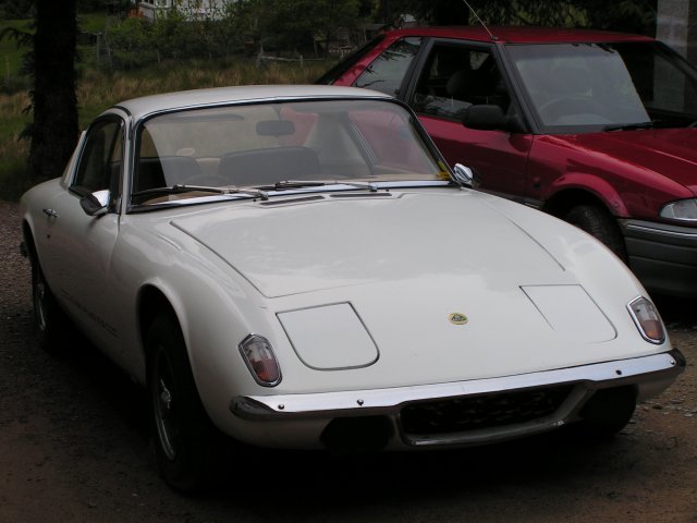

Postby Doug » Wed 20.06.2007, 06:38
Jamie, do you have a link to some pics of your 1970 Elan? Would like to see it.

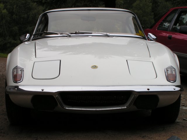

Postby jimbob » Fri 22.06.2007, 20:36
Doug wrote:Jamie, do you have a link to some pics of your 1970 Elan? Would like to see it.
Hi Doug, this is the car that started the Lotus/glassfibre car fascination off for me. My grandfather bought it in 1970 and has been in our family ever since, sadly he passed away in 2002 and it has been passed down two generations to me. So this is more than likely the next project - full restoration. I'll maybe leave it a year or two though, to get a chance to recover after doing my se. This car has quite a good novelty factor in that there is a photo of me less than six months old in my pram sitting next to it - not many people can say that!!

Postby Doug » Sun 24.06.2007, 06:00
thanks, Jamie, the white Elan is beautiful already! what a nice garage photo the pair will make when Blackie is done.

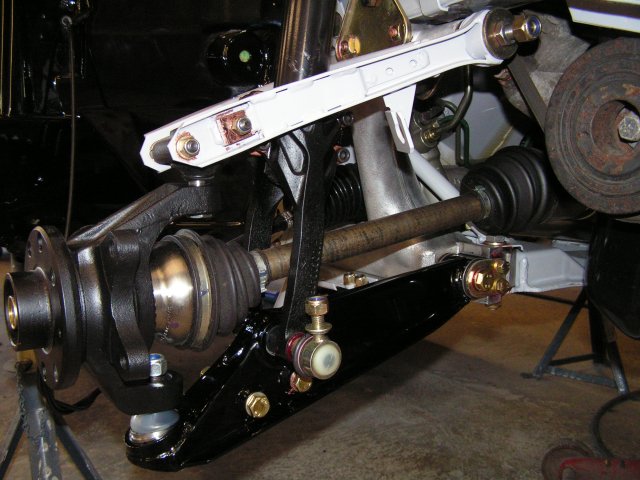

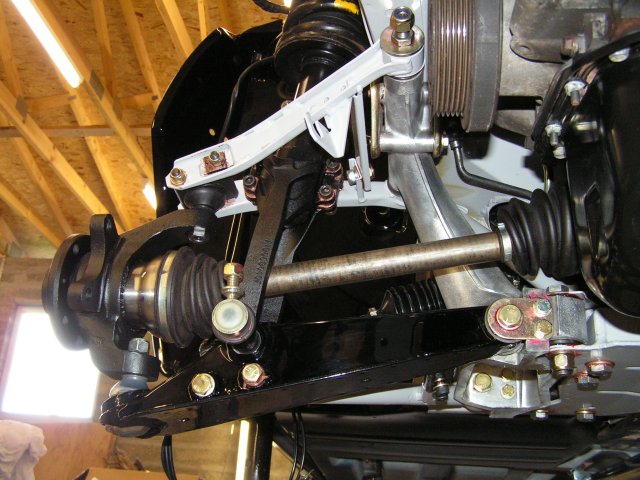

Finally got the T.C.A.'s painted and the bushes fitted and now they are going on the car.
