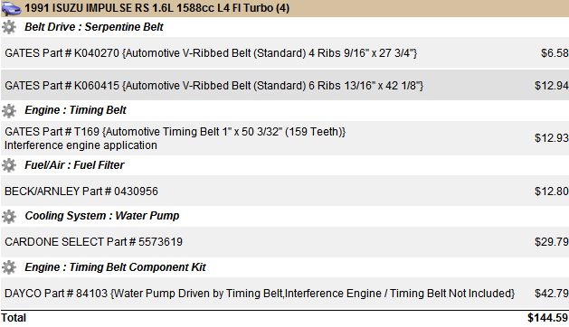

Postby lotos » Mon 03.11.2008, 19:37
Doug wrote:get a back-up cam angle sensor (if you can find an Isuzu one at a dealer) or new hall sensor replacement for it from the Lotus sales list
I assume you're talking about this:
Elan M100 A100E6570L ****HONEYWELL HALL SENSOR(F/W) 973 N/A 12.77
My list is being sorted now... At Rock Auto it's running about $145 (I attached the cart) - can you folks look this over and make sure it is correct? I'll also be getting the Heater Valve as people mentioned. Then I'll be placing an order for the hoses... and should be okay for a while? Pricey first month :)

Re: Mellow Yellow
Postby lotos » Wed 05.11.2008, 22:08
Just wanted to bump and see if you folks could take a peek at my shopping list and let me know if it looks kosher? I want to get this junk out of the way so I can drive without praying to all possible gods first :lol:

Re: Mellow Yellow
Postby rip » Thu 06.11.2008, 00:39
Hall sensor - correct
TIming belt - correct
Timing belt component kit - correct
Water pump - don't know because I ordered a different brand.
PAS/Alternator belts - not sure because I got my order wrong :? & my Elan does not have air con like most of the US ones.
Fuel filter - don't know. This may well be different to the Isuzu Impulse since it not housed around the engine.
Re: Mellow Yellow
Postby Doc Fizzix » Thu 06.11.2008, 01:15
rip wrote:Fuel filter - don't know. This may well be different to the Isuzu Impulse since it not housed around the engine.
:smt017
I am also not sure if the Isuzu one is the same. I know it was a GM part and I bought mine down at the local auto parts store

Postby tweetdriver63 » Thu 06.11.2008, 03:56
rip wrote:Hall sensor - correct
All of the belts are common between the Impulse and Elan. My Elan has all new belts on it, and they all came from the local parts store listed for the Impulse. There's a Wiki cross reference by vehicle model. If you find anything that isn't listed there yet, please add it, or get somebody else to.

Re: Mellow Yellow
Postby lotos » Thu 06.11.2008, 05:24
Thanks everybody - I want to get this order in ASAP so I can get rolling again.
