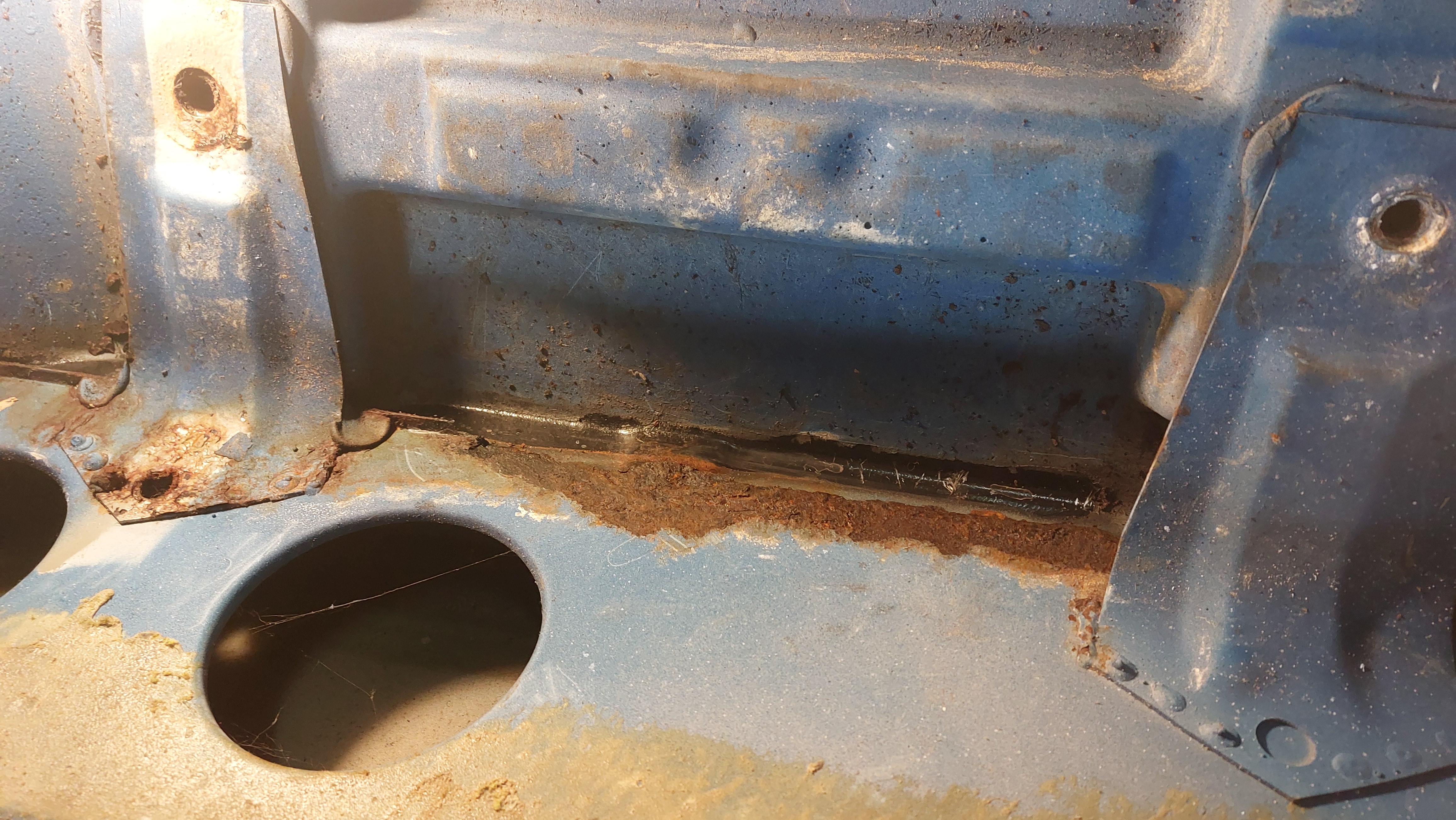

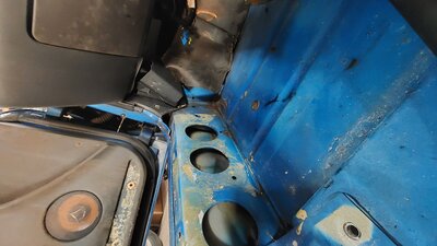

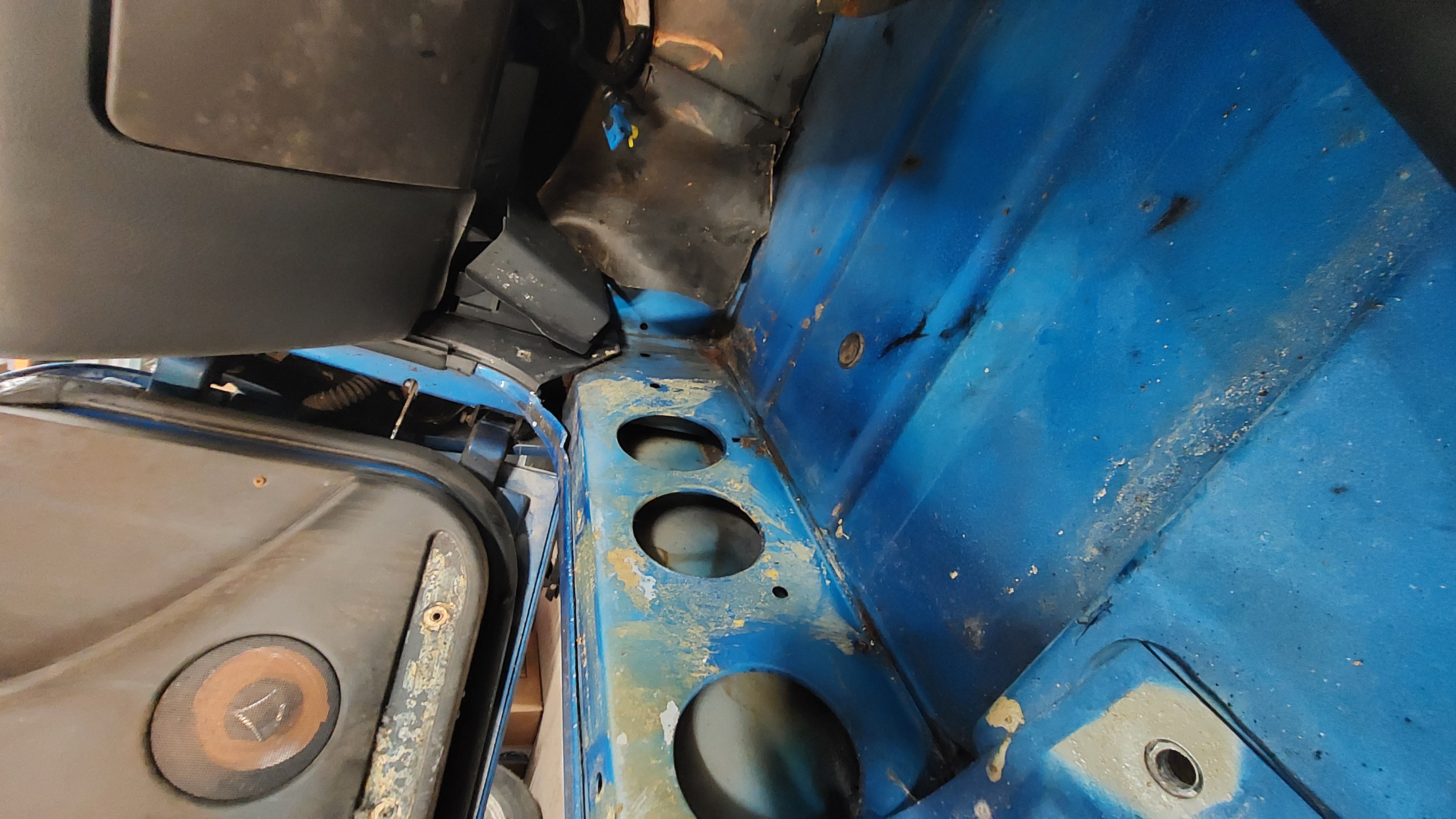

The passenger side was far wetter than the drivers side - and the underfelt had done it's best to soak up 6 Winters' worth of rain and hold it against the metal outriggers - still, no good sticking my head in the sand - it has to be addressed......
...... so, I removed the sponge and about half a gallon of rainwater came with it - and I was presented with this sight.....
......well, you'll have to wait for it, because the Forum is broken (again) at the moment and won't let me upload pictures - but you can probably guess what it looked like :?
Ah well, a bit of work to do.

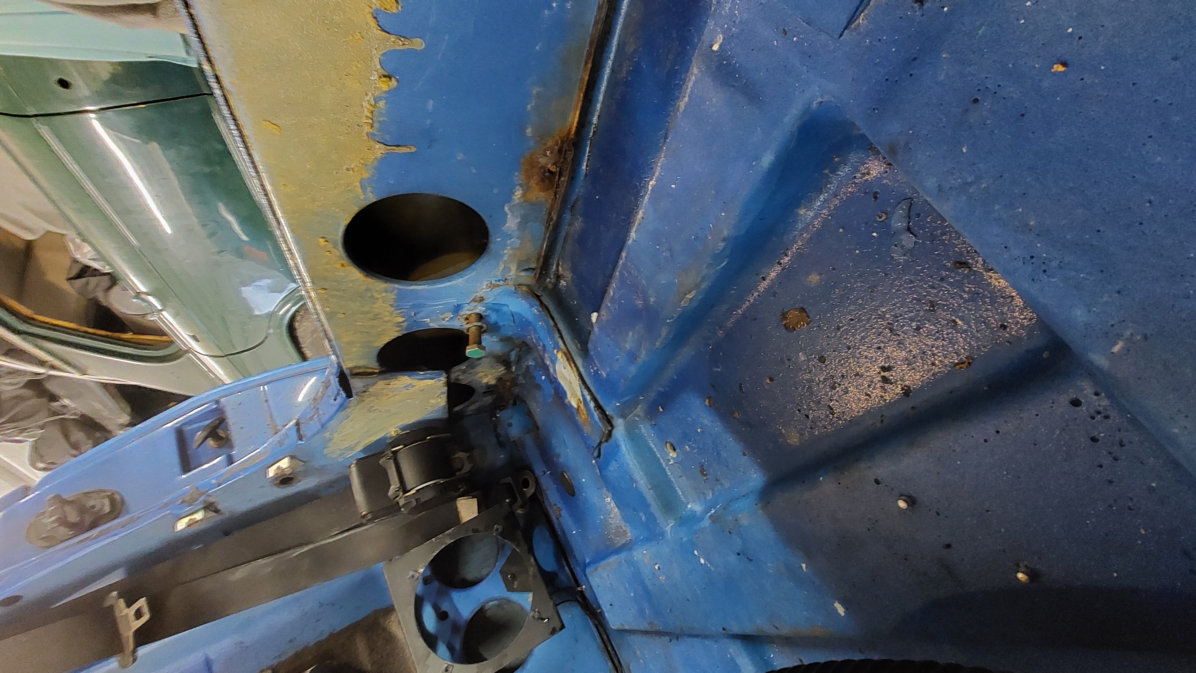

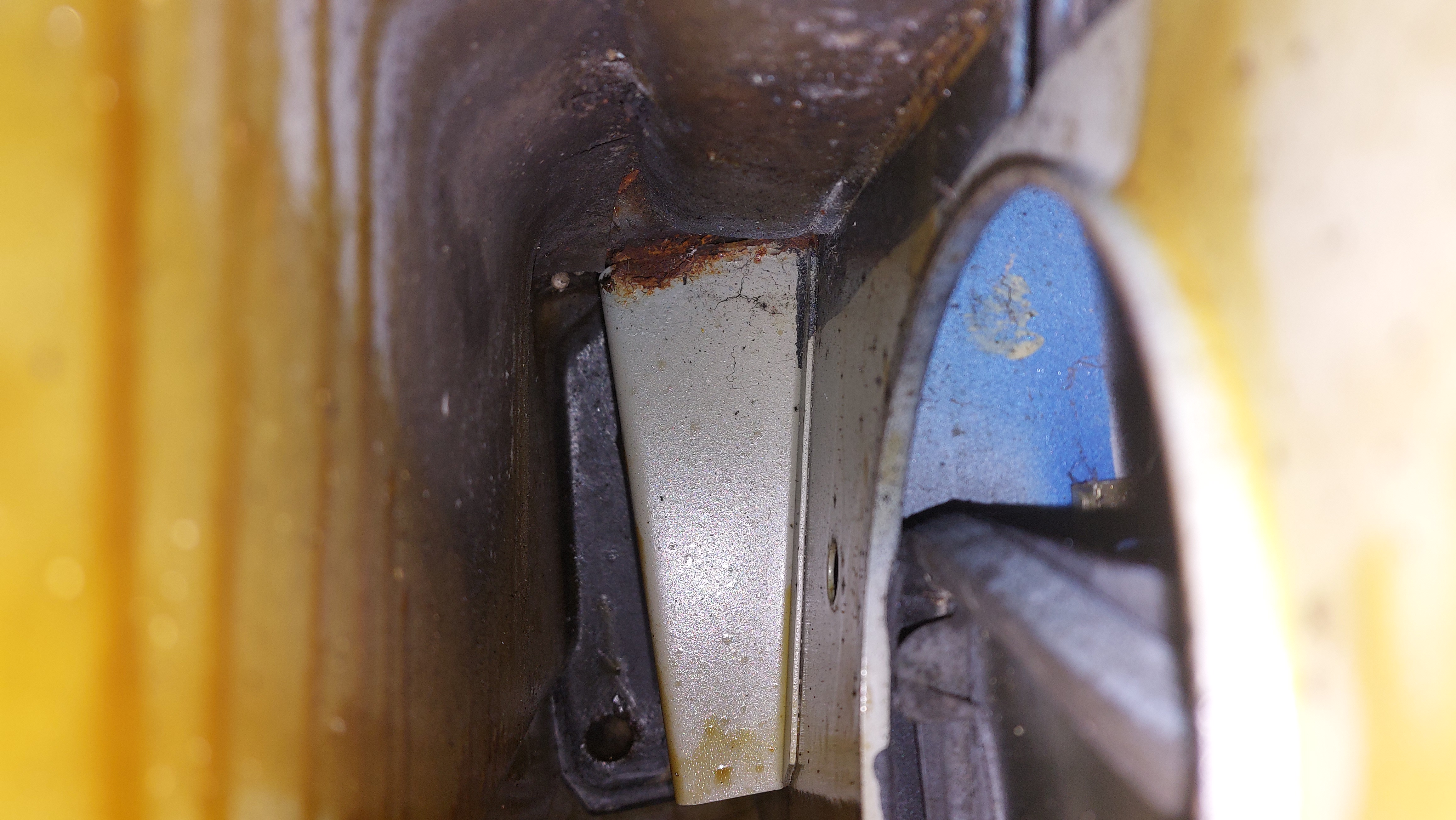

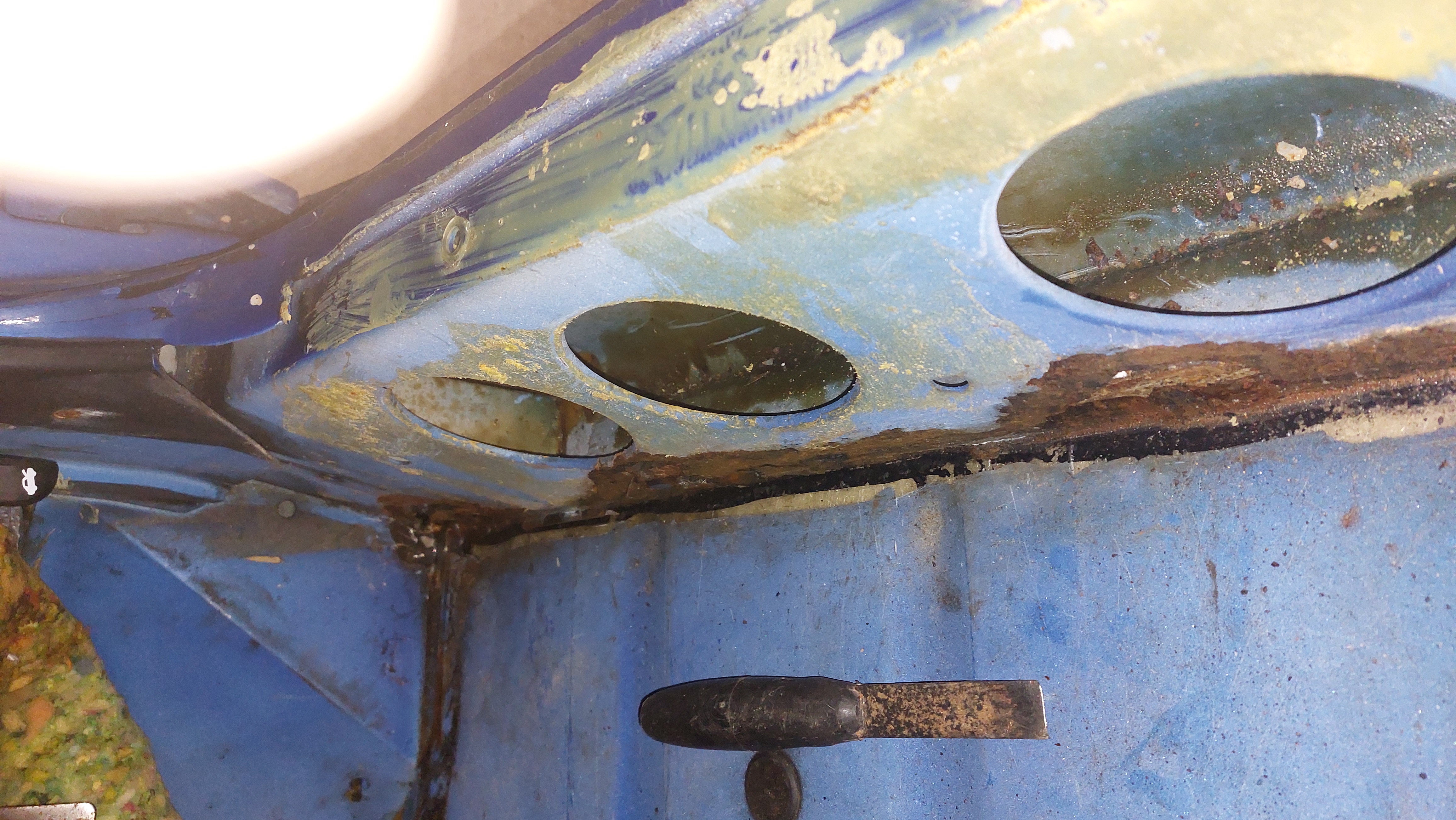

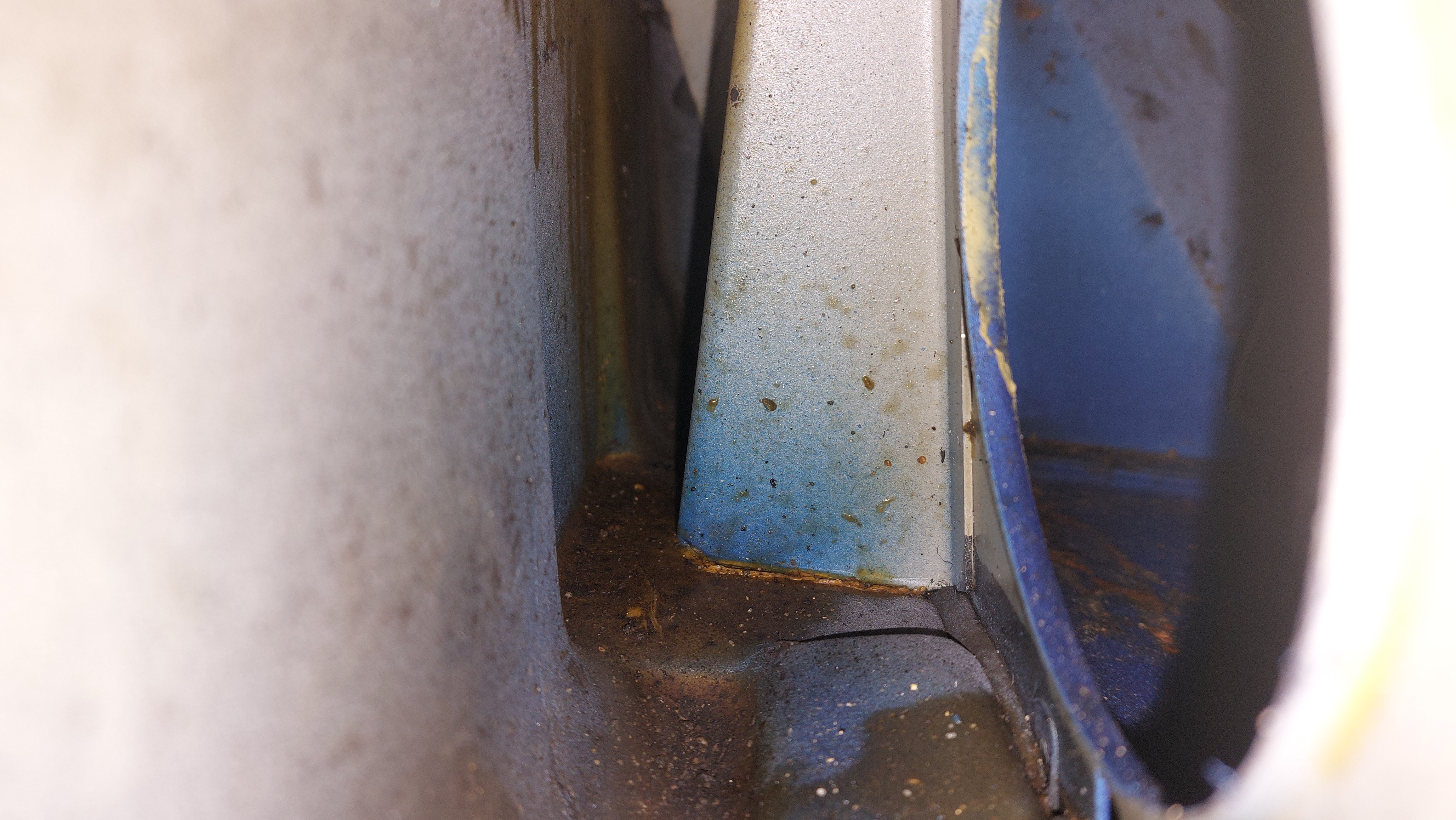

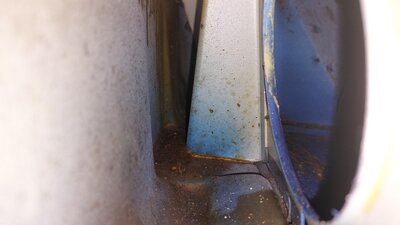

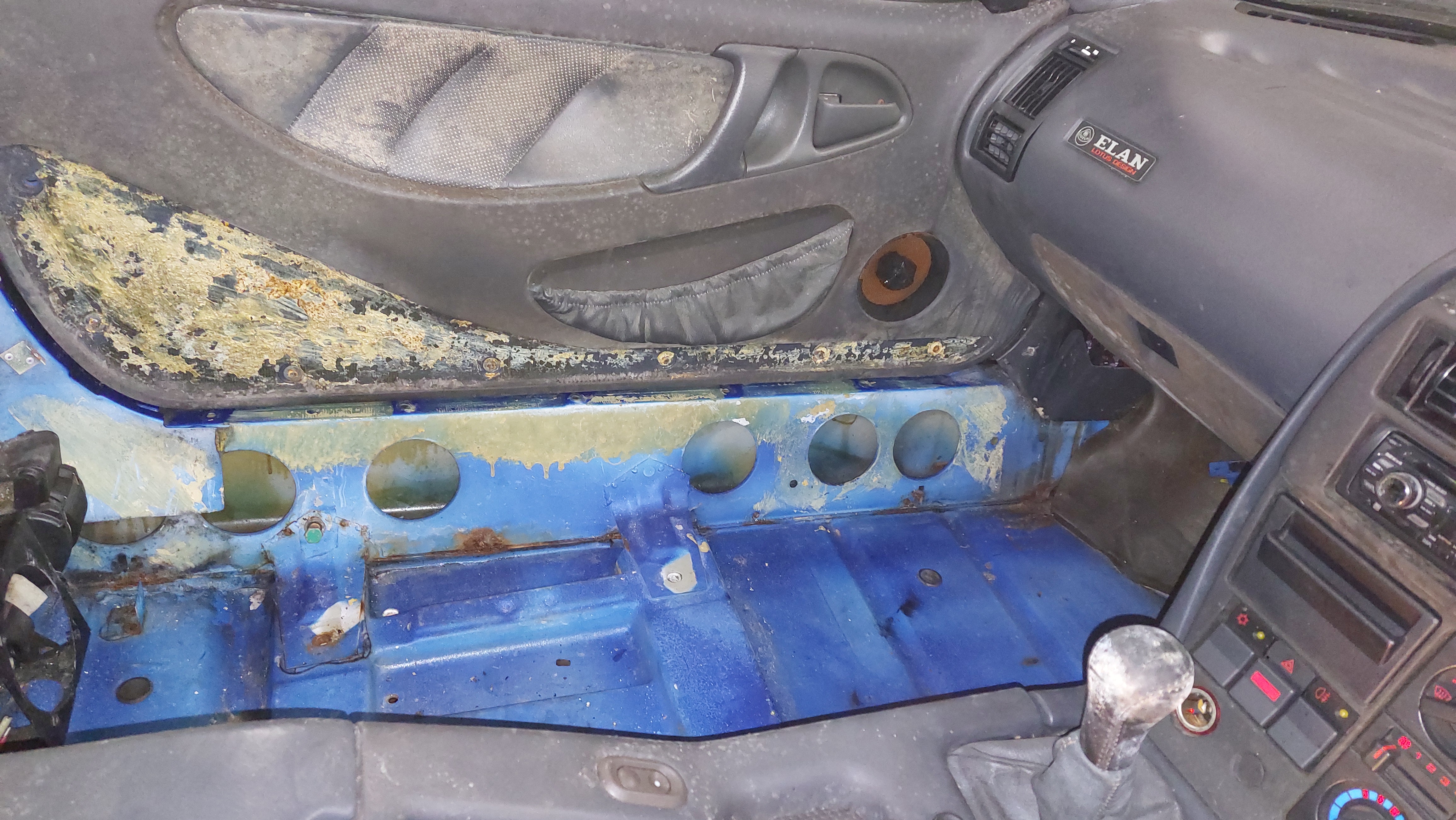

Okay then, here's the extent of the work required in the sills....
I think even you could have coped with the "devastation" I found - Passenger side just needs a clean, brush on some rust killer and squirt of Waxoyl - drivers side could do with a thin strip cutting off the bottom and a new bit welding in - I shall do it, but it would survive without - just a good clean, prep and treat/paint (with a new bead of Pu Adhesive).....
..... all 4 jacking points pretty perfect (the bolts all came out easily for a squirt of waxoyl inside the closed box).
I have to say, as "project" cars go, this one is far better than many we see out on the roads - but it will all get a good going-over before it gets handed over to the good lady (otherwise I'll only have to do it anyway at an inconvenient time).
Posts: 10621

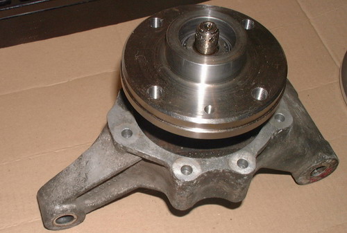

The rear discs are available from either SJ's or PNM as a "remade" part, and this is what i have purchased. I have the separate hubs/discs on my car (only really got them because at the time new rear discs were stupid money) and will be seeing how easily (or not) the old hub units can be machined to take the Astra disc..... hopefully there will be enough material present to do the work and retain sufficient strength - but we'll see.

do i understand correctly that you are suggesting taking the rear hub/disc combination and machining out the disk in order to be able to use the hubs by themsels and effectively separating the 2 parts ?

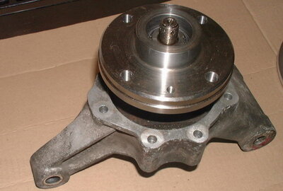

I think it was a group buy initiative around 2009.
A bespoke hub was made that you could attach a cheaper GM (Astra?) disc to. New hub + disc were only a bit less than the original set-up - but subsequent discs made the conversion extremely good v-f-m.
I think some benefitted but the system 'drowned' in numbers and stalled, amongst other difficulties, and the LEC page was locked. All in the past it seems...
(I'm wondering, if dealers can remanufacture the originals then why can't this upgrade be done too? Hmm...I wonder if Olds Cutlass discs are the same? Just looked; could be, but looking at the pics not sure about hubs...)

Postby dapinky » Tue 24.01.2023, 22:04
The first batch was designed and made by Bobbin Rastard himself (Bob Brown) - I got a pair from that run, and they are fitted to my car with Astra discs (DSK117 is the Apec part number).
After that, Jeemy made a batch, and they were all sold by him, with nowt to do with LEC (apart from him advertising on here) through his company.... all was well..... but it didn't last :?
He took orders for a second batch, and people paid a deposit.... then it got hit by delays and was all about to go belly-up with him not answering calls, emails or letters.....
.... then he managed to get some units sent out to those who had paid - BUT there was something like a 40% failure rate where they hadn't been machined properly, and the bearings were far too loose (falling out!) - the whole thing was at the same time he was taking orders for a lot of non-existent parts before disappearing with wads of cash......
That said, the drawings still exist for the hubs (as per the first batch made), so getting some made is always an option.
But, my though is that it may be passible to remove material from the OE hubs to end up with something akin to the Bob Brown design, that an Astra disc will fit one. I haven't examined the units enough to see if there is enough metal to do it and still leave enough thread for the wheel bolts to do up correctly, or the bearings remaining held intact..... as I say, a job for another time.

dapinky wrote:But, my though is that it may be passible to remove material from the OE hubs to end up with something akin to the Bob Brown design, that an Astra disc will fit one. I haven't examined the units enough to see if there is enough metal to do it and still leave enough thread for the wheel bolts to do up correctly, or the bearings remaining held intact..... as I say, a job for another time.
a big metal lathe would be all you need... now finding a person with one and the spare time.... ? :roll:

Postby dapinky » Wed 25.01.2023, 11:21
Tuga2112 wrote:a big metal lathe would be all you need... now finding a person with one and the spare time.... ? :roll:
It's been many years since I last worked a lathe - but it isn't that hard to operate, and the work doesn't need to be as accurate as for many other things...... just need to find one which is available.
