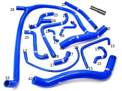

As for the cooling hoses, I just bought a set of Samco silicone hoses as most that you can buy from anywhere are part of the original manufacturing run, so have been sitting in storage for 30+ years anyway. If you go that way, I have a list of all jubilee clip sizes that you need for them..... and it is always worth throwing away the heater valve and replacing it with a part from a Volvo 740. It is a straight swap, but uses a plastic body so will never rust....... https://www.aliexpress.com/i/1005003431391024.html

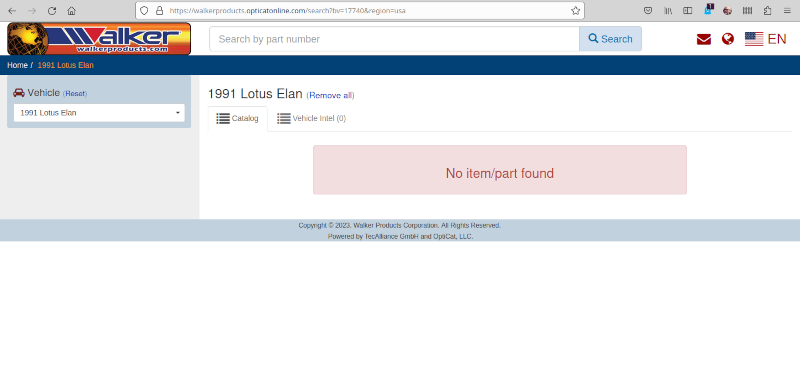

dapinky wrote:I ought to mention that although I got my newest set of HT leads (plug wires!) from Ebay UK, for you, Kingsborne Wires are a great product that I have on my other car as Doug (Tigerdog) did a group buy 15 years ago and bought a huge bag of them to Hethel for the Lotus 60th! IIRC they do a bit of a discount for LEC members, so it is best to call them rather than order online.
Looks like Kingsborne was acquired by Walker products earlier this year. https://www.walkerproducts.com/2023/05/ ... ire-werks/ Looks like they've dropped fitment for the Elan (for all Lotus products, actually.) I downloaded and double checked the ignition products catalog; jumps straight from Lincoln to Maserati. What a bummer!
