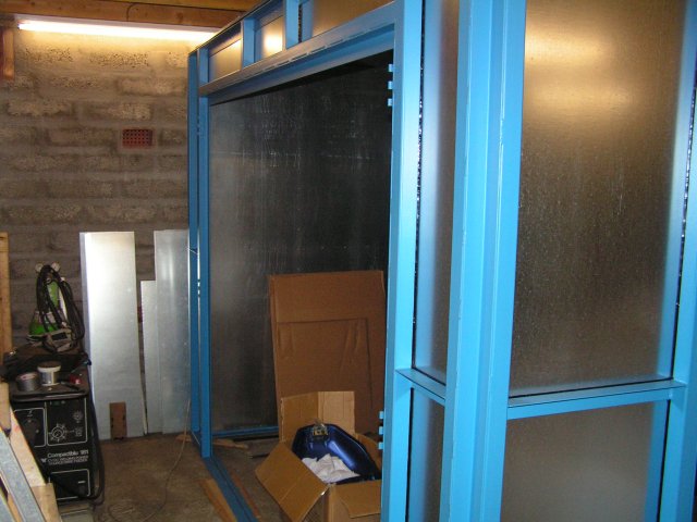

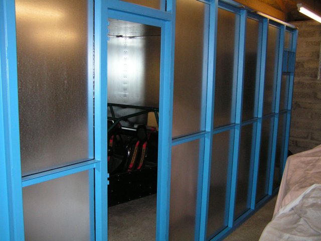

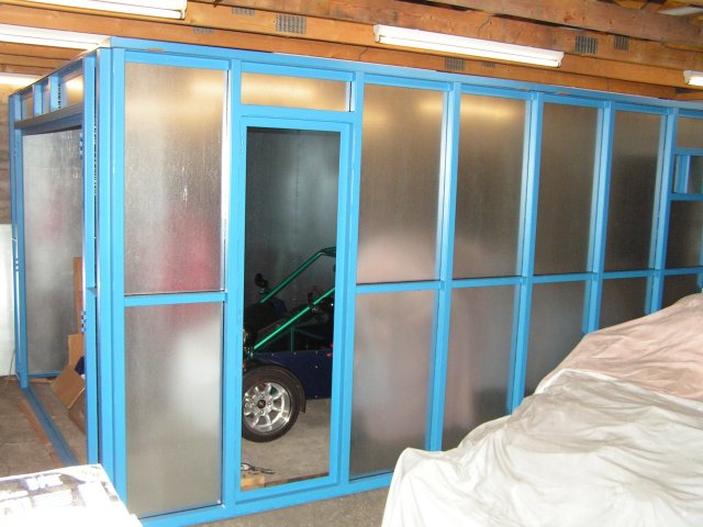

Well 5 months and 3.5 tons of steel later the booth still is not finished :shock:
I have to say I'm surprised with the time its run away with, but it is taking shape.
Still got to finally position it in the corner of the garage but before I can do that I have to seal where the roof meets the walls and insulate the whole thing with kingspan oh yes and make the large doors at the front which will house the extraction unit. Already have a good centrifugal fan sorted for the heated inlet but still got to make a housing for the inlet filtration.
Booth enviroment will be controlled by a dual photohelic switch/gauge controlling inlet and exhaust fans to maintain negative pressure within the booth.
Hell of a lot of hassle just to finish off my Elan, but I've already earmarked other things requiring painting !
Here's some pics of the progress so far....

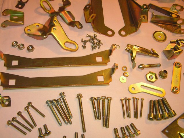

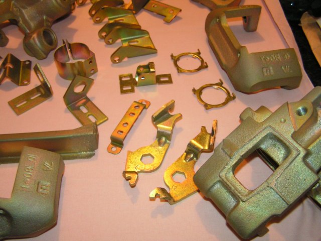

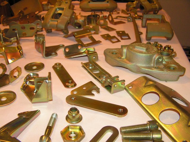

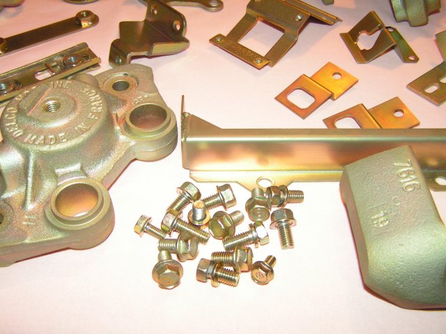

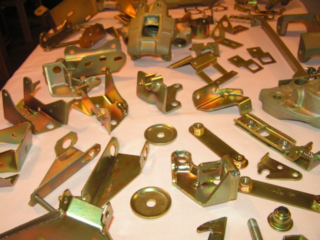

I found a good electroplaters only 150 miles from me :shock:
I have had a mountain of bits re plated to original spec (zinc and yellow passivate) most of which turned out really well.
I say most because my bonnet stay and 4 brake bleed nipples started to dissolve, a small number of fatalities for the return !
The finish your going to recieve varies on the amount of corrosion the part had originally, also if the part has to be blasted this will take some of the sheen from the part although the finish on pressed steel parts seems outstanding - like they just came out the factory
One thing I will say, for the optimum finish I would reccomend brake calipers are blast cleaned (aluminium oxide or fine glass beads) prior to sending off as you will be able to spend more time on them as one or two nooks and crannies may be missed, that said my calipers were pretty good when I got them back.
On the whole I would say it has been a very worthwhile excercise, bearing in mind all these parts only cost £40 (minimum order) to get done and were turned around in little over a week !
Their name A.D. Platers Ltd Arbroath 01241 871562 Ask for Andrew Duncan

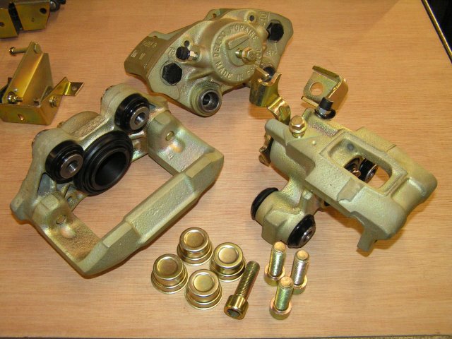

Spent the last few nights rebuilding the calipers since I had them re-plated, the rears were fun but made a lot easier with Bob's piston tool (cheers Andy). I could have gone out and bought reconditoned calipers or even new but way more satisfying doing the whole job from start to finish yourself, at least you know everythings is spotless and I even gave the piston and sliding pin bores a polish with a honer!
I've decided to go down the route of stainless hoses after much debating to stay original for concourse, since there are many advantages to not rear ending someone ! At least the ends will stay nice and shiny. :D
