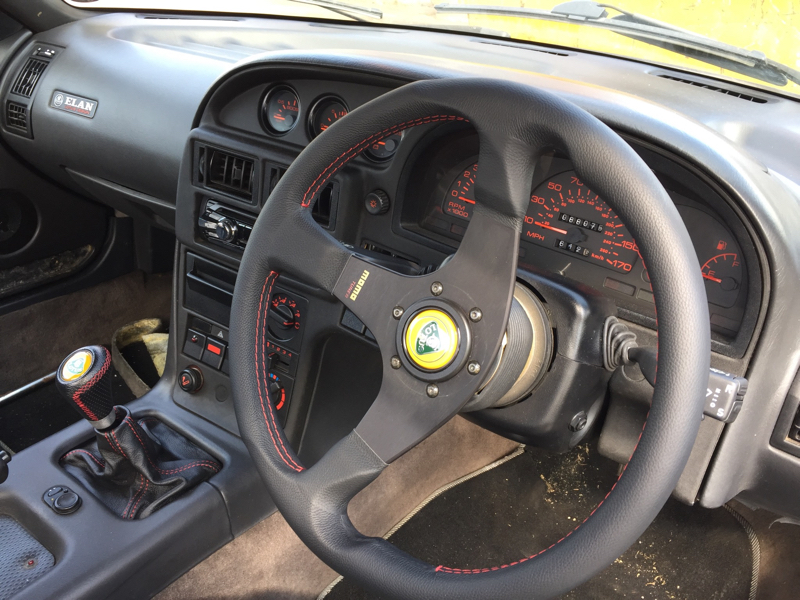

Postby maz_r » Sun 03.04.2016, 15:01
Just a quick note on recent works, for the record.
New steering wheel duly fitted; Momo chosen mainly (and I apologise in advance for this) 'cos it had red stitching :shock:
I kept the original boss and used one of these to adapt from the nardi fitting on the boss to the momo pattern; simple enough. Took 2 attempts to find a decent horn push though...
Not got a great way to cover the existing boss in a tidy way yet, but I saw on here someone using a gaiter of some sort, which looks like a good idea.
Anyways, I like it :)

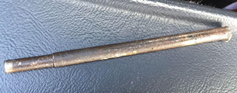

Also, as previously mentioned, i have trouble getting heat into the brakes so decided to replace the pads. Spoke to PNM who said that their standard pads were probably best; duly ordered. Simple fit, thinks I. How wrong can one be! Can I get the retaining pins out? On no. Phone call to PNM just to confirm I'm not doing something stupid, but no, what you are doing is correct, they say; hmmmmm. After much whacking with a hammer, I got one pin out, but the other won't shift at all. Better let some professionals to have a look.
Yesterday the car went into the garage and they have done the necessary, although their phone call to say it was finished included several expletives!
What it should look like....
And here is why:
What the garage had to do
Some stainless replacements were ordered and fitted (and seriously greased!). After all that, the braking seems better but still in the bedding in phase, so not up to maximum efficiency just yet.

Postby muley » Sun 03.04.2016, 19:47
I thought those pins might create a problem. I liberally dosed them with copper grease, but not enough it seems,

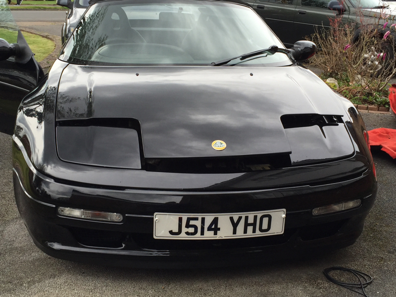

Sun is out, the sky is blue (or was before it threatened to rain)....
So many jobs planned, so little time. and of course, 'cos it is me, everything takes 20 times longer than it seems to for everyone else. Whenever someone says '5 minute job' on here, I have to mentally think '2 hour job...' (OK - so that is 24 times longer, but you get the drift.)
Firstly, I was going to have a go at fitting the red red carpets; as some of you know, I have been collecting red carpet pieces (and thank you for your donations to the cause - you know who you are!), so the question is which pieces do i use...?
To which the answer of course is none, since i decided to do a few quick cosmetic jobs first :( Three hours later...
...I did mange to fit a couple of the upgrades I've got hold of over the last few weeks. Spot the difference: first mod fitted
First mod fitted
Second mod fitted:
second mod fitted

Postby HJ2 » Sun 10.04.2016, 16:50
M'c Laren mod & clear indicators :D
Re: YHO chronicles
Postby lotusflasherman » Sun 10.04.2016, 17:03
:wtf: what's that shoulder doing there? Is that a headed pin retained with a clevis pin or a rollpin?
All the rollpins I've ever seen are parallel so you can tap them in from outside and to remove just keep them going through. Those require getting on the inside of the hub and drifting them outwards. What a silly idea.
Mods - somebody stole a wiper arm and clear indicators. :lol:
Have you got clear side repeaters too? Got mine from ebay for 'peanuts' - buy Mini fitment are they are an easy swap. (That's a proper Mini, not the obese BMW thing.)
Re: YHO chronicles
Postby maz_r » Sun 10.04.2016, 17:22
Correct on both counts.
Clear front indicators, courtesy of Richard (wolfie308 on here). If any one else is interested, he has a couple of extra sets on the shelf. Website here.
I put black side repeaters on a while back; off fleabay, as you say.
Single wiper conversion from Jamie N - thanks mate. I went for the 'normal' mounting rather than the race-a-like vertical - just a personal choice.
Those pins are held in by some 'R' clips; the shoulder is on the outside and they are supposed to be removed by drifting them inwards...unless they've been fitted for a while.
